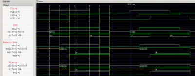

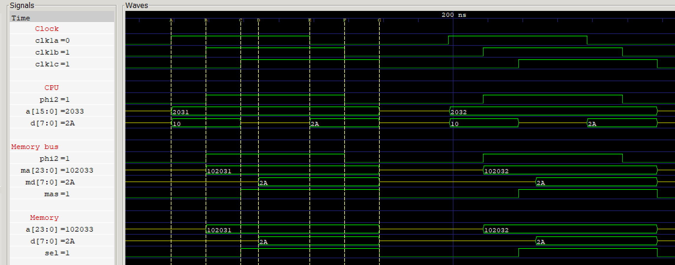

Let's have a look to the following timing diagram:
In the top block we have the three clock signals shifted 10ns each other. Please note I am using 12Mhz frecuency here, although we will use the 14Mhz AC requirements. After clocks, we have the relevant CPU signals, the memory bus signals and the SRAM chip.
I used the following time marks to point out significant events:
  • A: PHI2 raise edge. This is the strobe signal for address and bank address. The memory controller latches the bank address in a register. And MA (Memory Address) is driven with the 24 bits of the address obtained from A and D.
  • B: 10ns after PHI2 raise edge. The MAS (Memory Address Strobe) signal is asserted. This will be used by the selected SRAM chip to read (specific chip selection by address range is not included in the diagram).
  • C: the SRAM chip responds to the read and drives the memory data bus. This is not the same bus as the CPU data bus. They are separated. Thanks to this, we are not in risk of bus contention at this point. The SRAM chip can be as fast as possible. An access time of 0 would be acceptable.
  • D: 10ns before PHI2 fall edge. The memory controller activates the buffer that drives the CPU data bus from the Memory data bus. This causes the data read from the memory to be accessible by the CPU. Please note this is 10ns before the CPU reads the byte. It is almost impossible that it is still driving the bus for BA.
  • E: PHI2 fall edge. The CPU reads the data from its data bus.
  • F: 10ns after PHI2 fall edge. The memory controller stops driving the CPU data bus and it deactivates the MAS signal. Please note this is 10ns after CPU reads the byte. It is almost impossible that it is writing BA for the next access so soon.
So yes, the circuit is more complicated. Not much for a CPLD. But thanks to this we can be confident the memory will not cause bus contention, even if it has an access time of zero.
How does it look?

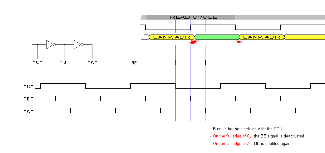

apoloval wrote:

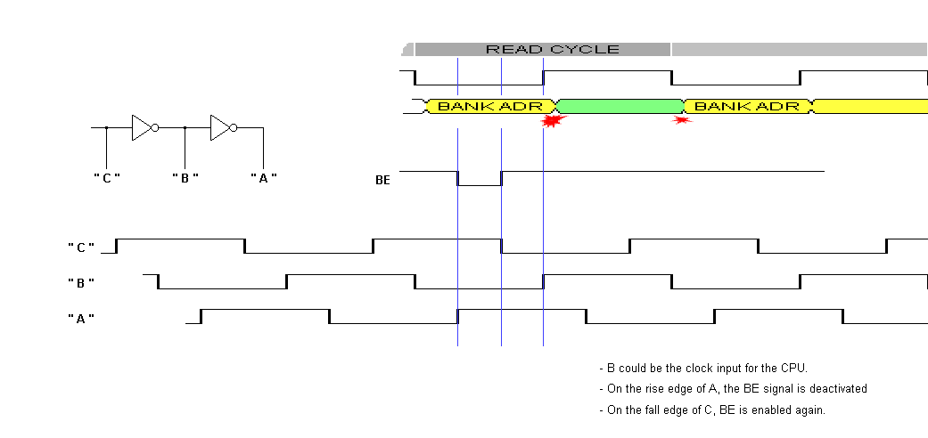

Yep, my fault. I said RDY, but I meant BE (Bus Enable).
Ummmm.. is it possible you subsequently made another mistake expressing yourself? I think I know what you mean, but it seems to differ from what you said. :|
Here is a portion of the diagram I included in the lead post. I added some stuff pertaining to your suggestion, and the notations at the bottom are direct quotes taken from your post. As I write this I see you have posted again, but I'll finish what I was saying for the sake of anyone else who (like me) was confused.
'816 bus activity 01.png (6.62 KiB) Viewed 5174 times

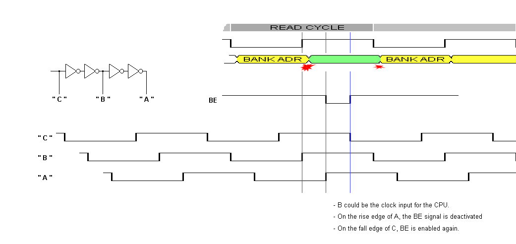

That makes no sense to me (look what BE is doing), so I wondered if you had two inverters separating the A, B and C clock signals. But that makes no sense either:
'816 bus activity 02.png (6.72 KiB) Viewed 5174 times
Here (below) is what I think you meant. And it results in BE dropping low briefly during one of the hazard points. I like the idea, but it has some challenges. Also, it offers no remedy for the other hazard point .
'816 bus activity 04.png (6.74 KiB) Viewed 5174 times
I look forward to reading your latest post. For bonus points, it'd be nice if it takes account of the fact that the data bus has to be passed both back and forth, so to speak. In other words, there are two "sticky wickets" in the transaction.

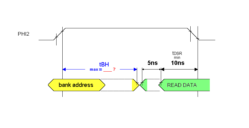

I'll begin by reviewing the second half of the cycle. This is the handoff from the CPU to the buffer. The buffer (which will be delivering read data) remains disabled until...
  • D: 10ns before PHI2 fall edge. The memory controller activates the buffer that drives the CPU data bus from the Memory data bus. [...]
Alright, that makes sense, but what allows you to drive the data bus at exactly the time you mention? In real life, the buffer takes some inexactly known amount of time to begin driving. Rather than giving an exact figure, the datasheet for the buffer states the minimum and maximum enable time (the time from when the buffer is told to begin driving until it actually does so).
For ease of discussion, let's say the buffer-enable delay is listed as min 0 to max 5 ns. And in the diagram below, tDSR from the '816 datasheet tells us the deadline by which the read data needs to be valid -- there needs to be at least 10 ns of setup time before Phi2 falls. Assuming, as I said, between zero and 5 ns of buffer-enable delay, that means for reliable operation the buffer needs to be told to enable 15 ns before Phi2 falls.
Trouble is, we have no explicit assurance the CPU will have stopped driving by then. :(
handoff from the CPU to the transceiver
65816 timing01.png (6.44 KiB) Viewed 5082 times
Because we know how long the Phi2-high pulse lasts, all it takes is some simple math to reveal what's the largest tBH figure we can tolerate. But the '816 datasheet fails to specify a max figure for tBH; only a min figure appears. As far as I can tell, the omission of a max tBH figure scuttles any attempt at a rigorous solution for avoiding contention. WDC's omission forces us to use seat of the pants solutions rather than real engineering. :!:
( I can think of factors that lessen the bad news about contention, and I can think of factors that make it worse. But for the moment let me stay on focus. And to be clear: I'm not saying seat of the pants solutions are ineffective -- I'm just saying we shouldn't be forced to work that way. )

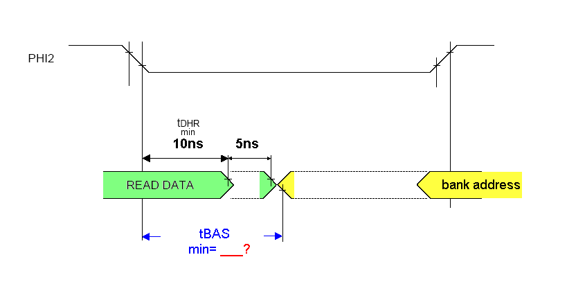

Now here's the other handoff, this one from the buffer to the CPU. It's a similar situation, unfortunately.
handoff from the transceiver to the CPU
65816 timing02.png (6.2 KiB) Viewed 5082 times
The '816 datasheet tells us data on the bus must remain valid for at least 10 ns after the fall of Phi2 -- this is tDHR -- and let's assume the buffer has a 0 to 5 ns disable delay. If the buffer is told to disable 10 ns after the fall of Phi2 then in total it may drive as late as 15 ns past the fall of Phi2.
Now we have a figure (15 ns) for the smallest tBAS figure we can tolerate before a collision occurs. We don't want the Bank Address to appear too soon. But the '816 datasheet doesn't offer any warning or reassurance about the possibility of tBAS being smaller than 15 ns. No min figure for tBAS is specified; only a max figure is provided!! :roll:
I think we all realize bus capacitance can usually be relied upon to maintain the state of the bus for a short time, and thus the command to disable the buffer needn't be as late as I suggested (ie, it can be earlier than 10 ns after the fall of Phi2). But you mustn't disable it too early or it'll fail to establish valid levels in the first place.
Instead I wish WDC had simply provided a min figure for tBAS and a max figure for tBH as they ought to have done -- that's what I'm mainly saying.
