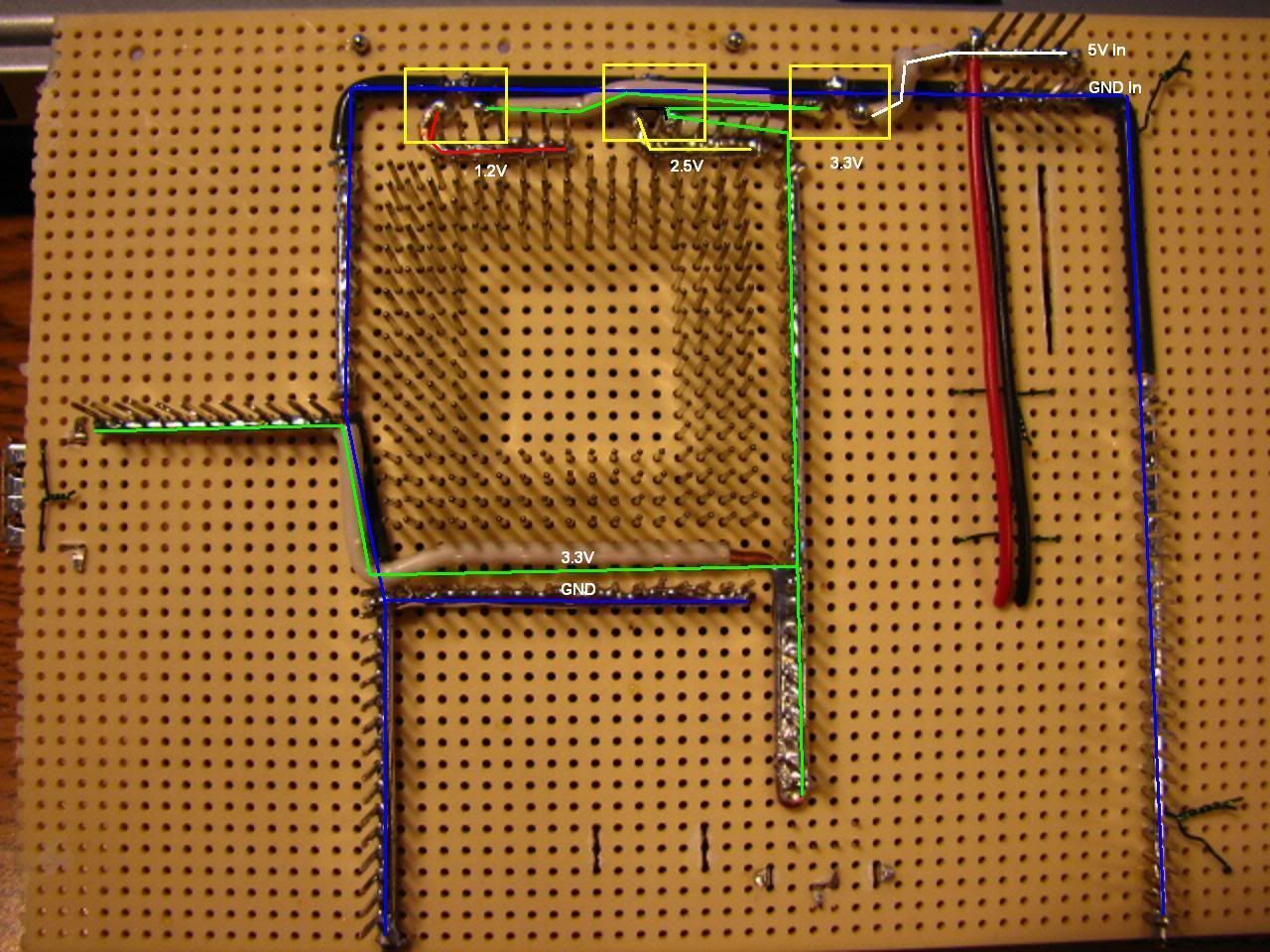

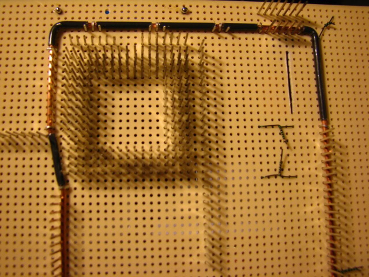

One step closer to wirewrap....
The 3 30-pin connector's to the right of the ground plane (next to the 144-pin QFP adapter) will be replaced with 40-pin connectors as mentioned before (I just used them for spacing since I had them on hand, the 144-pin QFP is being used as a spacer too).
This is the first power "plane" in this wire wrap project. It is the ground plane. Mechanically, and soon to be electrically sound (soldered). Noise will be a very limited variable!.
All power planes will be connected with seamless 14AWG solid copper wire. The only IC shown is the XC3S400... (The 208-pin adapter is difficult to place into the perf-board, so I didn't try to remove it). I'm also looking into thicker wirewrap wire for power connections, currently using 30AWG for signalling.

I finished the Power/GND planes today...
EDIT 2/9/11: Added GND plane below FPGA.
Rewired 1.2VReg for 3.3VIn instead of 2.5VIn

The 14AWG wires act like power/GND planes. I will tap into them when I wire in the power connections to the FPGA. Then add the bypass cap's...
I realize all this wirewrapping invites an inductive challenge and will limit top speed, but if I can achieve at least a working prototype then I will have a foundation from which to work from when it's time to design a professional 4 layer board.

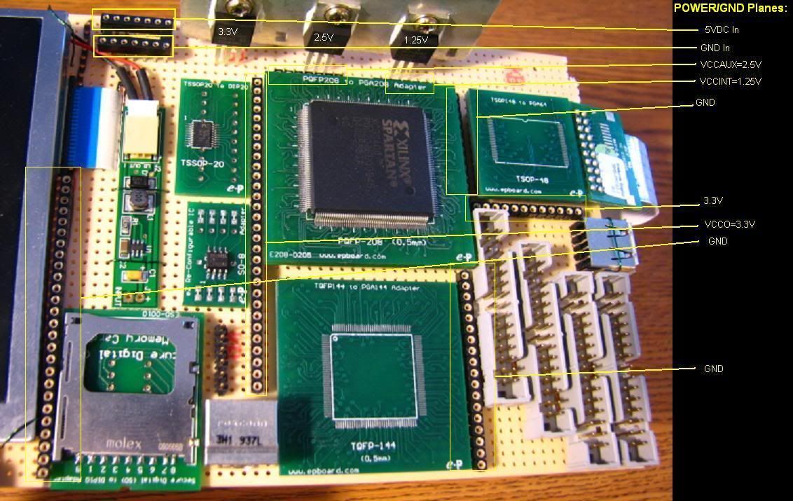

Thanks for pointing out those articles Garth (I've bookmarked his site, lots of good info in there!), especially the wire-wrap question! Good to see I am not the only one using wirewrap for prototyping. Dr. Johnson theorized a top speed of 33MHz, but I'm sure that was for a complicated system. I've run 16-bit counters inside a spartan 2 @80MHz in the PWA successfully. I paid close attention to bypassing all power pins, but I used a similar but more primitive approach to using power/ground "planes" with 24AWG. They were for a MUCH smaller 100-pin QFP package though...
The idea behind the power bars (I'll call them "bars" from now on since they are not technically planes), is to be able to tap a voltage from a single point. The thicker the wire, the closer you come to that single point, though it may be 5 inches away from the source. With so many power pins and grounds coming out of that beautiful 208-pin monstrosity, not to mention the bypass caps I'll have to wire in, I used the thickest AWG I could get my hands on!
After doing some reading on DCM's (yes I'm only up to Chap 3) in the Spartan 3 User Guide, I realized I am doing a no-no by cascading the voltage regulators (Pg.148). It mentions that if this situation is unavoidable, then every VCCAUX must be bypassed which I was intending to do anyway.
I looked at a schematic for a Spartan 3 starter board from Digilent. They have the VCCO regulator feeding both VCCAUX and VCCINT regulators. I have changed my wiring to be the same.
Also, I have added one more ground bar underneath the Spartan 3. The 144-pin QFP adapter is right on the bottom edge, but it still fits! I'll edit the last pic soon, as now there are 2 major finalizations.
Today and tomorrow I am off from work, my little hands will be busy! Now thinking about it (typing helps me think clearer), I should wire the power and grounds, then wire in JTAG and see if ISE recognizes the FPGA, before I wire all the bypass cap's. This will give me confidence and potentially save alot of rewiring in case I get double vision and wire a wrong pin. All those cap's are gonna get messy.
