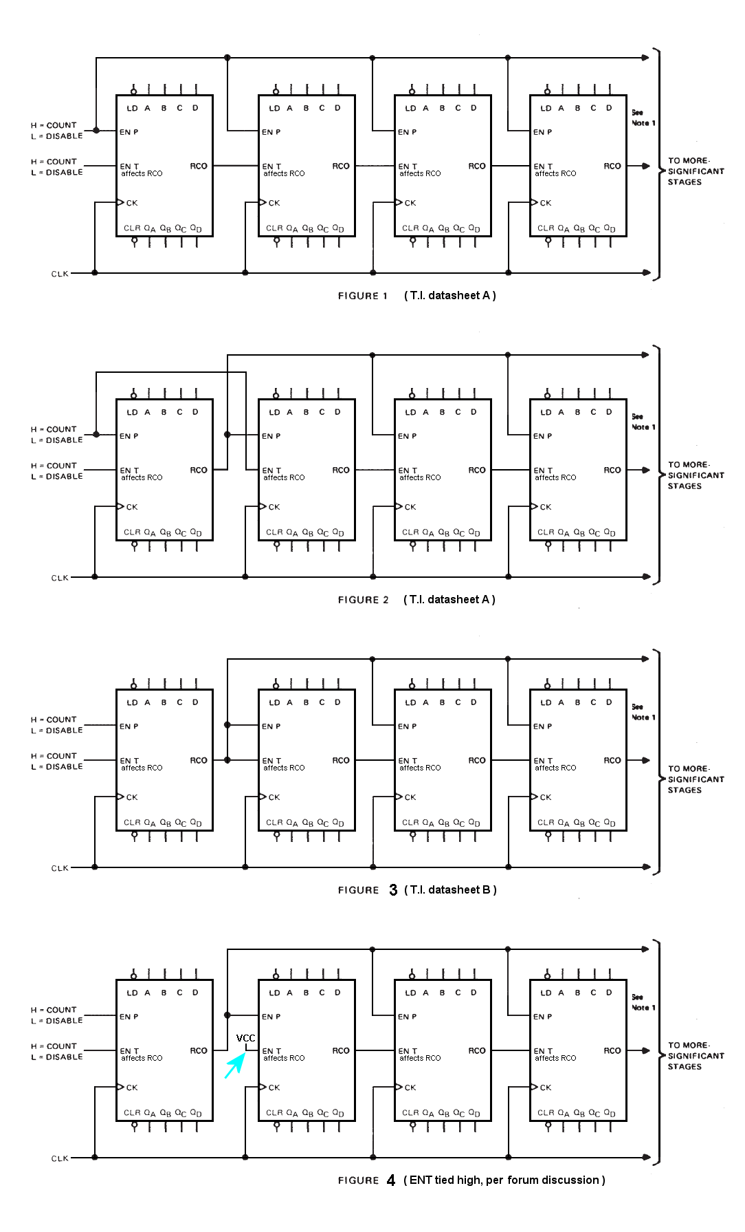

Folks, I have a bit of followup regarding what we were saying upthread about cascading '163 counters. For comparison purposes, in the image below I've included Figure 1 and Figure 2 from TI, even though I already presented them in this post.
The vesion I've called Figure 3 is a lookahead scheme taken from a different TI datasheet. I don't know why this lookahead scheme doesn't match the one they recommended in Figure 2. Figure 2 is more recent, but neither version seems convincingly right. Figure 4 illustrates a suggestion of George's which we'll get to in a moment. In case anyone's in doubt, I'm appending a peek into a single chip's internal logic. The highlighted path illustrates how each chip can form a single link in a chain. I'm sure that's what you mean, George, when you mentioned a ripple carry effect in this post...
I agree when you say...
gfoot wrote:
the first IC in the chain will update its RCO (as labelled in the diagram - I think it's called TC in newer datasheets) based on whether its new value is an "F". This passes to the "ENT" pin of the next counter in line, permitting it to tick next time, and also permitting it to output its own RCO state. So if that next one is also "F", it passes that along, and you have the same kind of ripple carry effect
[...] trying to enable/disable counting for the whole chain by changing the state of [the second counter's ENT input] would lead to another ripple effect. It feels like you should just connect this high all the time
Re: VGA and Dual Port RAM
Figure 3 looks as bad as figure 1 to me - it would have a limited frequency based on chain length, which figure 2 doesn't suffer from as much.
In Figure 4 I think the first counter's ENP also needs to be held high, it's not going to work otherwise.

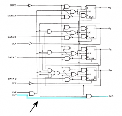

I think there still an issue with very long chains that I'm not sure how to solve though, which is that if the first counter ticks sixteen times before the carry has propagated through all the other counters then they could count wrongly (I think they'd actually count too low, but it's making my head spin trying to think it through!)

Maybe I'm stating the obvious, but we mustn't be falsely reassured by the fact that the repetition rate for this event is fairly sedate -- 1/16th of the clock rate. We still need a brisk response. That $E, $F, 0 sequence strictly demands that the other counters be disabled, enabled, then disabled (respectively) on three successive clock edges. That needs to happen in a tidy fashion or there'll be trouble.
Now the bottom counter's RCO goes inactive, as it's no longer an F digit, so the higher order counters are disabled via ENP. Meanwhile, the second counter's RCO goes active, as it is an F now, enabling the third's ENT, and step by step this ripples through as these digits were already Fs.
The issue I see is that with a long chain, maybe it's possible to tick the clock another fifteen times before the ripple is complete; then the low order counter would get back to F again, enabling the higher order counters' ENPs, but if the carry hasn't propagated yet, they will not all actually count up on the next clock, and the resulting number will be too low (e.g. $00FF00000000 instead of $010000000000).
It might take a ridiculously long chain though for that to be a problem. I guess the solution would be to split the chain at some points and add your own carry look-ahead NAND gates external to the ICs, similar to those in the internal diagram you posted before.

Jeff, according to your Figure 3 and Figure 4 diagrams, I'm basically using Figure 4. I'm tying those ENP and ENT lines on the first counter high always, thus the ENT of second counter as well, as per our original Figure 2 discussion. So in a way I'm following your Figure 4 as well!
I don't know why I (personally) would ever bring the first counter's ENP or ENT lines low, I don't have any use for disabling the counters in this particular application. But again, this is an interesting situation and I like the discussion a lot. I'm learning, so continue on or whatever it is, and I'll be soaking it all in.

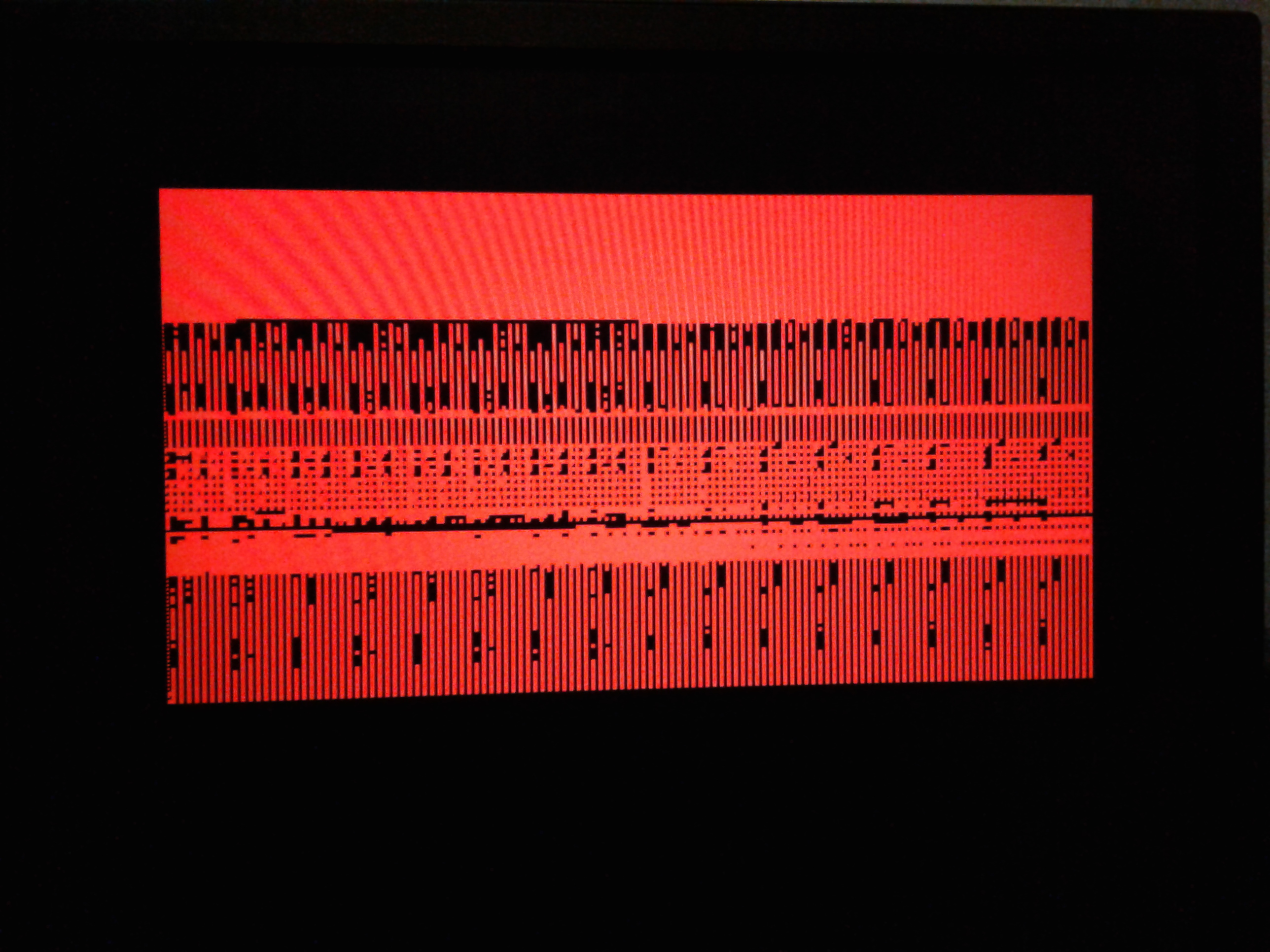

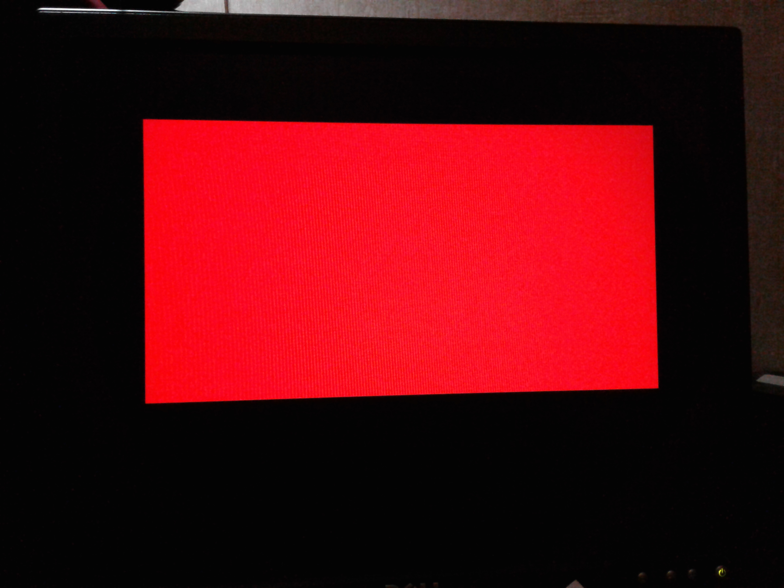

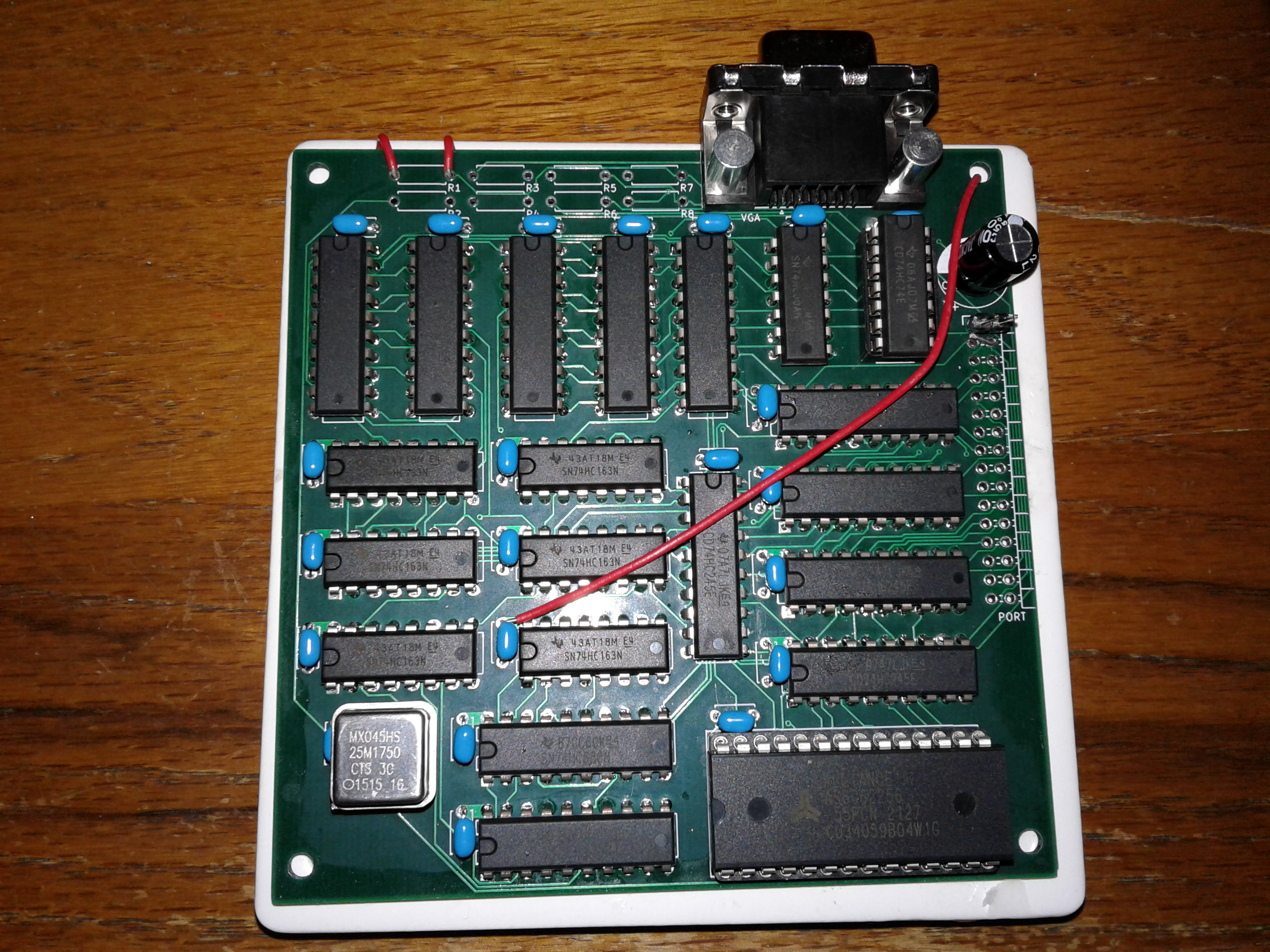

Update!
As with every project, some good news and some bad.
Good:
The monitor recognizes the signal perfectly, and displays something! This is the "sync" board, which I panned to the center of the screen. And it is working exactly as expected in that regard. Awesome!
Also to note, I am using H799 and V524 for reset values instead of H800 and V525, and it seem to work great. I'm doing this because it's the sync board, and it needs to reset on the next clock tick, not immediately/async. Just for future info.
Bad:

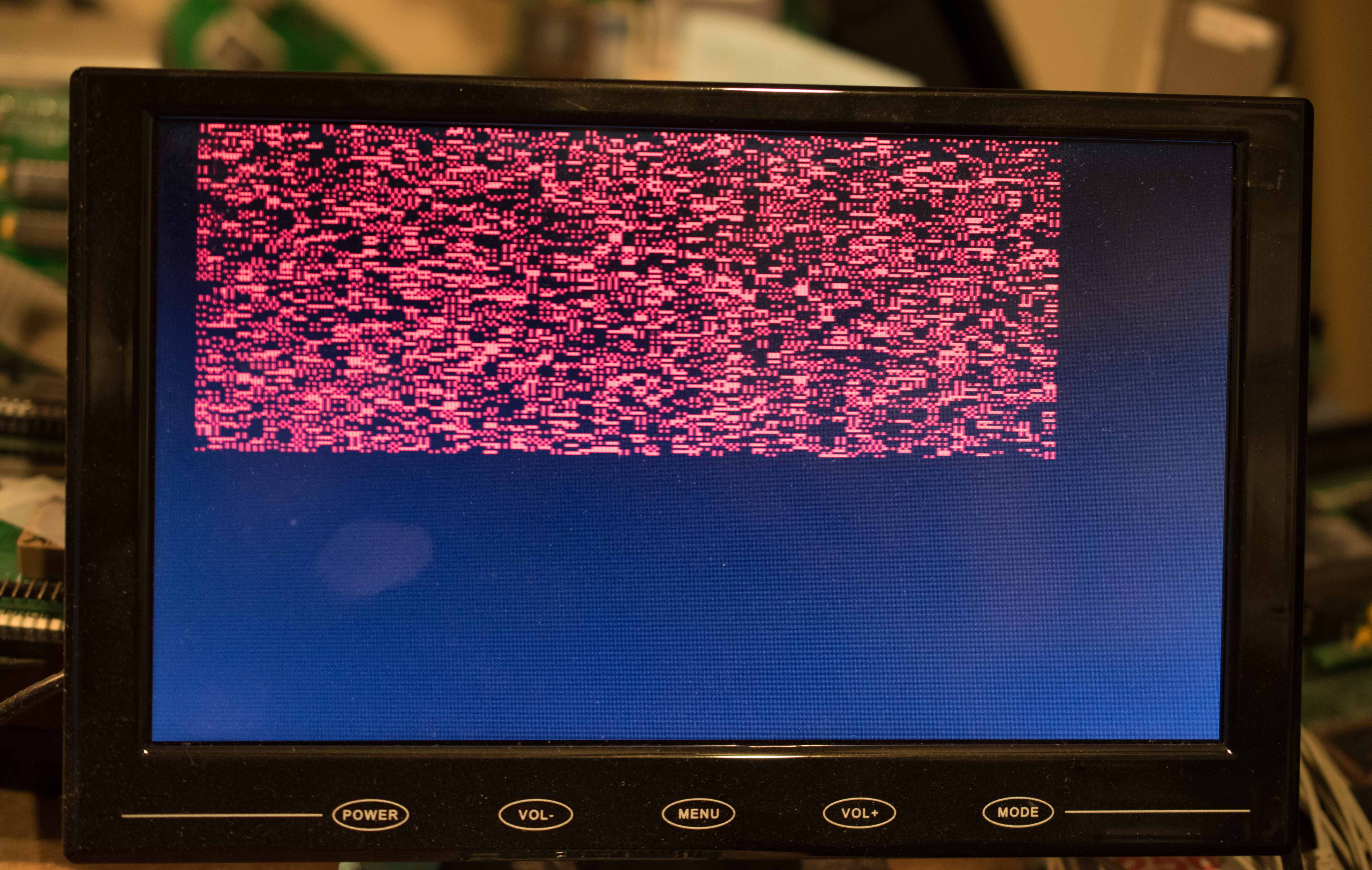

The RAM is being written to somehow. The screen stays static and stable for a bit, then it starts replacing pixels slowly, then faster, then it's all red. THEN it turns black all at once.
This not 'snow'. Not like a TV without signal. It's just kind of random?
I suspect this is because I don't have a computer plugged in to it to regulate the input lines. When I rake my finger on the RAM pins I get all kinds of changes. They stay for a bit (sometimes) and then they disappear eventually. I tried running a temporary line to keep /WE high, but that doesn't seem to work great (that's the red wire you see in the pic).
I'll be checking things with the scope now. BUT at least it's a panned image and is actually displaying stuff. Cool!
There's my update, thanks everyone! Would not have been possible without you!
Chad
EDIT:
Yep, when I tie /WE to a proper VCC, I can keep a stable image. When I release it, it's sporadic. Scope says /WE fluctuates some when disconnected, or at minimum it stays grounded which means it's constantly being written to (probably lots of zeros, thus the reason why it blacks out often).
Some things I've learned:
1) KiCad footprint for DSUB-15 connector was wrong, I had to bend pins to get it to fit!
2) I need more VCC and GND available on the board, especially GND so that I can easily plug in scope probes.
3) After soldering, don't rub your eyes! That was a chemical burn. [ My eye is fine btw. ]
sburrow wrote:
The RAM is being written to somehow...I suspect this is because I don't have a computer plugged in to it to regulate the input lines.
CMOS inputs should not be allowed to float!
