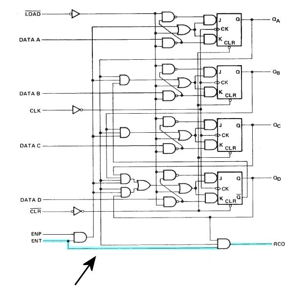

Folks, I have a bit of followup regarding what we were saying upthread about cascading '163 counters. For comparison purposes, in the image below I've included Figure 1 and Figure 2 from TI, even though I already presented them in this post.
The vesion I've called Figure 3 is a lookahead scheme taken from a different TI datasheet. I don't know why this lookahead scheme doesn't match the one they recommended in Figure 2. Figure 2 is more recent, but neither version seems convincingly right. Figure 4 illustrates a suggestion of George's which we'll get to in a moment.
In case anyone's in doubt, I'm appending a peek into a single chip's internal logic. The highlighted path illustrates how each chip can form a single link in a chain. I'm sure that's what you mean, George, when you mentioned a ripple carry effect in this post...
gfoot wrote:
the first IC in the chain will update its RCO (as labelled in the diagram - I think it's called TC in newer datasheets) based on whether its new value is an "F". This passes to the "ENT" pin of the next counter in line, permitting it to tick next time, and also permitting it to output its own RCO state. So if that next one is also "F", it passes that along, and you have the same kind of ripple carry effect
I agree when you say...
[...] trying to enable/disable counting for the whole chain by changing the state of [the second counter's ENT input] would lead to another ripple effect. It feels like you should just connect this high all the time
PostPosted: Sat Jan 01, 2022 11:24 pm
Posts: 741
Thanks Jeff, that makes sense.
Figure 3 looks as bad as figure 1 to me - it would have a limited frequency based on chain length, which figure 2 doesn't suffer from as much.
In Figure 4 I think the first counter's ENP also needs to be held high, it's not going to work otherwise.
Yes, that is what I meant - it's much clearer with your diagram, as if you trace this path through all the chained ICs you get a very long serial chain of gates and their propagation delays will add up.
I think there still an issue with very long chains that I'm not sure how to solve though, which is that if the first counter ticks sixteen times before the carry has propagated through all the other counters then they could count wrongly (I think they'd actually count too low, but it's making my head spin trying to think it through!)
PostPosted: Sun Jan 02, 2022 12:55 am
Posts: 3366
Well, yes... all of the TI diagrams (Fig 1, 2 and 3) have that common feature. Each version shows two inputs to the cascaded array, both labeled "H=Count, L=disable." (And that's how I drew Figure 4, too.) But I'm guessing that only in rare situations would someone need two such inputs. And when one is unused it'd get tied high.
It kinda makes my head spin, too, but you're making sense. It's an important point.
FWIW I'll share the following. (And really this is a different issue, though still pertinent.)
It's true as you said in a much earlier post that the low order counter is the only one that actually counts at the full frequency. The others have up to 16 ticks' worth of time to get the carry look-ahead signals stabilised. (That's assuming we use Fig 4, which has ENT of the 2nd counter tied high. Otherwise the others could end up with much less than 16 ticks.)
So, yes, up to 16 ticks' worth of time. And yet there's a key moment that requires very brisk response. Consider what happens as the low-order counter advances from $E to $F to 0.
Maybe I'm stating the obvious, but we mustn't be falsely reassured by the fact that the repetition rate for this event is fairly sedate -- 1/16th of the clock rate. We still need a brisk response. That $E, $F, 0 sequence strictly demands that the other counters be disabled, enabled, then disabled (respectively) on three successive clock edges. That needs to happen in a tidy fashion or there'll be trouble.

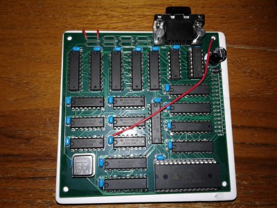

PostPosted: Fri Jan 28, 2022 10:42 am
Posts: 707
Update!
As with every project, some good news and some bad.
Good:
The monitor recognizes the signal perfectly, and displays something! This is the "sync" board, which I panned to the center of the screen. And it is working exactly as expected in that regard. Awesome!
Also to note, I am using H799 and V524 for reset values instead of H800 and V525, and it seem to work great. I'm doing this because it's the sync board, and it needs to reset on the next clock tick, not immediately/async. Just for future info.
Bad:
The RAM is being written to somehow. The screen stays static and stable for a bit, then it starts replacing pixels slowly, then faster, then it's all red. THEN it turns black all at once.
This not 'snow'. Not like a TV without signal. It's just kind of random?
I suspect this is because I don't have a computer plugged in to it to regulate the input lines. When I rake my finger on the RAM pins I get all kinds of changes. They stay for a bit (sometimes) and then they disappear eventually. I tried running a temporary line to keep /WE high, but that doesn't seem to work great (that's the red wire you see in the pic).
I'll be checking things with the scope now. BUT at least it's a panned image and is actually displaying stuff. Cool!
There's my update, thanks everyone! Would not have been possible without you!
Chad
EDIT:
Yep, when I tie /WE to a proper VCC, I can keep a stable image. When I release it, it's sporadic. Scope says /WE fluctuates some when disconnected, or at minimum it stays grounded which means it's constantly being written to (probably lots of zeros, thus the reason why it blacks out often).
