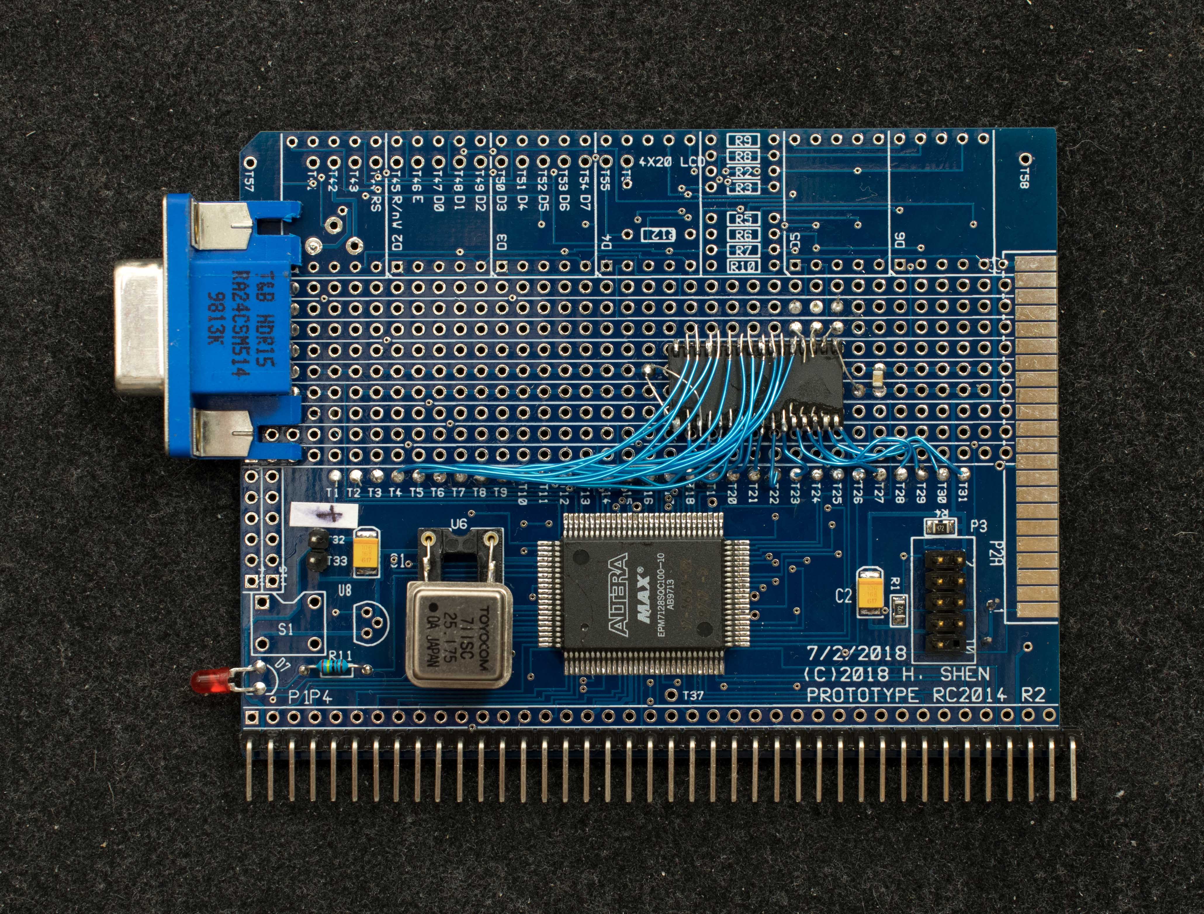

PostPosted: Sun Jan 02, 2022 3:53 am
Posts: 1117
Chad's graphic design has inspired me to take another look at Apple II style of accessing video RAM where 6502 accesses the memory during clock high phase and VGA controller accesses the memory during clock low phase. I plan to do this at 12.6MHz or 1/2 of 25.175MHz.
In the process, I thought I also verify Chad's design by capturing his schematic in Altera's Quartus tool. Quartus has an extensive TTL library so 74161 and 74688 are in the library. Instead of using tri-statable 74245, I used a bus multiplexer to switch between addresses generated by the counters and 6502's address bus. Only the red input is hooked up so the display looks red. The RAM is not initialized so it display random dots. Chad, I think your design of 12/29 is working.
Edit, A quick description of the protype board: The CPLD is a 128 macrocell EPM7128 and the "dead bug" device is CY7C109, 128Kx8 RAM, 25nS. The design does not need 128 macrocells, but it needs more I/O pins than the smaller EPM7064S in PLCC44 can provide.

PostPosted: Sun Jan 02, 2022 5:46 pm
Posts: 741
That's interesting Bill. Can you simulate propagation delays that way too? It's the main thing that's become difficult for me in my designs with the constraints I chose to work with (mostly, low-level through-hole parts and breadboards).
Personally I guess I've been through three iterations of video output designs, all using interleaved CPU and video access to RAM. The main distinction I'm making is how the counters and timing logic worked - I went from using upcounters and logic gates, much like Chad's, to using downcounters instead (74HC40103) which hugely reduced the amount of wiring, and then to using EEPROM for the timing signals as discussed earlier in this thread - which reduces the IC count a lot.
This kind of complexity reduction probably wouldn't matter as much on a PCB, but it helps a lot on a breadboard. Of my designs, the second was, I think, the cleanest. But the EEPROM one is simplest to build.
On an FPGA I'd expect the upcounter design to work best though as it consumes fewest complex resources like memory and flipflops - so in that respect i guess the one that works least well on a breadboard actually wins out on the FPGA?
PostPosted: Sun Jan 02, 2022 7:44 pm
Posts: 1117
The CPLD is faster than HC logic so for timing critical designs, it may not be a good emulation. At 25MHz clock, this VGA design is not particularly fast and the logic do not have too long of delay chain, so I felt it is a reasonable emulation. It does check the correctness of the logic so if the TTL-based design does not work, we can concentrate on PCB implementation, prop delay and system noise issues. Anything one can do to simplify and zero-in on the problem are helpful in debugging.
In CPLD the combinatorial logic is mostly free, so the designs are mostly constrained by the number of flip flops. A medium size CPLD like EPM7128 only has 128 flip flops, so I have to be stingy with flip flops. I generally design in schematic so I have a clear understanding of flip flop usage.
