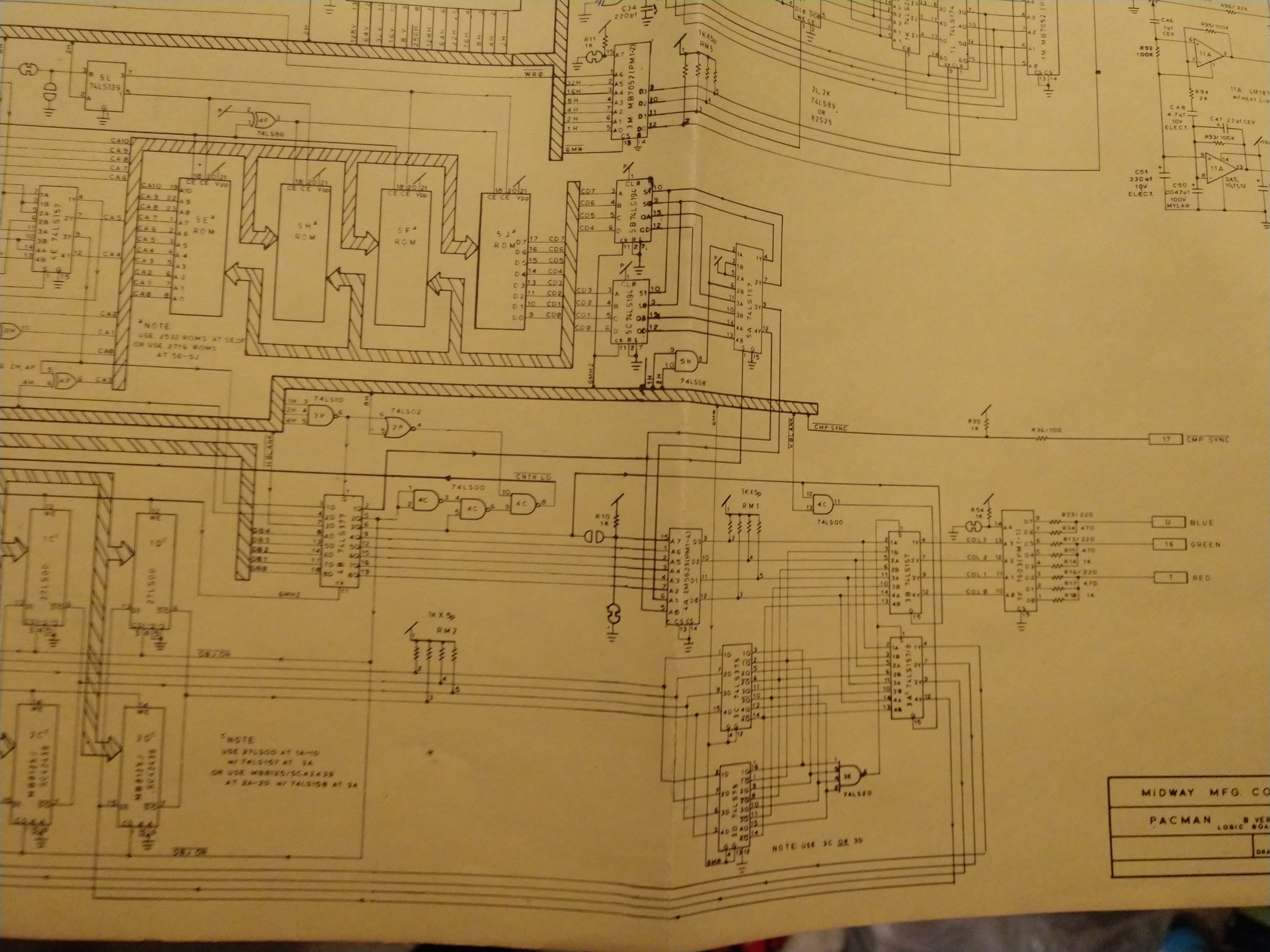

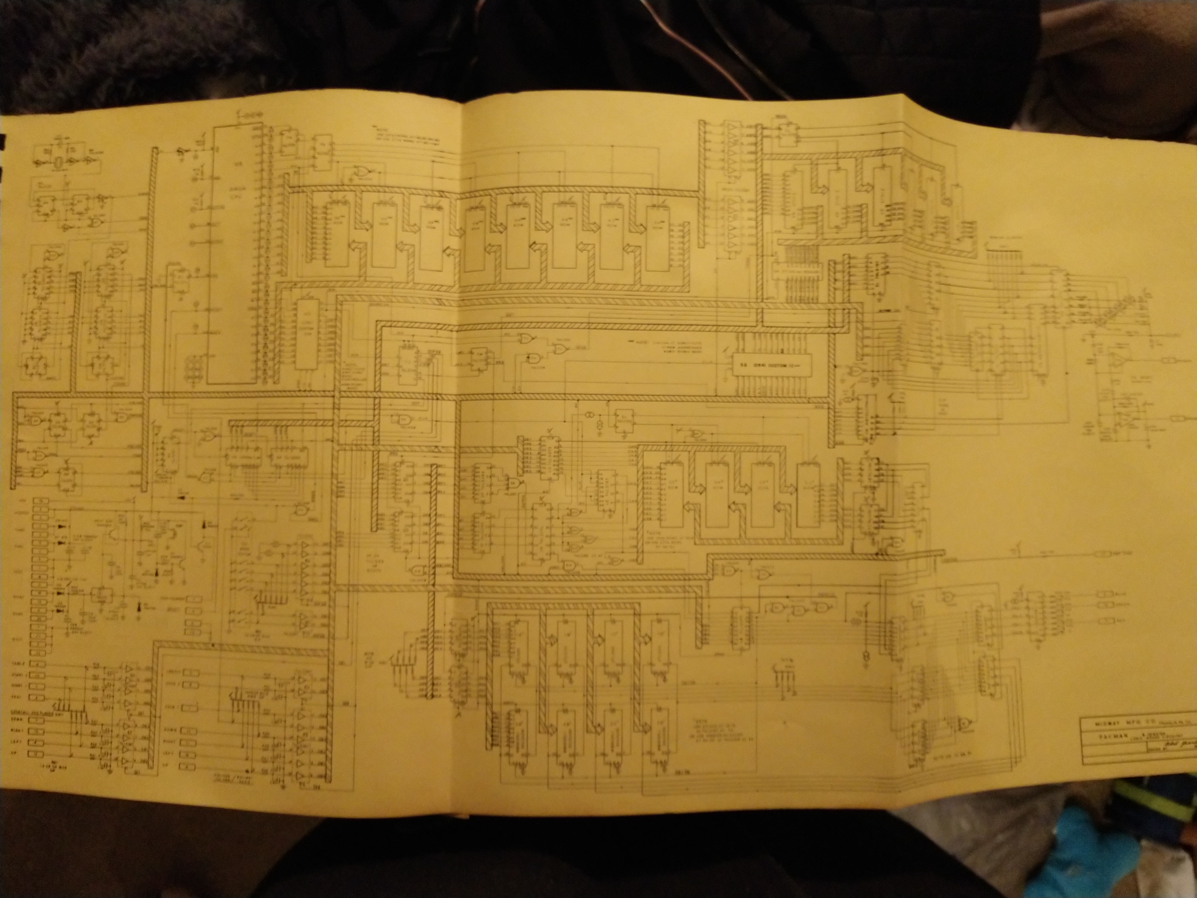

Also, I stopped by my fiancee's parents place today and picked up the oscope, I've not tested it yet or even read any info on it, but it looks very capable, much like the unit I had in a lab in high school. Also, while I was there, he lent me a manual on a Ms. Pac-Man machine, that was based on a z80. I've found a schematic in it that I've attached below, and I believe I've isolated the video section, possibly useful for when I want to add video? Or is it completely useless in today's world?
This is the full schematic (sorry for low quality, my phone wouldn't focus on it correctly)
This is the video section (notice Red Green and Blue outputs to the right)
Arlet
Joined: 16 Nov 2010
Re: 65XX SBC general help and color display help needed
Post by Arlet »
It would be worth it to have the schematic scanned/photographed properly.
Edit: There's a better scan in the PDF manual here:
http://www.fixyourpacman.com/pacman-manuals/

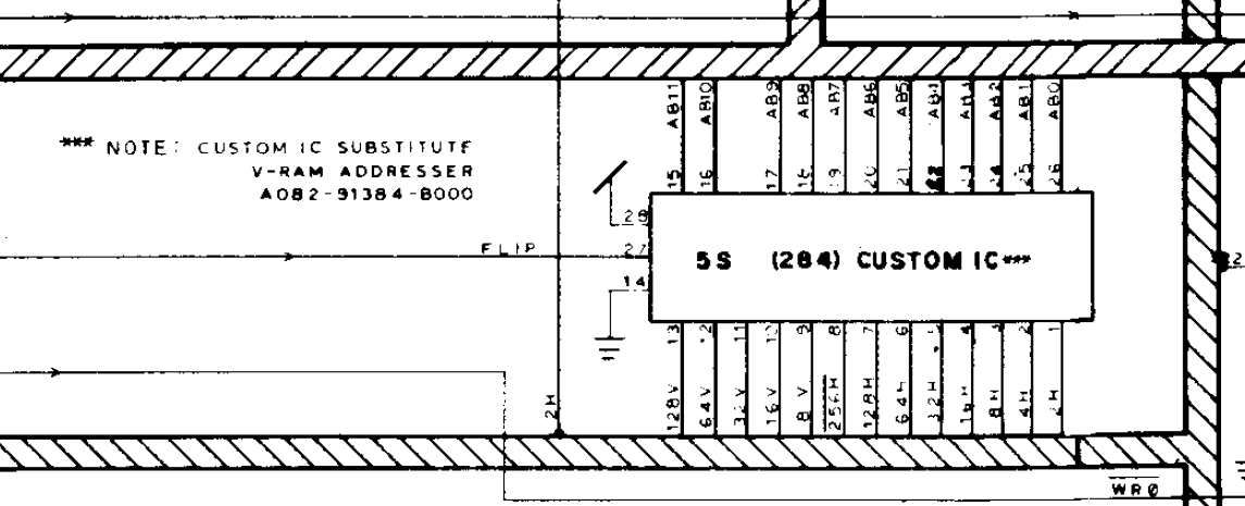

Edit2: there's a custom chip generating video RAM signals.
I saw that chip, I hadn't studied it enough to know it was for video signals, so I assume then that I'll need to just stick to the solution that I had talked about earlier, and figure it out. Still though, it's an interesting schematic, and there may be a few useful parts of it
EDIT: Oh I guess it says right there on the schematic.

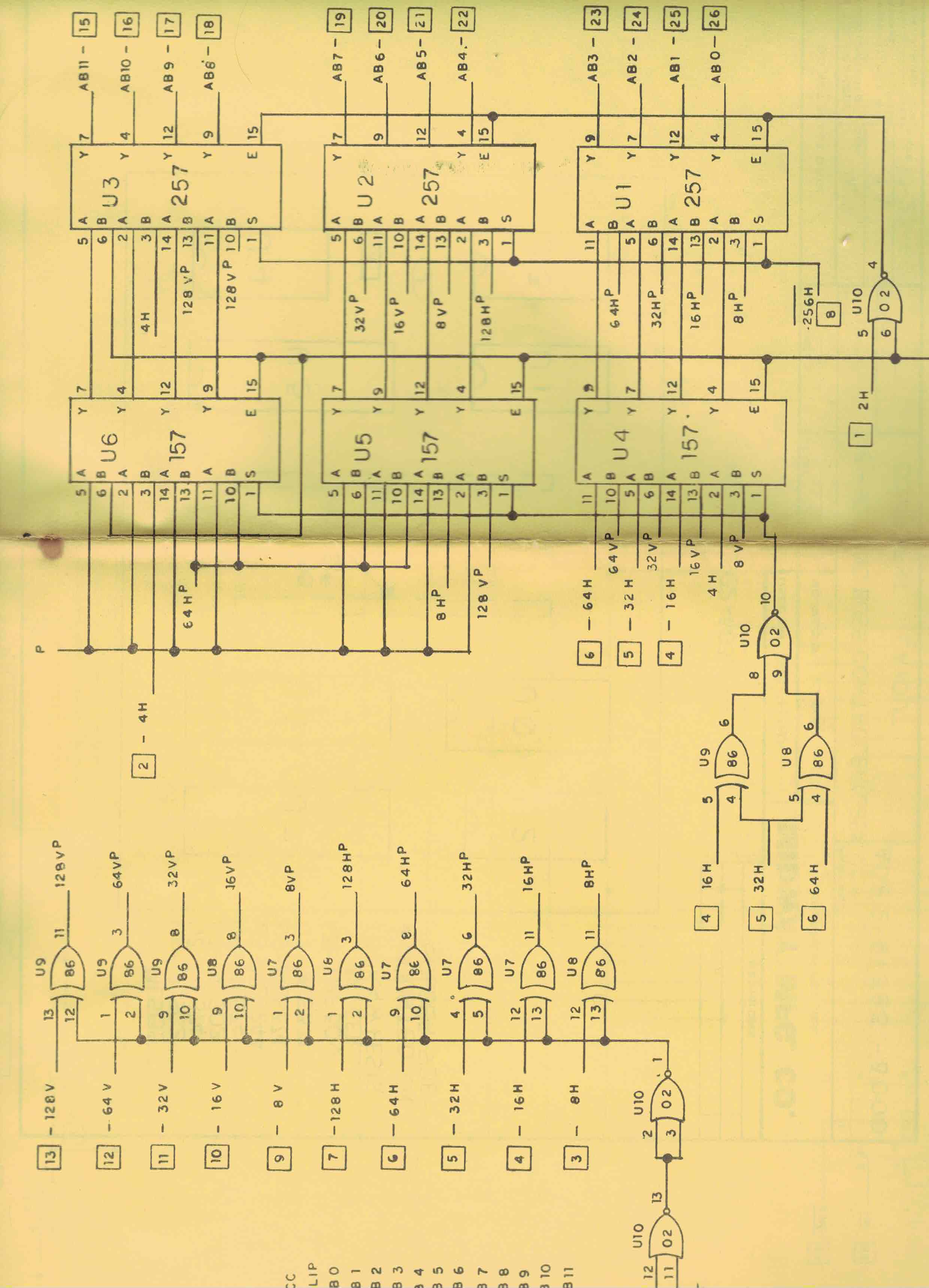

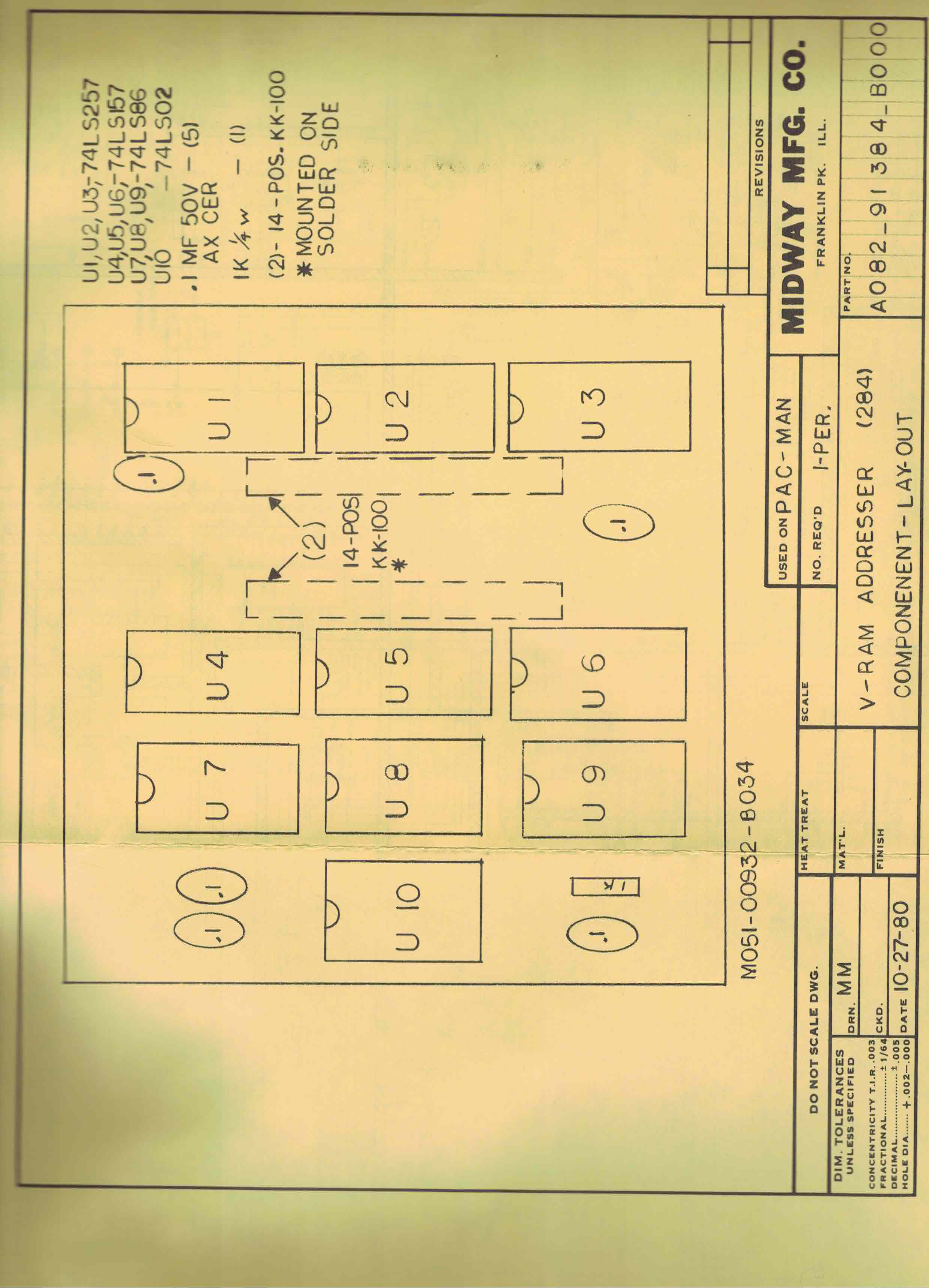

So, the very next page of the manual has the custom vram addresser circuit laid out, here it is (scanned this time):
EDIT:
Here's the actual schematic, it's on the next page,
