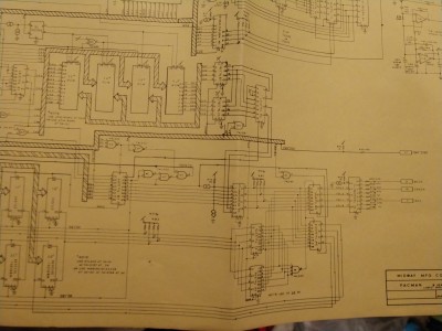

This is the full schematic (sorry for low quality, my phone wouldn't focus on it correctly)
This is the video section (notice Red Green and Blue outputs to the right)

It would be worth it to have the schematic scanned/photographed properly.
Edit: There's a better scan in the PDF manual here:
http://www.fixyourpacman.com/pacman-manuals/
Edit2: there's a custom chip generating video RAM signals.
I saw that chip, I hadn't studied it enough to know it was for video signals, so I assume then that I'll need to just stick to the solution that I had talked about earlier, and figure it out. Still though, it's an interesting schematic, and there may be a few useful parts of it
EDIT: Oh I guess it says right there on the schematic.
