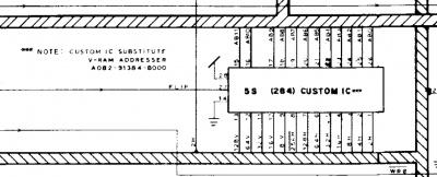

Edit2: there's a custom chip generating video RAM signals.
I saw that chip, I hadn't studied it enough to know it was for video signals, so I assume then that I'll need to just stick to the solution that I had talked about earlier, and figure it out. Still though, it's an interesting schematic, and there may be a few useful parts of it
EDIT: Oh I guess it says right there on the schematic.

Sorry to quote again but didn't want to make another edit to my post. On a site I'd already found from googling some of the chips I found this which offers boards which are discrete component copies of the custom ICs.
Probably not all that useful in the long run, but in case anyone else wants to see about using part of this schematic for something. I'll probably stick with the video chip that was mentioned earlier in the thread.

So, the very next page of the manual has the custom vram addresser circuit laid out, here it is (scanned this time):
EDIT:
Here's the actual schematic, it's on the next page,
