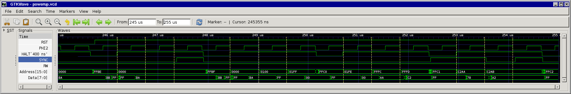

Michael Steil says that the normal interrupt sequence is followed - there are three stack accesses - but that RnW stays high, so there are no writes.
Do you believe you saw writes, or did you just see the addresses?
I'm sure I saw writes (ie, R/W\ was low) but I'd have to dig it up to be more than 90% sure.  The WDC manual also says they are writes, with R/W\ low.
Very interesting, thanks for the info!

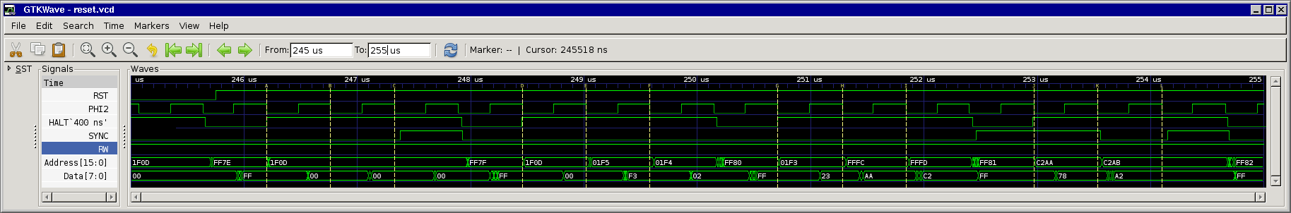

After Michael's blog post I was very interested about seeing this in action so I hooked up my logic analyzer to my Atari 800XL and captured some traces.
Unfortunately Antic dram refreshes destroy the nice pics, just ignore all cycles where HALT is low (in the pics I shifted halt by 400ns so that it's in sync with the stopped clock cycles). To make the actual CPU cycles easier to recognize I set a marker at the start of each CPU cycle.
Here's the powerup:
And here's the reset:

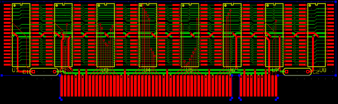

I'm in the process of designing it. The initial one is planned for holding 8 512Kx8 10ns SRAMs, which currently are at a little under $10 per chip, and I probably won't initially be able to buy enough at a time to get any significant discount. So my cost on just the chips will probably be around $70 per set of 8. I haven't figured out yet how the tool-up cost of boards will amortize out. The cost for each bare PC board is rather trivial, but the PCB manufacturing set-up charges are not, so the quantity will dramatically affect the per-piece price. Then I'll have to factor in the assembly labor. The other parts' cost is piddly. I've done enough investigating to know that it's feasible, but it will be awhile before I can sharpen my pencil and come up with a final price. After this first one, I hope to make other densities of SRAM modules and other types of modules.
How about something like this?
The above is on a two-layer board and accepts 512K x 8 SRAM in SOJ32 packaging. I also have a 4-layer design that is very similar. In both cases, the SIMM fits into the same card-edge receptacle that accepts 32 bit PCI cards. Four of these would fully populate an '816 system with 16 MB of static RAM.
Mine will be around 2.4"x1.3" [Edit, after it is in production: It's 2.300" long x 1.234" wide, not including connector], with parts on both sides and the SOJ's a little closer together.  The connector will be a dual-row header of .025" square posts since the socket is cheaper and takes less board space and you can cut it to any length.  It's always good to see others' ideas though.

Mine will be around 2.4"x1.3", with parts on both sides and the SOJ's a little closer together. The connector will be a dual-row header of .025" square posts since the socket is cheaper and takes less board space and you can cut it to any length. It's always good to see others' ideas though.
I have a different version that is four-layer and thus more dense. I looked at using posts/receptacles and card edge, and decided on the latter because of theoretically lower distributed capacitance.
If you have any numbers, I would definitely be interested; but just intuitively speaking, since the capacitance is a function of plate width and separation and the dielectric constant between them, I would expect the wider fingers and reduced separation of the board-edge connectors would give more capacitance than the little pins and the tuning-fork-type contacts they fit into do.
I don't have any numbers, but consider this: the "plate width" of adjacent edge fingers is actually the copper thickness, which is only a couple of mils. The dielectric in this case is air with a K of approximately 1. The wider dimension of a finger on one side is opposed to that of a finger on the other side (if present) but has the relatively thick PCB material as the dielectric. Typical PCB construction produces a K of around 4.6.
Another consideration of using edge connections as opposed to pins is if the pin header is on the motherboard (as it appears you are planning) then the mating receptacle has to be mounted to the memory module, which might complicate the physical construction. With edge connections, nothing has to be attached to the memory module PCB except the components. With a four-layer module, it should be possible to eliminate decoupling capacitors, since the power and ground planes act as the plates of a large capacitor.
Based on the quick experiments I ran way back when, the 65C02 wrote but the NMOS 6502 didn't. From the old thread here:
viewtopic.php?p=2959#2959
