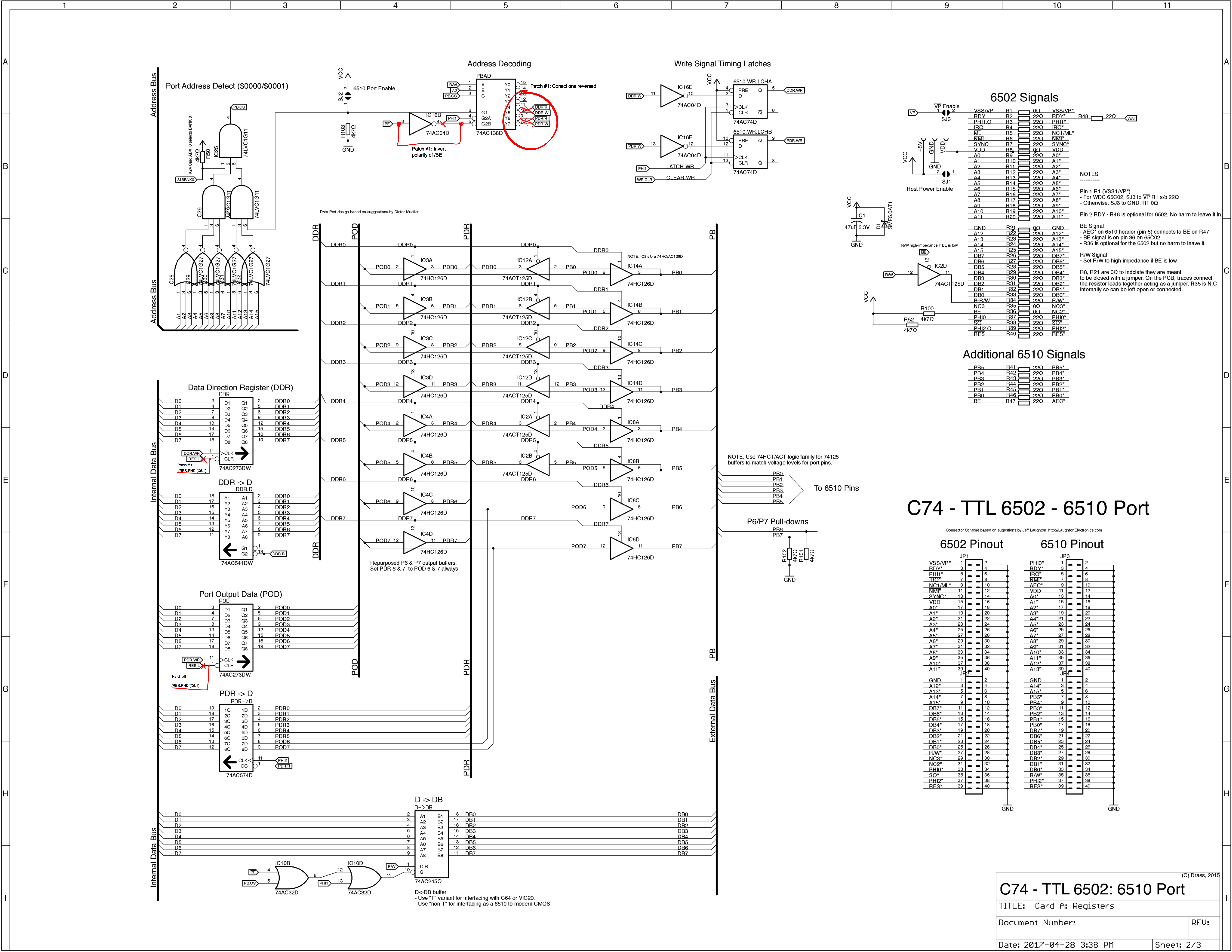

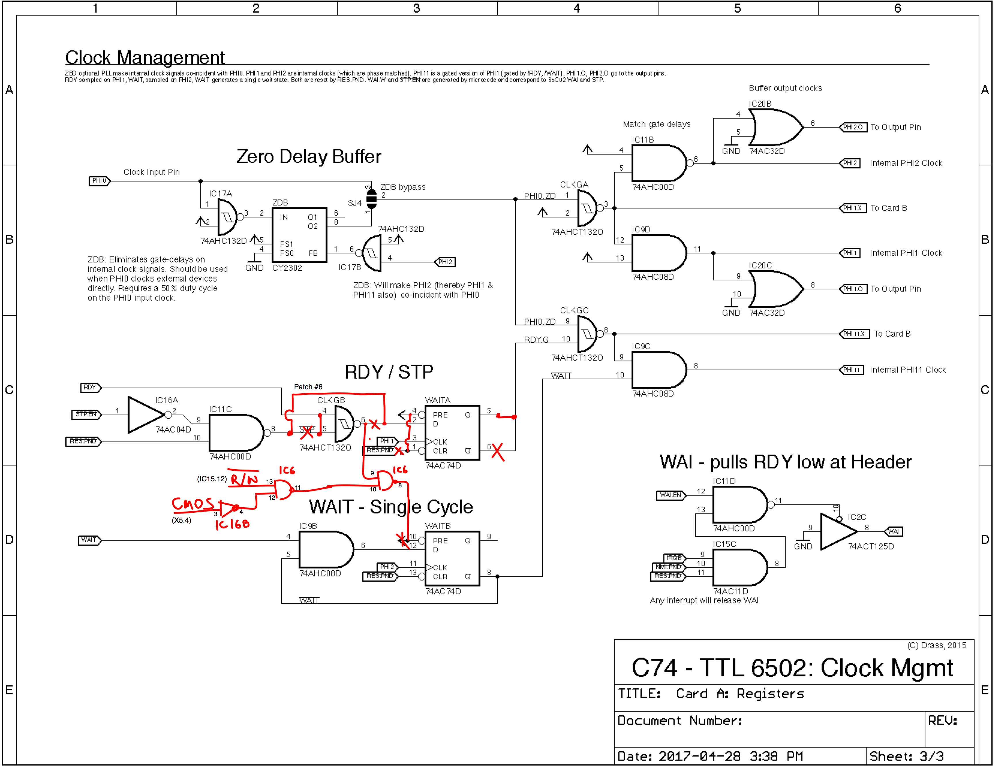

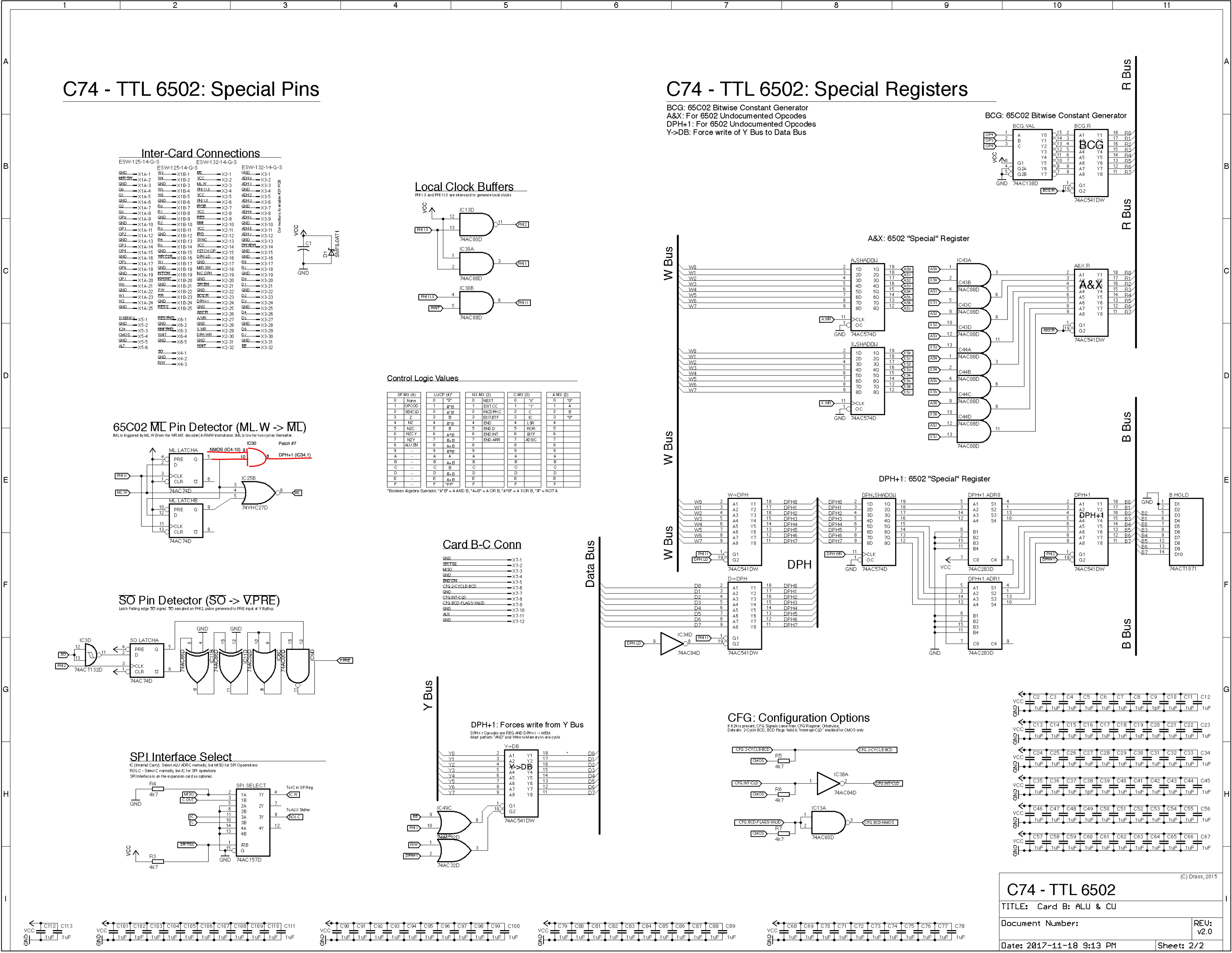

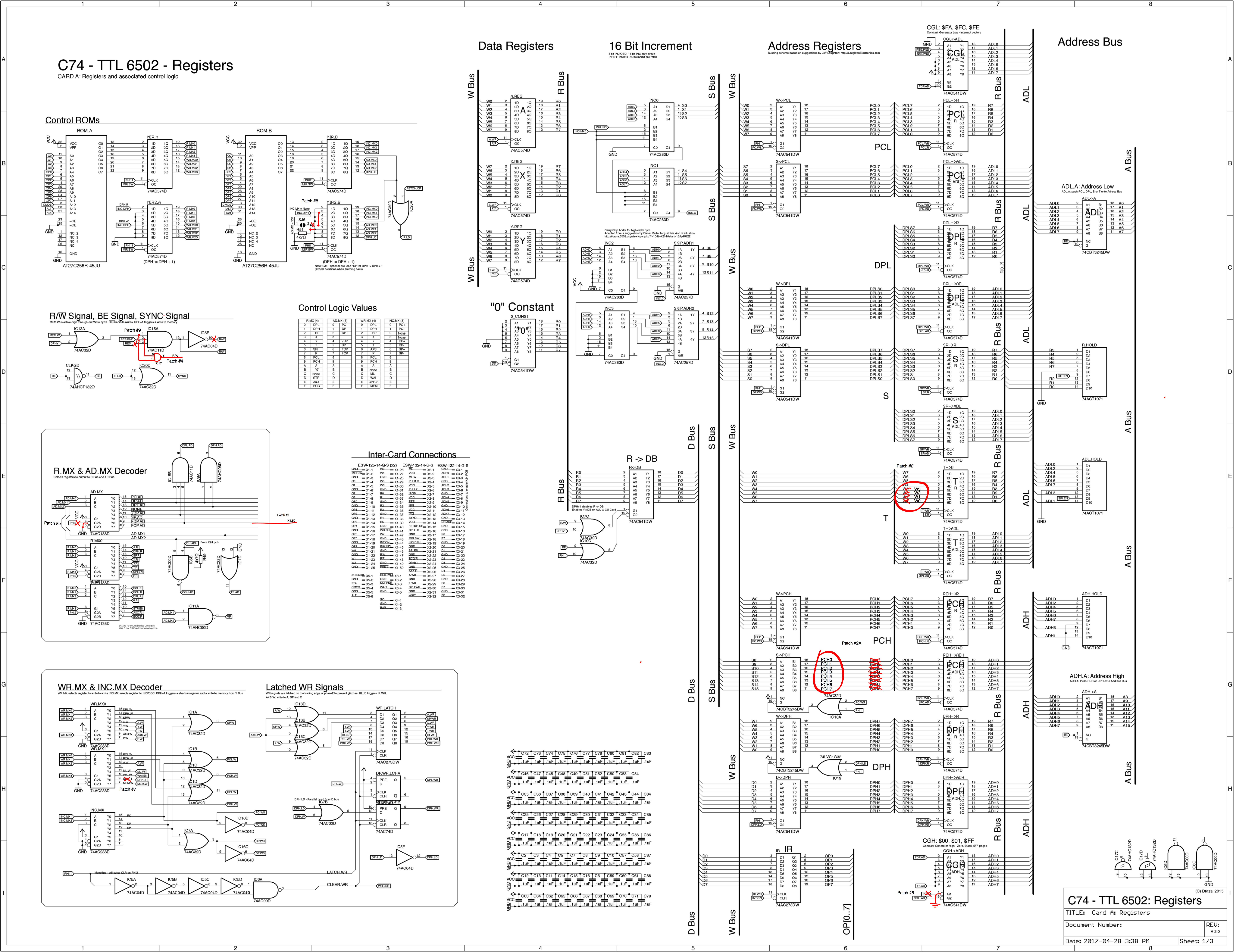

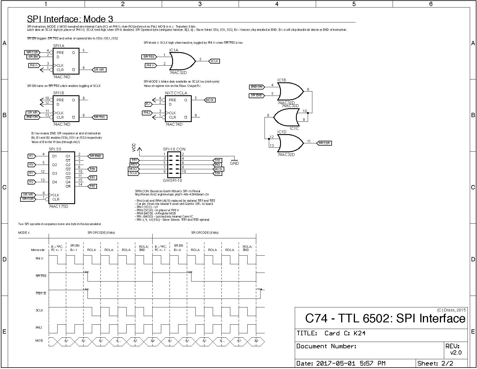

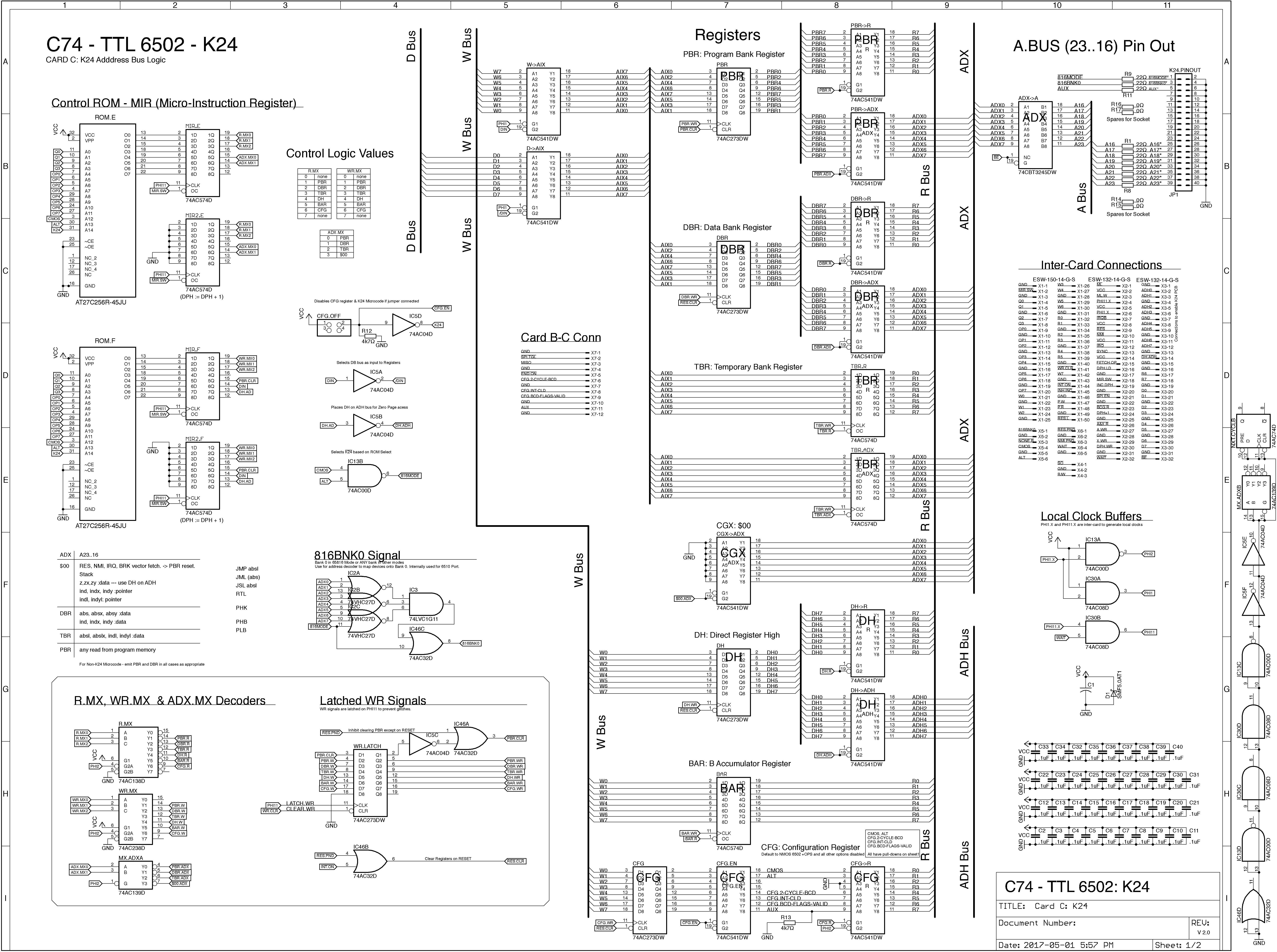

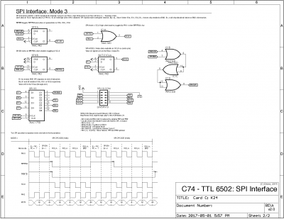

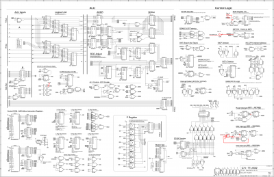

Here now, finally, are the schematics for the C74-6502.
Truth be told, I had wanted to wait until these were made final before posting. But given the various requests I've received, I decided to relent and put these up in this "not quite finished" state. The attached schematics do accurately reflect the existing prototype, and are annotated to clearly indicate with the various patches that were applied during debugging. I have attached also an accompanying PCB Patch Guide detailing all such patches as an aid to anyone wishing to build a working unit from the prototype boards (we already have one such project underway!).
Although work remains before we can officially call an end to this project, I did want to take a moment and say thanks on behalf of Team C74. What an incredible adventure this has been! I am very grateful to all here who supported these efforts with such enthusiasm and interest. It's a wonderful privilege to be part of this community.
And of course, a special thanks also to the rest of Team C74 -- ttlworks and Dr Jefyll -- for their generous help and friendship.
... But there is no rest for the weary, as already work has started on a potential successor to the C74-6502. Can it be made faster still? Stay tuned ... :)
Notes to the schematics:
  • The annotated schematics are large files -- regrettably that had to be the case to make them legible.

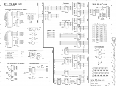

  • I did not complete annotated schematics for Card C (K24 card). There are a couple of patches for this card outlined in the Patch Guide.
  • The K24 SPI circuitry remains untested at this point. All other functions in the K24 Card work as advertised.
  • I will in time post Gerbers, BOMs and Eagle files on the project website. In the meantime, please PM me if you are interested.
First up, the PCB Patch Guide:
C74-6502 PCB Patch Guide (v1.0).pdf
(529.95 KiB) Downloaded 339 times

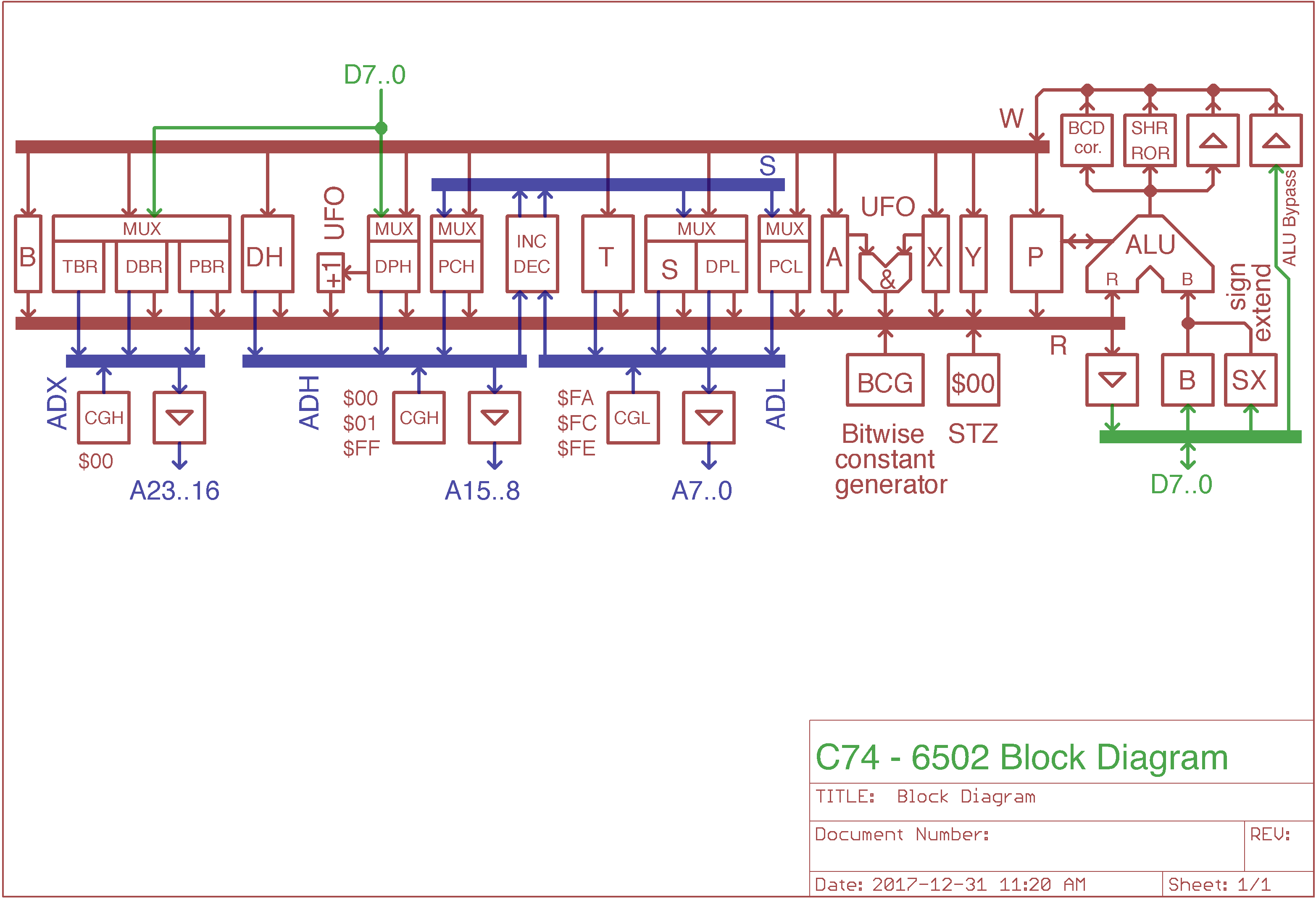

Block Diagram by ttlworks:
Card A Schematic -- Page 1
Card A Schematic -- Page 2
Card A Schematic -- Page 3
Card B Schematic -- Page 1
Card B Schematic -- Page 2
Card C Schematic -- Page 1 (Unannotated)
Card C Schematic -- Page 2 (Unannotated)

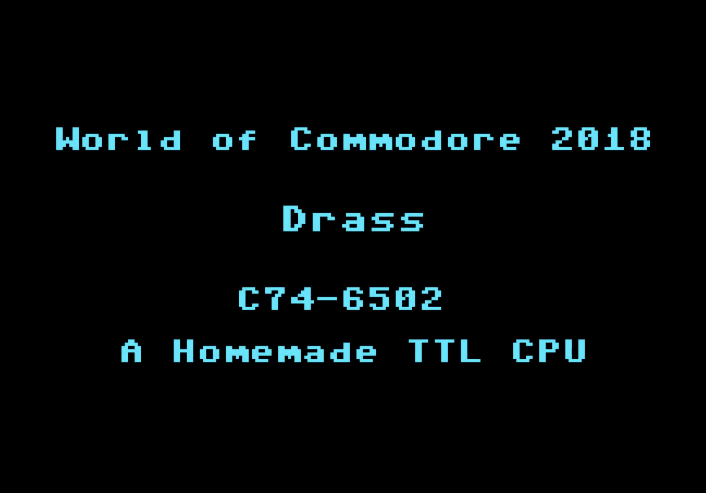

The talk I gave at WoC 2018 on the C74-6502 is now up on YouTube. This was a wonderful day, made better by the fact that Dr Jefyll and I were able to exhibit together at the event. Here is a write-up on the day (posted upthread).
Thanks to the WoC folks for accommodating Jeff and I at the last minute, and for hosting such a great event.
Here is a link to a video of the talk: https://youtu.be/dB3P5tt4gnE

Welcome.
The C74-6502 CPU aims for 6510 compatibility, so it already has three state outputs for address, data, R/W.
On the 6502 connectors, BE (6502 pin 36) is the high active output enable for these buffers.
//6502 and 6510 have different pin assignments, so C74-6502 has two sets of connectors for supporting both chips.
From the schematic in the atariage forum, one just would have to add a 7402 and a 7474 to the C74-6502 CPU.
But at higher clock speeds C74-6502 CPU uses a CY2302 zero delay buffer in the clock circuitry, and that chip doesn't like clock skewing tricks.
So for a "Sally" modification like in that schematic, one has to go without the zero delay buffer, what might limit the CPU clock speed to 12MHz or so.
Internally, the C74-6502 CPU architecture is different from the 6502 chip.
The program counter is a register, not a counter.
And I don't know what side effects tinkering with the register write enable would have because C74-6502 is pipelined.
I don't have the most recent version of the C74-6502 CPU layouts and schematics at hand, but it looks like there isn't much space left on the PCBs.
Maybe Drass could provide some more info.
Drass
Posts: 428
Joined: 18 Oct 2015
Location: Toronto, ON
Re: TTL 6502 Here I come
Post by Drass »
You’re right Dieter. Gating the clock input to the C74-6502 will require that the Zero-Delay-Buffer be bypassed. That can be done with a solder jumper, but it will limit the clock-rate to about 14MHz.
As for space, there is none! Having said that, I often found creative ways to repurpose what is on the board already. There’s is a lot of functionality there, so I would not be surprised if there is a way to shake loose a gate and a flip-flop by disabling some unneeded feature or other. :)
