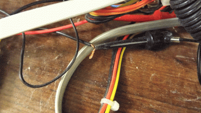

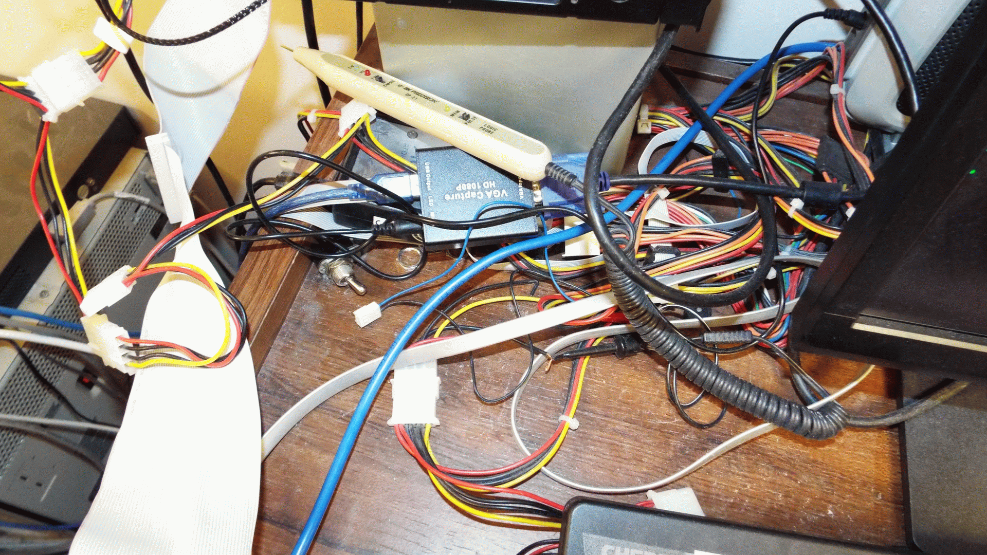

About a week ago, I went to use the logic probe to look at something on POC V1.3, only to have the entire mess suddenly go dead, meaning “dead” as in “there isn’t any power” dead. I turned off the mains switch on the power supply, waited a few seconds and tried powering up. Nothing! I tried it again, same result (yes, I know: insanity is repeating some action and expecting a different result each time). I had unpleasant visions of something on the POC unit having been somehow destroyed by me poking it with the probe. It wouldn’t be the first time!
By way of explanation, I should mention that the POC unit and its disks are run by an ancient power supply that I scabbed from an equally-ancient PC from the 1990s. Since the power supply is very old, not only was I having unpleasant visions of toasted POC parts, the possibility the power supply had decided to pack it in was swirling in my mind.
First thing I did was disconnect POC and the disks so nothing would get anymore damaged than I already thought it was. Since PC power supplies usually require a minimum amount of loading to power up, I plugged in a makeshift artificial load (a 10 ohm, wirewound resistor with an LED in parallel for a visual indication of power) on one of the unused Molex connectors and flipped the switch. The power supply very briefly produced power, evidenced by the LED flashing, and then died. Okay, it appeared the power supply may have breathed its final breath. Not a problem—I've got more power supplies scavenged from old machines.
While I was contemplating the situation, I saw something that explained the sudden “failure.”
Above is the POC “test rig,” which may be charitably described as a rat’s nest of wires and cables. The logic probe gets its power from a crude connection consisting of an old Molex connector chopped off a power supply extender harness, with two wires stripped to provide five volts and ground. Hey, I was eager to get the computer running—beautifying the installation was a project for another time.
Above is how the logic probe is powered.
At this point, I’m sure you can surmise what had happened. I picked up the probe to use it and somehow the two bare connections got together, said “Let’s give him a scare.” and proceeded to short out the power supply. The power supply did what it is supposed to do, which is immediately shut down. I, of course, thought I had managed to hit two pins at the same time on the chip I was probing and thus managed to brick the chip...and the computer. Since the short remained after I had disconnected everything except the logic probe, testing the power supply made it appear that it had coughed its cookies.
Once I had separated the errant wires and reconnected everything, V1.3 powered up and all was well. Ah, the perils of monkey-rigged wiring!
Incidentally, that thing on which the logic probe is resting in the first photo is a VGA-to-USB converter, whose input is driven by a VGA splitter, which in turn, is connected to the thin client that acts as POC’s console. With that, I am now able to capture POC’s video output in real time on my creaky, old Windows XP workstation. I got the parts from an Amazon vendor—they work like a charm.

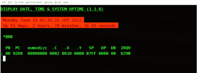

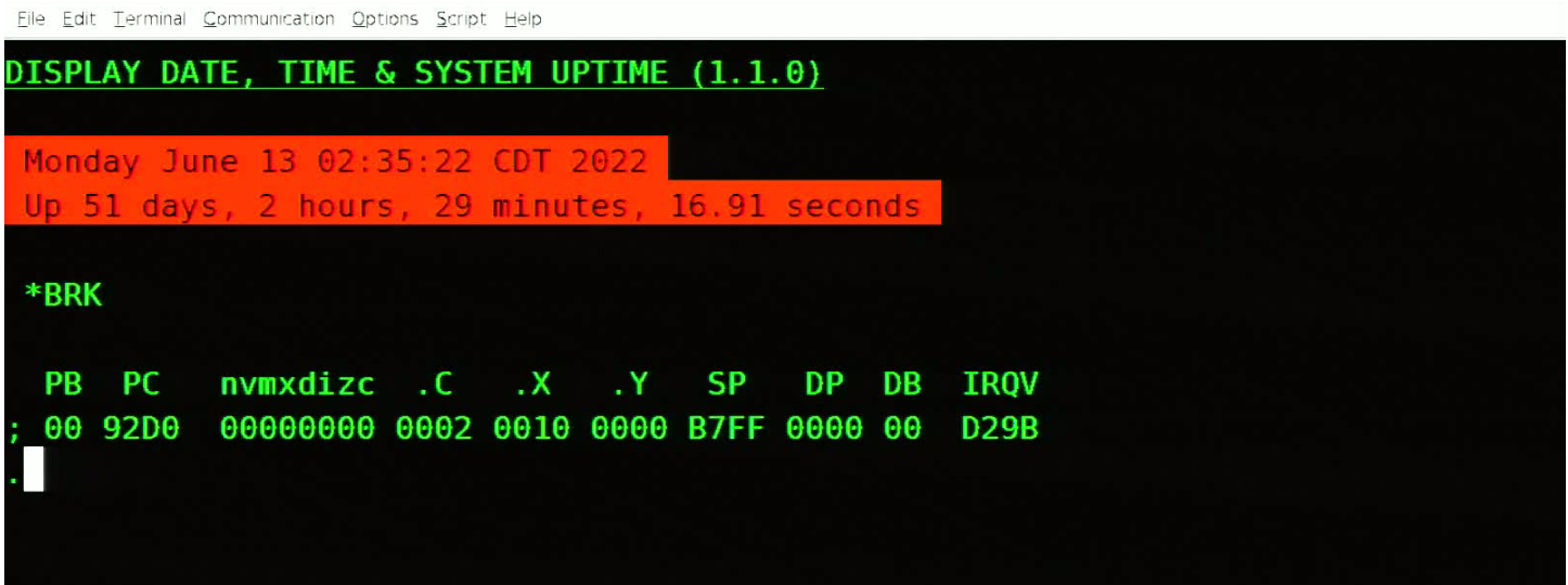

POC V1.3 keeps chugging along as I debug my filesystem software. Here’s an uptime snapshot.

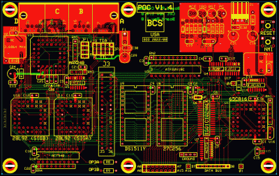

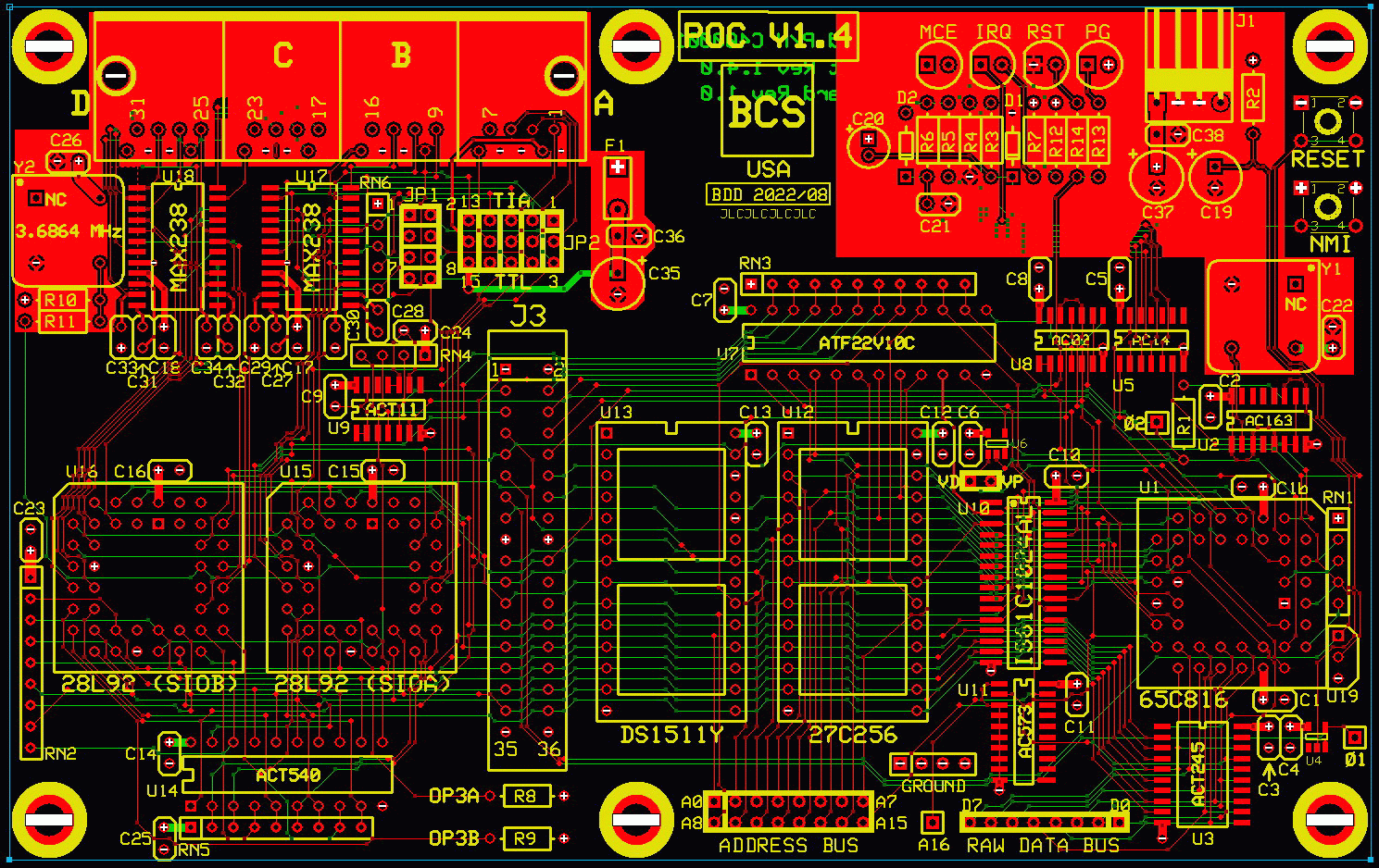

...and here’s the printed circuit board:
V1.4’s bank $00 memory map is somewhat different than V1.3. Each I/O device occupies 128 bytes of address space, compared to the 256 bytes that older POC versions have used. Also, there is no mirroring in the I/O block. So instead of I/O extending from $00C000 to $00CFFF, as it did in V1.2 and V1.3, it now occupies $00C000 to $00C3FF. As a result, previously-inaccessible RAM from $00C400 to $00CFFF is now exposed, for a total of 3KB. That RAM will be “owned” by the system firmware, and will have enough room for direct page (256 bytes), the hardware stack (256 bytes), the serial I/O queues (2048 bytes), and BIOS kernel and M/L monitor workspace (512 bytes). Everything in bank $00 below $00C000 will be unencumbered, as will be the case with bank $01 RAM. ROM will continue to be visible from $00D000 to $00FFFF.
One of the benefits of the new memory map is applications can set the top-of-stack and start of direct page anywhere below $C000 without interfering with the firmware. That gives applications 48KB of contiguous bank $00 RAM for their direct pages and stacks. As firmware API calls are via software interrupts, applications can run equally well in bank $01, which makes possible having TSR programs loaded and readily available when needed (a feature also possible in POC V1.3, although with less bank $00 “elbow room”). This capability is made possible by the relative ease at which 65C816 programs can be made relocatable.
Hardware-wise, there’s the GAL, an ATF22V10C, to replace all of the discrete address-decoding logic used in the old POC versions. I was able to get hold of the somewhat-elusive 7.5ns part, so I’m not expecting any timing contretemps (famous last words
Clock generation is completely different than that of V1.3. V1.4 uses a synchronous counter (74AC163) to produce Ø2, which is an approach I tested in V1.2 (which was stable at 20 MHz), that having been derived from Jeff’s clock-stretching circuit. As a Ø1 clock (inverted Ø2) is needed to gate the bank bits latch, and the counter doesn’t have a complement to its QD output, a 74LVC1G04 inverter that is driven from QD does the honors. The inverter introduces approximately 3 to 4 ns prop time (a bit less than with 74AC or 74AHC logic), but as an experiment, I skipped the series resistor I usually have in clock circuits to suppress ringing. Ø2 continues to pass through series resistance, which introduces a small amount of lag in the signal (apparently 2-3 ns, from observations made on POC V1.3). The result is the two clocks should be very close to being 180 degrees out of phase. The logic analyzer will tell the tale when I get this thing built. If this works as I hope it will, I should be able to clock the system at 20 MHz.
Construction-wise, V1.4 will be built on the usual four-layer board. I’ve included a lot of test points to facilitate observation, include the entire address space, data bus and some other signals. I’m also using a slot for expansion, which is more reliable than the pin arrangement used in older POC versions. One other change I made was to mount the real-time clock on the main board in its own socket. Previously, the RTC had to be mounted on whatever was going to be plugged into expansion, which was inconvenient from a design standpoint. Reserving space on the PCB necessitated an increase in board size to get the clock to fit. The increase is negligible.
I’ve got parts on order and as soon as I get them, I’ll verify clearances on the PCB and then get it made.
