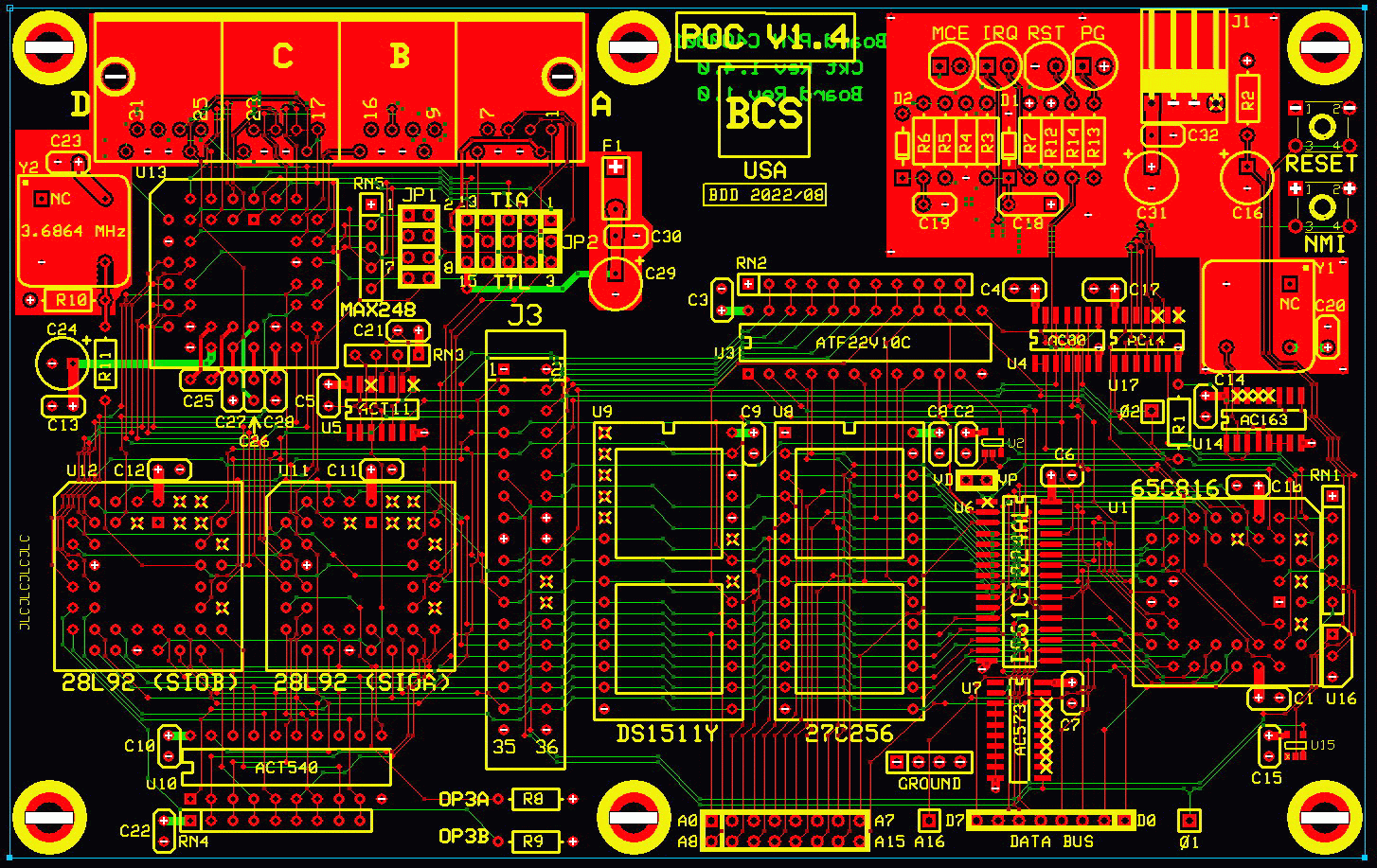

...and here’s the printed circuit board:
File comment: POC V1.4 PCB
V1.4’s bank $00 memory map is somewhat different than V1.3. Each I/O device occupies 128 bytes of address space, compared to the 256 bytes that older POC versions have used. Also, there is no mirroring in the I/O block. So instead of I/O extending from $00C000 to $00CFFF, as it did in V1.2 and V1.3, it now occupies $00C000 to $00C3FF. As a result, previously-inaccessible RAM from $00C400 to $00CFFF is now exposed, for a total of 3KB. That RAM will be “owned” by the system firmware, and will have enough room for direct page (256 bytes), the hardware stack (256 bytes), the serial I/O queues (2048 bytes), and BIOS kernel and M/L monitor workspace (512 bytes). Everything in bank $00 below $00C000 will be unencumbered, as will be the case with bank $01 RAM. ROM will continue to be visible from $00D000 to $00FFFF.
One of the benefits of the new memory map is applications can set the top-of-stack and start of direct page anywhere below $C000 without interfering with the firmware. That gives applications 48KB of contiguous bank $00 RAM for their direct pages and stacks. As firmware API calls are via software interrupts, applications can run equally well in bank $01, which makes possible having TSR programs loaded and readily available when needed (a feature also possible in POC V1.3, although with less bank $00 “elbow room”). This capability is made possible by the relative ease at which 65C816 programs can be made relocatable.
Hardware-wise, there’s the GAL, an ATF22V10C, to replace all of the discrete address-decoding logic used in the old POC versions. I was able to get hold of the somewhat-elusive 7.5ns part, so I’m not expecting any timing contretemps (famous last words :D). As the 22V10 has only 10 dedicated outputs, I am still dependent on some discrete logic, namely an OR gate to produce a valid address signal (VADR, which is VDA | VPA) for the GAL’s benefit. Since it is the only use of an OR gate in the circuit, I designed around a LVC1G part, which economizes PCB real estate consumption. Plus the LVC1G part is slightly faster than AC or AHC logic.
Clock generation is completely different than that of V1.3. V1.4 uses a synchronous counter (74AC163) to produce Ø2, which is an approach I tested in V1.2 (which was stable at 20 MHz), that having been derived from Jeff’s clock-stretching circuit. As a Ø1 clock (inverted Ø2) is needed to gate the bank bits latch, and the counter doesn’t have a complement to its QD output, a 74LVC1G04 inverter that is driven from QD does the honors. The inverter introduces approximately 3 to 4 ns prop time (a bit less than with 74AC or 74AHC logic), but as an experiment, I skipped the series resistor I usually have in clock circuits to suppress ringing. Ø2 continues to pass through series resistance, which introduces a small amount of lag in the signal (apparently 2-3 ns, from observations made on POC V1.3). The result is the two clocks should be very close to being 180 degrees out of phase. The logic analyzer will tell the tale when I get this thing built. If this works as I hope it will, I should be able to clock the system at 20 MHz.
Construction-wise, V1.4 will be built on the usual four-layer board. I’ve included a lot of test points to facilitate observation, include the entire address space, data bus and some other signals. I’m also using a slot for expansion, which is more reliable than the pin arrangement used in older POC versions. One other change I made was to mount the real-time clock on the main board in its own socket. Previously, the RTC had to be mounted on whatever was going to be plugged into expansion, which was inconvenient from a design standpoint. Reserving space on the PCB necessitated an increase in board size to get the clock to fit. The increase is negligible.
I’ve got parts on order and as soon as I get them, I’ll verify clearances on the PCB and then get it made.

PostPosted: Thu Sep 08, 2022 2:41 am
Posts: 1385
Yes, some component prices have gotten out of hand. New PCB looks great... just wondering why you didn't use a single latch component (SN74LVC1G373) instead of the '573 octal latch, as only one of the 8 is being used. Just curious...
PostPosted: Thu Sep 08, 2022 6:00 am
Posts: 8514
The SOT-23 version of the 74LVC1G373 is currently unobtanium. Lead times for that part are stretching out to March of next year. I don’t want to go smaller than SOT-23 if possible.
The 74AC573 in SOIC is readily available in large quantities. Seven latches are being wasted, but so be it.

* all risk in connection with the incorporation of this software into any system. *
* VERSION HISTORY *
Ver    Rev Date    Revision
1.0.0  2022/08/13  Original version.
    Memory Map
000000-00BFFF  RAM
00C000-00C3FF  I/O
00C400-00CFFF  RAM
00D000-00FFFF  ROM
010000-01FFFF  RAM
       I/O Block Map
00C000  DUART #1
00C080  DUART #2
00C100  vQUART IRQ status
00C180  Real-time clock
00C200  Expansion select A
00C280  Expansion select B
00C300  Expansion select C
Name        pocv14;
PartNo      C220813001;
Date        2022/08/13;
Revision    1.0.0;
Designer    BDD;
Company     BCS Technology Limited;
Assembly    POC V1.4;
Location    U3;
Device      g22v10;
pin  1                    = A15;           /* input   address line             */
pin  2                    = A14;           /* input   address line             */
pin  3                    = A13;           /* input   address line             */
pin  4                    = A12;           /* input   address line             */
pin  5                    = A11;           /* input   address line             */
pin  6                    = A10;           /* input   address line             */
pin  7                    = A9;            /* input   address line             */
pin  8                    = A8;            /* input   address line             */
pin  9                    = A7;            /* input   address line             */
pin 10                    = A16;           /* input   address line             */
pin 11                    = VADDR;         /* input   valid address            */
pin 13                    = RWB;           /* input   read/write               */
pin 14                    = !WSE;          /* output  wait-state enable        */
pin 15                    = !RAM;          /* output  RAM select               */
pin 16                    = !ROM;          /* output  ROM select               */
pin 17                    = !RTC;          /* output  RTC select               */
pin 18                    = !XIOC;         /* output  expansion C select       */
pin 19                    = !XIOB;         /* output  expansion B select       */
pin 20                    = !XIOA;         /* output  expansion A select       */
pin 21                    = !SIOQ;         /* output  vQUART IRQ status select */
pin 22                    = !SIOB;         /* output  DUART #2 select          */
pin 23                    = !SIOA;         /* output  DUART #1 select          */
field addr = [A15..A7];                    /* effective address LSW            */
* LOGIC EQUATIONS *
RAM  = VADDR & (addr:['h'00xx..BFxx] # addr:['h'C4xx..CFxx] # A16);
SIOA = VADDR & !A16 & addr:['h'C00x..C07x];
SIOB = VADDR & !A16 & addr:['h'C08x..C0Fx];
SIOQ = VADDR & !A16 & addr:['h'C10x..C17x];
RTC  = VADDR & !A16 & addr:['h'C18x..C1Fx];
XIOA = VADDR & !A16 & addr:['h'C20x..C27x];
XIOB = VADDR & !A16 & addr:['h'C28x..C2Fx];
XIOC = VADDR & !A16 & addr:['h'C30x..C37x];
ROM  = VADDR & !A16 & addr:['h'D0xx..FFxx] & RWB;
WSE  = VADDR & !A16 & (addr:['h'C0xx..C3Fx] # addr:['h'D0xx..FFxx]);
   * * *   E N D   O F   F I L E   * * *
Can anyone spot the difference between the two renditions? :D
