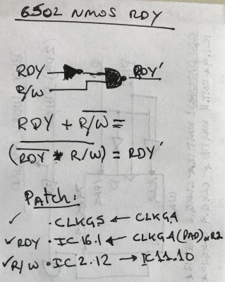

RDY is something that has to be fixed, so for sure it’s a great place to start:
There was an inverter/NAND combination on the board that I could use (previously used for STP), so the patch proved relatively painless. RDY’ above is the NMOS compatible signal — it stays high if R/W is low, which is what we want. In the final design, I’ll want to make the behaviour configurable, but a hard patch will do for now. A quick run with the Analyzer confirmed it works as expected.
But unfortunately, the problems are still there ... :(

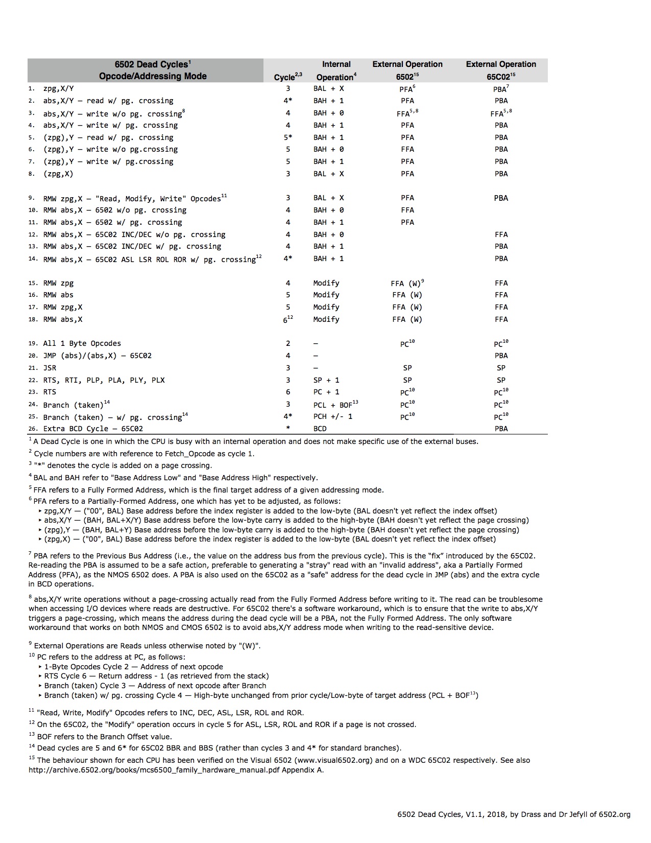

Thanks for the suggestion, Dieter. As it turns out, I already have a program to export the microcode to Logisim. It can be easily modified to validate cycles.
But the first step is to make sure we know what the "correct" behaviour of dead cycles is (i.e., cycles in which the CPU is busy with an internal operation and leaves the bus in some "temporary" state). Some of these dead cycles result in NMOS "stray" reads, but we know there are lots of subtleties and inconsistencies here. Given the various permutations of addressing modes and page-crossings on both NMOS and CMOS versions, just getting it all straight is a bit of a challenge.
To tackle it, Dr Jefyll and I put together a list of test cases, and I set about methodically to validate each on both my 65C02 SBC and the Visual 6502. The results were very interesting to say the least. One notable highlight is that, as Jeff pointed out, the "fix" that the 65C02 introduced to avoid stray reads during page-crossings was to simply leave the address already on the bus and reuse it during the dead cycle. That address is often PC, but is sometimes not (during indirect indexed addressing, for example). It can be confusing, but having a table which summarizes things sure helps.
So, here now, after many revisions and improvements suggested by Jeff, is a table documenting the dead cycles we are aware of for both 6502 and 65C02 variants (a pdf versions is also attached):
The next step is to change the microcode to reflect this, as well as to figure out how to deal with instances when the TTL CPU dynamically generates micro-instructions during page-crossings. More on that later. :)
Cheers for now,
Drass
*** EDIT *** While working on updating the microcode for the TTL CPU, I ran across some dead cycles we missed the first time around. I've updated the document (now on revision 1.1) to reflect this, attached below.
6502 Dead Cycles.pdf
(185.31 KiB) Downloaded 276 times

I spent some time updating the microcode, and in the process found a few dead cycles we missed the first time around, as follows:
  • JMP (abs, X) -- Cycle 4
    RTI, PLP, PLA, PLX, PLY -- Cycle 3
    BBR, BBS -- Cycles 5 and 6*
I've added these on the document and updated the post above. At the same time, I noted that a couple of incompatibilities will likely have to remain in the TTL CPU. This is due to the specific way in which certain internal functions are implemented, as follows:
  • 65C02 abs,X/Y write w/o pg. crossing -- this is the "annoying" bug whereby the CPU reads the target address before writing to it. The 65C02 fixes the problem if a page is crossed. On the TTL CPU, the microcode does not distinguish between a page-crossing and the lack of one (it simply adds the internal carry in both instances), and so we're stuck with only one possible behaviour. I've chosen to make the 65C02 "fix" apply whether or not a page is crossed. The same is true for the 65C02 INC/DEC instructions with an abs,X addressing mode.
  • NMOS 6502 RMW Modify cycles -- the TTL CPU lacks the ability to write to memory while storing the ALU result in an internal register during the "Modify" cycle of RMW instructions. The function is simply not needed other than to support this particular aspect of the NMOS 6502, and I didn't design for it. So instead we are forced to execute "two reads and one write" for RMW instructions as the 65C02 does.
Arguably, these are both improvements, but that's not what we're after here. My guess is that the "65C02 abs,X/Y" incompatibility is unlikely to be a problem. I'm not as optimistic about the NMOS issue, however. We know programmers have used many NMOS side-effects to benefit at one time or another. That said, the C64 does not seem to have any FIFO type queues that might be sensitive to a different number of reads and writes in RMW instructions. A write to a CIA Interval Timers does have a different function from a read (specifically, a write sets the Timer Latch while a read returns the Timer Counter), but this only means the write of a RMW instructions is delayed by one cycle (R-R-W vs. R-W-W). This delay would have no impact when the Timer is stopped, and I suspect no impact of consequence when the Timer is running. I can't think of other potential problems this issue might present on the C64 (which of course does not mean there won't be any!).
While I was at it, I checked for dead cycles in Undocumented Opcodes, and made sure those were correct as well (as it happens, the microcode in the TTL CPU uses a common set of fundamental microinstructions for all opcodes -- a set of primitives as it were. As a consequence, fixing dead cycles for documented opcodes also dealt with undocumented ones in passing). All in all, therefore, I feel fairly confident that dead-cycles are replicated accurately for both NMOS and CMOS modes (with the above-noted exceptions). If this is in fact the problem, these changes to the microcode *should* address it.
Time to burn some ROMs! :)
