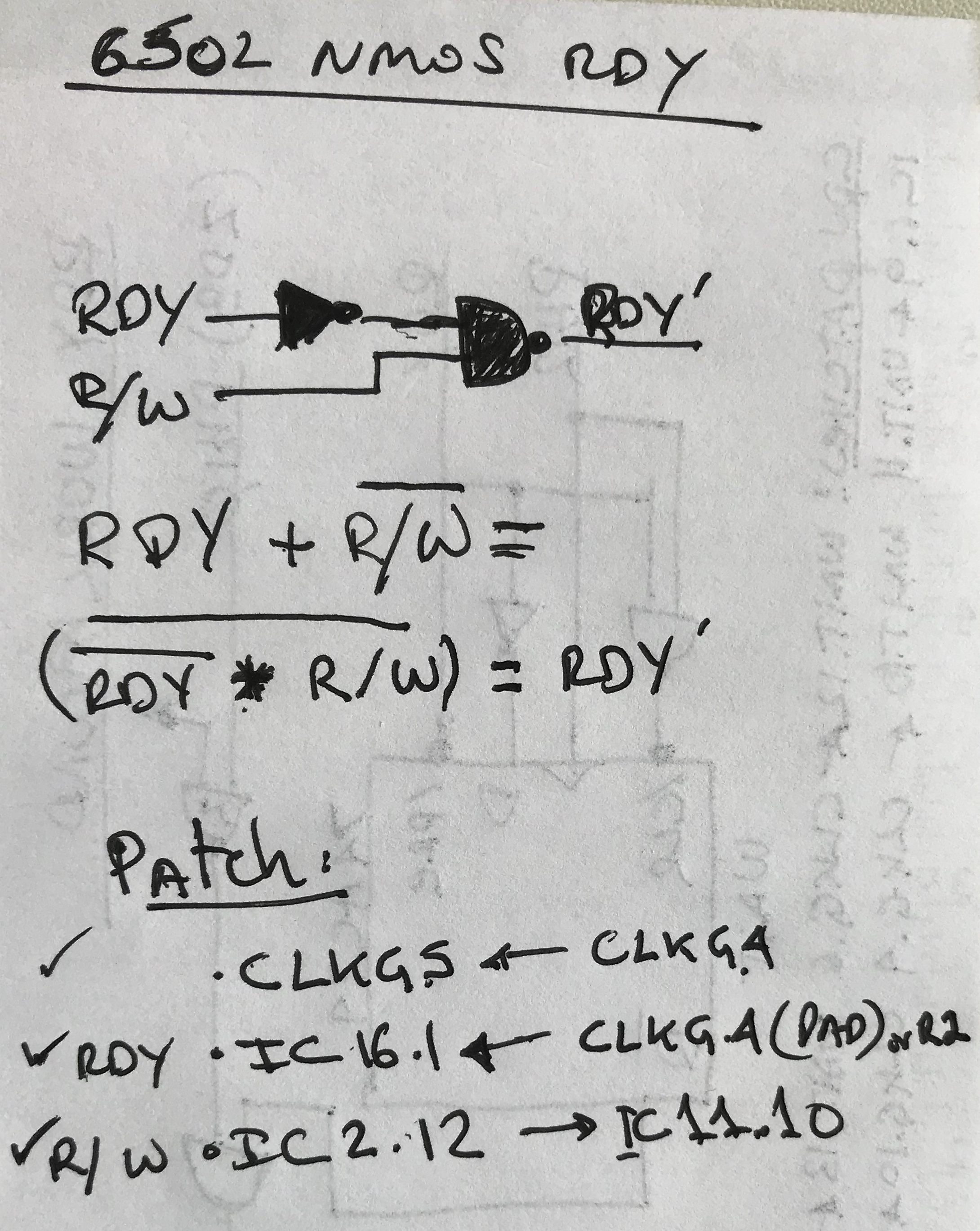

RDY is something that has to be fixed, so for sure it’s a great place to start:
There was an inverter/NAND combination on the board that I could use (previously used for STP), so the patch proved relatively painless. RDY’ above is the NMOS compatible signal — it stays high if R/W is low, which is what we want. In the final design, I’ll want to make the behaviour configurable, but a hard patch will do for now. A quick run with the Analyzer confirmed it works as expected.
But unfortunately, the problems are still there ... :(
