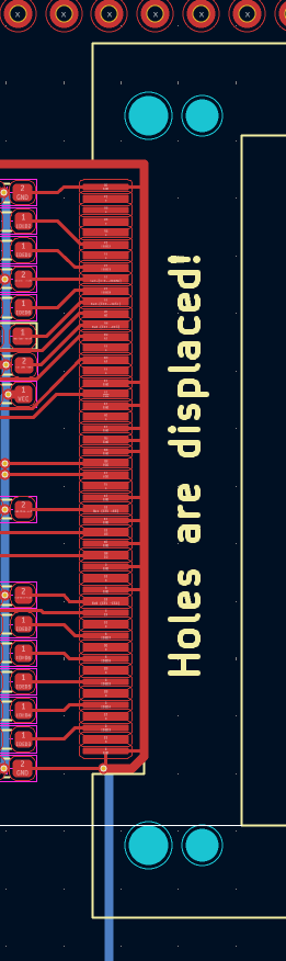

The PCBs arrived from JLC this morning. Imagine how much nicer they'd be if I'd got the pads on the CF connector in the right place... at the moment they're exactly 0.375mm offset to the north (on this view), one pitch centre. No matter, a rat-tail file will resolve the issue, I suspect.
Meanwhile, the antigravity version continues to proceed; I can read individual sectors so I'm recreating the stuff I did previously in C. Nothing to see yet, though.

Anyway, the board problems appear to be fixed (aka I am a idiot) so I'm starting to look at the 65c02 access stuff again.
