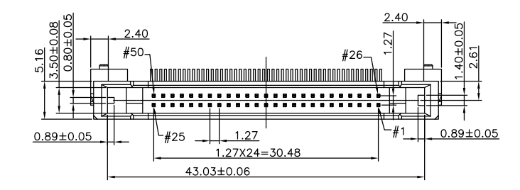

Compact flash pinout?
barnacle
Posts: 1831
Joined: 19 Jan 2004
Post by barnacle »
The internet, being the fount of all knowledge, offers two options.
Pins are numbered 1-25 on one row, and 26-50 on the other... but the question is, is the 1/26 end the end with the thin groove, or the thick groove.
https://en.wikibooks.org/wiki/Practical ... lash_cards suggests it's the thick groove, but https://connector.pinoutguide.com/50_pi ... sh_female/ suggests rather the opposite (without explicitly saying so!)
My test board is laid out with 1/26 at the thick groove, and I'm currently clutching at straws in the 'why doesn't it do anything' stakes... maybe it is indeed upside down.
Anyone got a working CF design that they can confirm with?

Or as a flash of inspiration suggests, is my footprint wrong in another way?
Looking _into_ the CF card sockets, top right is connected to what is referred to as pin 1 on the footprint... and I'm wondering if that ought to be pin 26 and I've got the rows swapped... that could answer a lot of questions!

Post by SamCoVT »
Looking into the CF socket (e.g. you are looking at pins, facing you, that you would plug the end of the CompactFlash card into), if the LARGER slot on the side of the CF card would go to your right, then I believe pin1 is lower right (based on socket pinouts from Hirose and Wurth connectors).
Ignore the fact that the socket is upside down in this drawing - you can get them in both "label up" and "label down" configurations. Instead, look at the skinny and wider polarity slots on the sides. This view is looking into the connector at the pins that you card will plug into.
Wurth Compact Flash Connector
Edited for spelling.

Post by barnacle »
Thanks Sam,
On my socket the wider slot is on the left looking into it from the card. That's t'other way up from your example, and so puts pin one top left, with a longer pin on the socket than most of the others (pin 13, pin 38, and pin 50 are also longer; pins 25 and 26 are shorter). It looks like the power pins are designed to connect first, then the normal pins, then the card detect pins last.
That's a bit depressing; I appear to have got the correct footprint. Looking into the _card_
  25 24 23                                                          3  2  1
| o  o  o  o  o  o  o  o  o  o  o  o  o  o  o  o  o  o  o  o  o  o  o  o  o |
=                                                                           [ (wide)
  50 49 48                                                          28 27 26
and that seems to be what my PCB is doing. Oh well, I'll try a reflow of the connection - it looks a bit rough - and then once more into the programming. Before I bolt this onto a 6502 I'm driving the control signals directly on my test PCB, so it's possible there's something screwy there.
edit: corrected pin numbering.
edit 2: corrected narrow and wide slot positions
