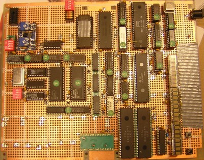

What a silence... Have even Yours ideas on how to continue dried up? Game Over? No, absolutely not. This thing just have to be made working, even if it will need some programmable logic for a clock sequencer, but I'm not there yet.
The ordinary way of doing it has worked for so many, so let's find out what is wrong here! Any comments to the schematic or the fact that the low indirect address byte is completely disregarded by the CPU?

Does the 65816 drive the data bus during phi2 high when in reset mode? I have tried to find something about this in the data sheet, but found nothing. I did beleive it was in tristate during that period during reset, but CPU and HC245 runs warm if left in reset.
Maybe the BE and /RESET should be connected together and a pull-up on R/W to preserve RAM during reset? The clock is running all time.
The JSR (ABS,X) problem still remains stuck where it was.

More important, there has been progress with the JSR. The apparent random low address is fetched from the intended 16-bit address, but from bank1...
That means the address latch captures a wrong level. It must happen when Phi2 goes from low to high. The Phi2 is buffered and I has already tried to take the latch signal before the buffer. No change except the bank address starts with a glitch. The latch was using it's own inverter during that test, making the latch a HC245 delay earlier relative both MPU and buffer.
Sh*t my disabilities prevents me from setting it up for a check with the scope. I almost lost balance and felt last time and don't want to take that risk again. That would have tell how the timing is and give a hint of what needs to be done. It would also reveal the highly unlikely case that the MPU is erraneously outputting a solid bank one address...
The whole thing feels magic. If bank address capture was marginal, it should have prevented it from running for days without locking up. The JMP (ABS,X) works flawlessly. According to data sheet, event sequence are the same, except for the stack writes that takes place two cyckles before the critical one.
Just this part of the design is made as the data sheet describes. Is WDC giving crap advices?

Marta
Posts: 42
Joined: 23 Feb 2005
Location: Sweden JO65kv
Re: AIM-65 homebuilt semi-replica
Post by Marta »
Thanks for the link.
I see that like there are concensus in the group that WDC's adviced circuit can be regarded as crap?
In the actual case it's a read cycle that fails. That means the MPU goes to hi-z after bank address. Then it must be the 245 that causes the latch to capture a bad value. But as mentioned before, it has been tested with a latch enable one 245 delay earlier with no result.
Next action will be to measure what is going on. I will rearange my crap ^H..^H devices so the scope can be left on the table. Would take a healthy person 20min, with my disabilities one or two days. Until then I make no changes. There will be some space on the card for one or two more sockets. That's the big advantage with wire wrap.
I also needs other scope probes. Noticed there was large variatins in the ringings whith my only hand holding around the connector. Chanses are the severe ringings are false and just the result of a broken probe.
Here are new schematics of the actual part of the design. More will come later with the ports and video.

Here comes the scope picture. An interrupt timer is running producing a 1kHz IRQ that does the JSR (ABS,X) into an area filled with $1A, that is the INC A instruction. The monitored signal is pin33, D0. 1µs/5V each square.
As can be clearly seen, there are two back to back cycles with a steady 1 level. This is impossible when executing that instruction from bank 0. My interpretation is that the CPU misbehaves.
I'm very surprised with the result. The only off-chip reasons I can think of is that it wants more dv/dt on PHI2. or an excessively noisy +5V. The power seems perfectly smooth on the scope and other people here does not seems to had problems with rise time, so what is going on???
Any comments, please?

Post by Marta »
The picture shows the last activity before a very long 0 level. It's taken with delayed time base and I'm very convinced it shows just the JSR (ABS,X). When I get one more working probe I will repeat the test with a marker by addressing one of the unused I/O-addresses in the instruction before. With that on the other channel there will be no doubts left.
Another MPU is also on order. Will be interesting to try that.
I belive it's the discarded cycle when adding the index internally, followed by reading the low address byte from the jump table, that goes into bank 1. There are no intentional addressing of that bank in the code, so in any case the first 500ns of each cycle have to be 0. All code is bank 0 and I/O is bank 8.
Assuming the measurment shows a JSR (ABS,X) executed in bank 0, what is Your conclusion?
