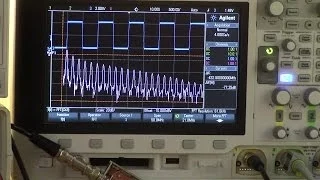

Here's a video on some aspects of high-speed digital circuits, specifically edge-rates, ringing, and termination, by Jack Ganssle, which kicks off by recommending a book, High Speed Digital Design by Johnson and Graham. Even secondhand, it's nearly £20, so it must be in demand.

Thankyou Ed! That part from about 2:20 to 3:00, about the ugly ringing regardless of clock speed, so perfectly illustrates a point we've been trying to make for a long time. (I've seen worse, BTW.) I've kept many of Jack Ganssle's articles from magazines like Embedded Systems Programming from years ago, but I didn't realize he had youtube videos (I should have figured), and now I need to check out ganssle.com. (BTW, the reflections happen due to a mismatch of the load and the transmission line, not particularly the source. He alludes to that in the next video, regarding probes, starting at about 5:30. When I worked in VHF & UHF, I had to get pretty cozy with the Smith chart which is primarily about transmission lines.)

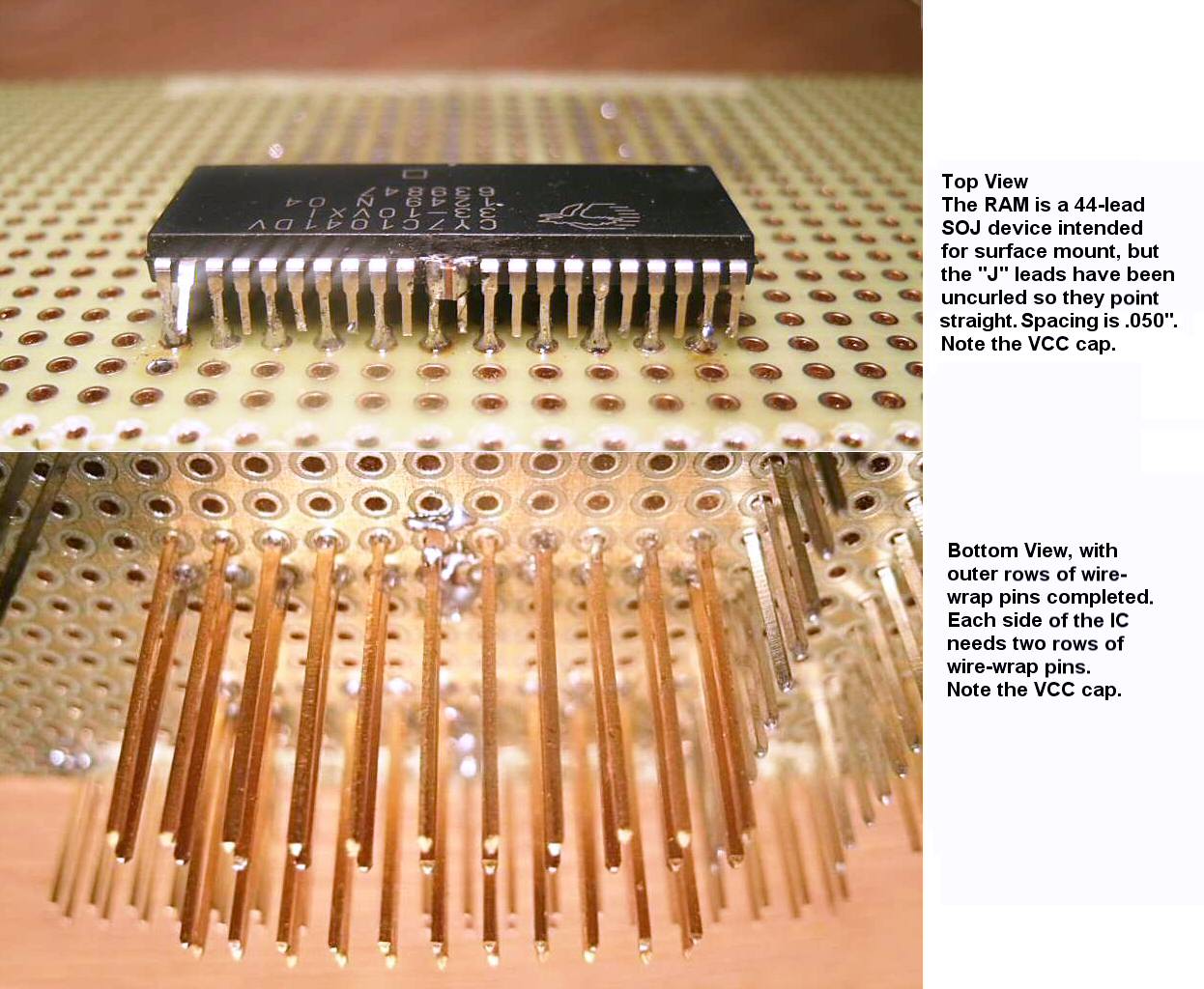

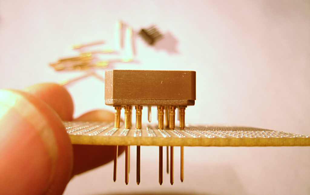

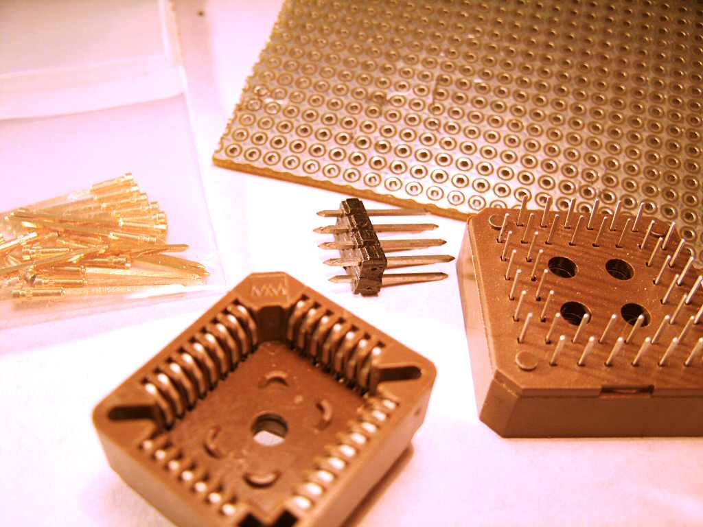

Ok, I took a picture of one of mine, a 44-pin, from Aries (although they no longer supply it):
It's no bigger than a standard thru-hole one.
[Edit, 1/21/13: BigEd just pointed us to a source that stocks them: http://uk.rs-online.com/web/c/?searchTe ... ra=oss&r=t ]

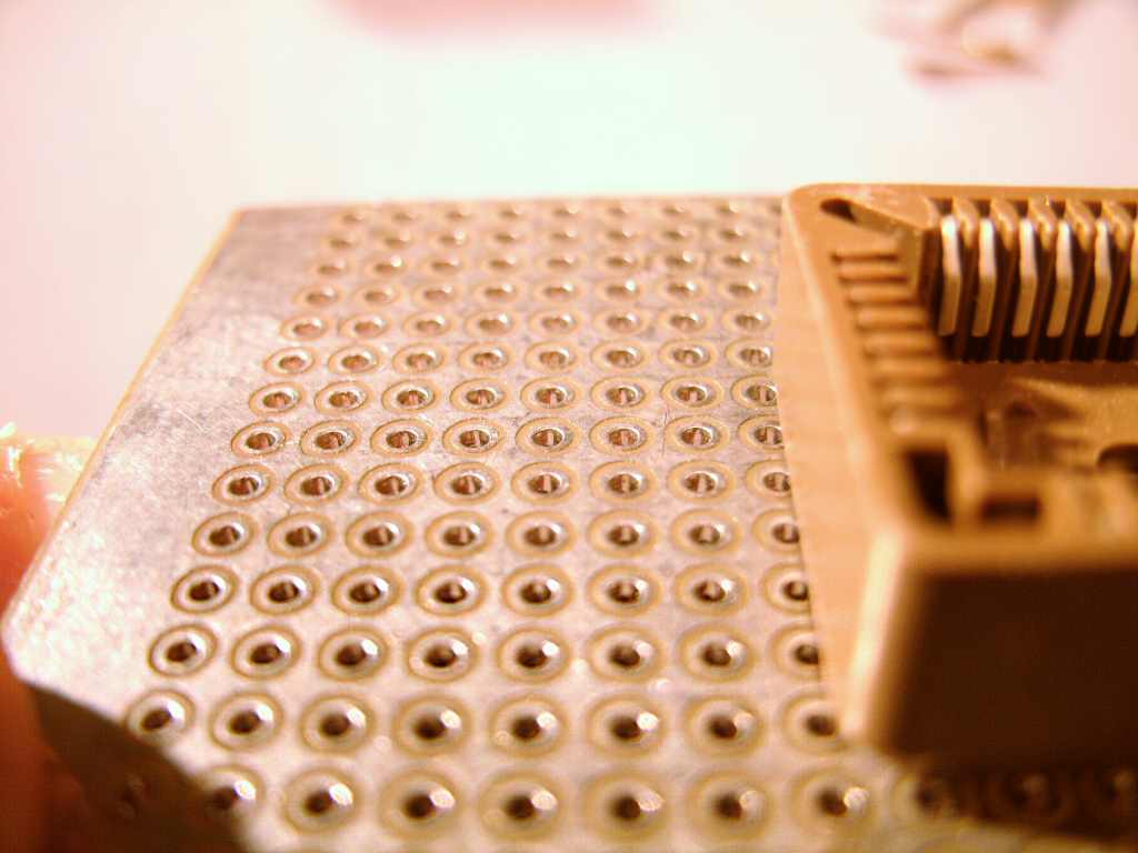

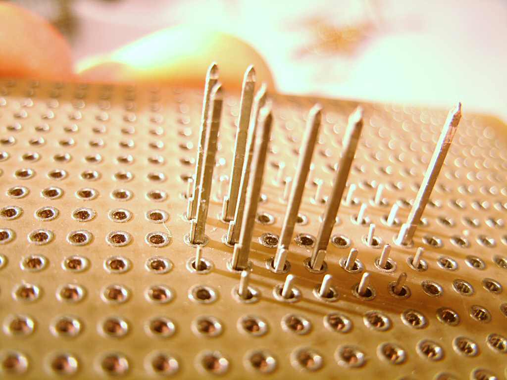

Be sure to use proto-board whose holes are plated through, as they offer better solder adhesion and thus more mechanical support. You don't want any pins twisting off during the wrap process. That could be tricky to fix if the neighboring pins are already wrapped and the region is congested with wire.
Finally, here's a top view of Plan B -- but what I want to draw attention to is the power plane surrounding the plate-through holes. Because there's no solder mask, the entire surface is susceptible to accidental shorts. All it takes is an errant shard of wire-warp wire or a tiny spatter of solder.
If your luck is bad, such a particle could lodge itself invisibly underneath the PLCC socket or some other component, and it would be impossible to detect and fix. I'm not a worrier by nature but I am uncomfortable with a power plane on the top (component side). The board in the photos is from Twin Industries, and they offer a double-sided power plane version as well. But I'll settle for a ground plane on the wiring side (bottom) only, where gravity isn't attracting debris, and where you have a better chance of seeing & correcting any trouble.
cheers,

I like plan B, because it makes for shorter connections (and therefore less inductance) from the planes to the IC.
When there's a possibility that's anything like that, you measure as you put each part on (in this case, the socket or a pin), so that if a problem shows up, you know it's at the part you did last. If you wait until you're done and admiring your handiwork to check and find a problem, you won't know where it is. I have to do this with the embedded bypass capacitors I put in my memory modules. Those embedded capacitors resulted in more manual labor than I bargained for, but I think they're still worth it (marginally).
Whether you use a single plane or double, solder a chip capacitor from each Vcc pin to the ground plane around it. It will have absolutely no lead length. That's the way we want it for best high-frequency behavior.
