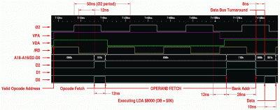

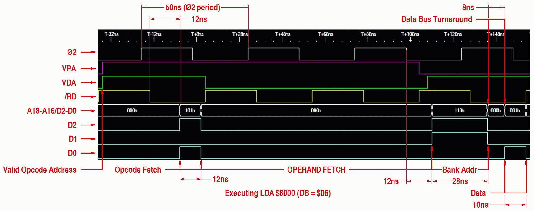

The problem is hard to trigger, so scoping isn't really much of a help.
I still suspect that there is a very tight timing involved and a some kind of noise or signal integrity issue which would otherwise pass unnoticed causes the problem. But I've been wrong before, and look forward to being wrong many more times in the future.
The SRAM itself is a 12ns part and there are only two gate delays between it and the address bus. Plus I was able to provoke the problem with Ø2 slowed down to 12.5 MHz. As everything is 74AC logic, mostly with single-digit prop times, I'm not seeing timing as the culprit. Also, when I got the unit running and clocked at 20 MHz, I had examined it with the logic analyzer (which has 2ns resolution) and could see that I had decent timing headroom.
POC RAM Read Timing @ 20 MHz
