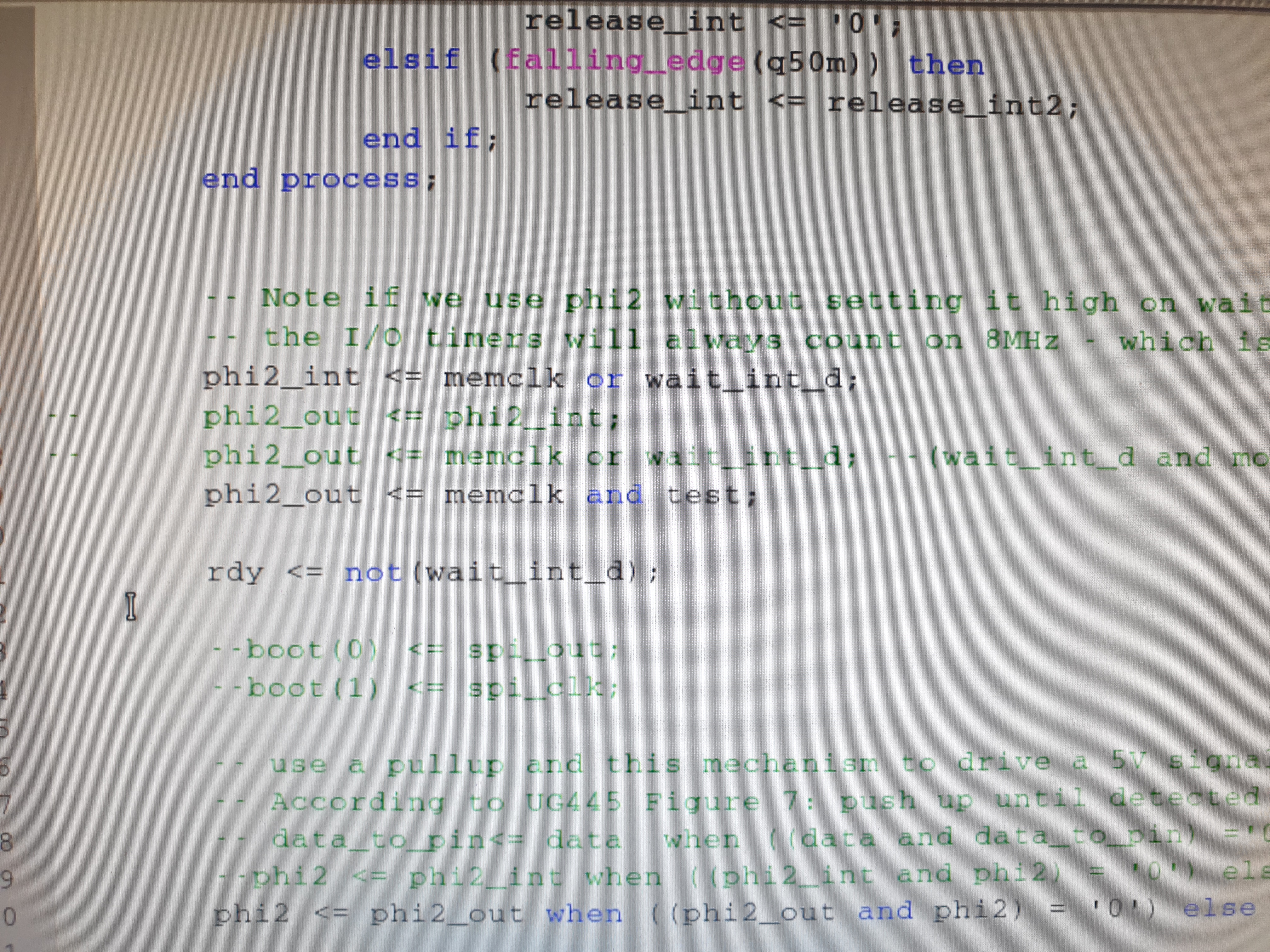

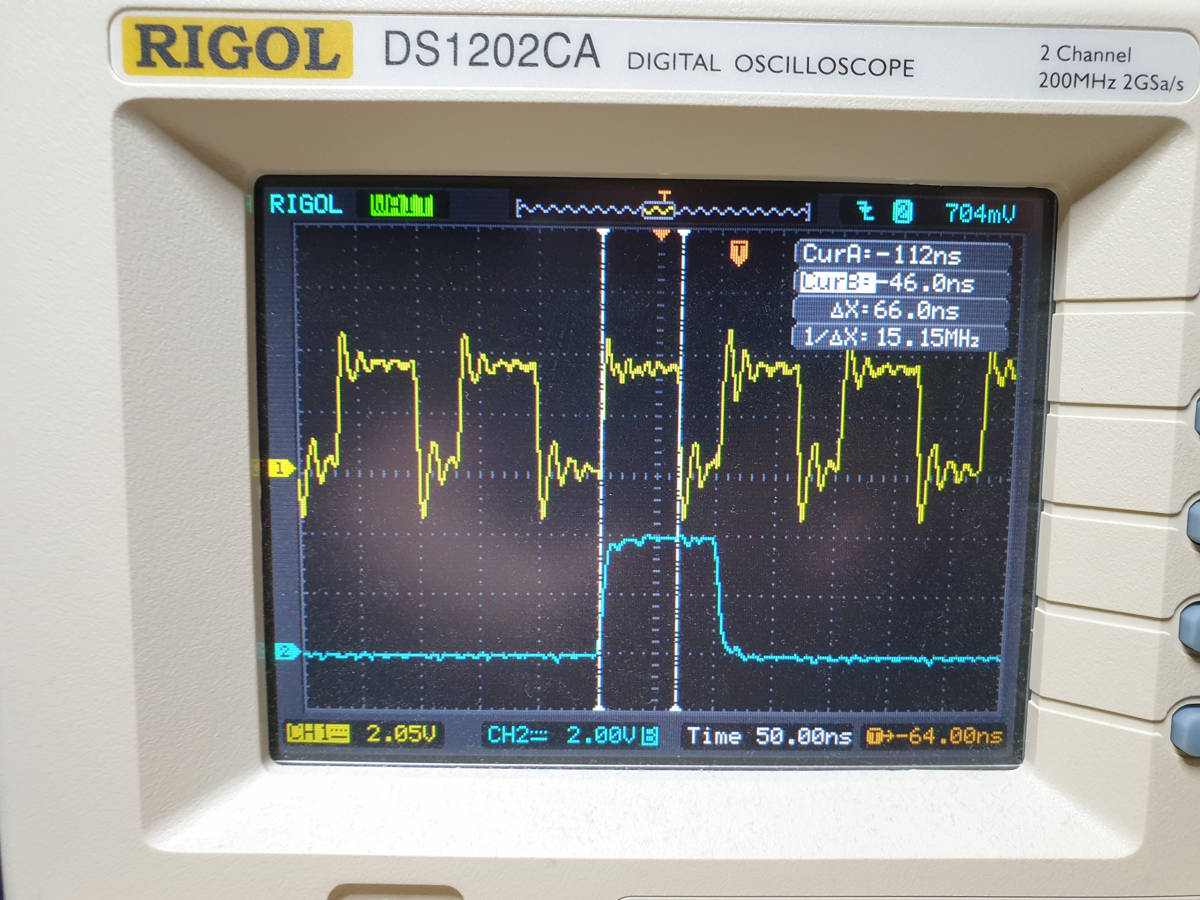

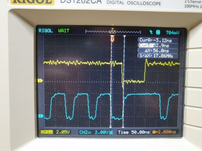

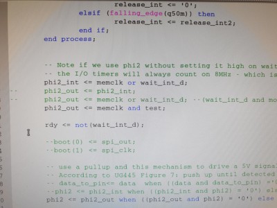

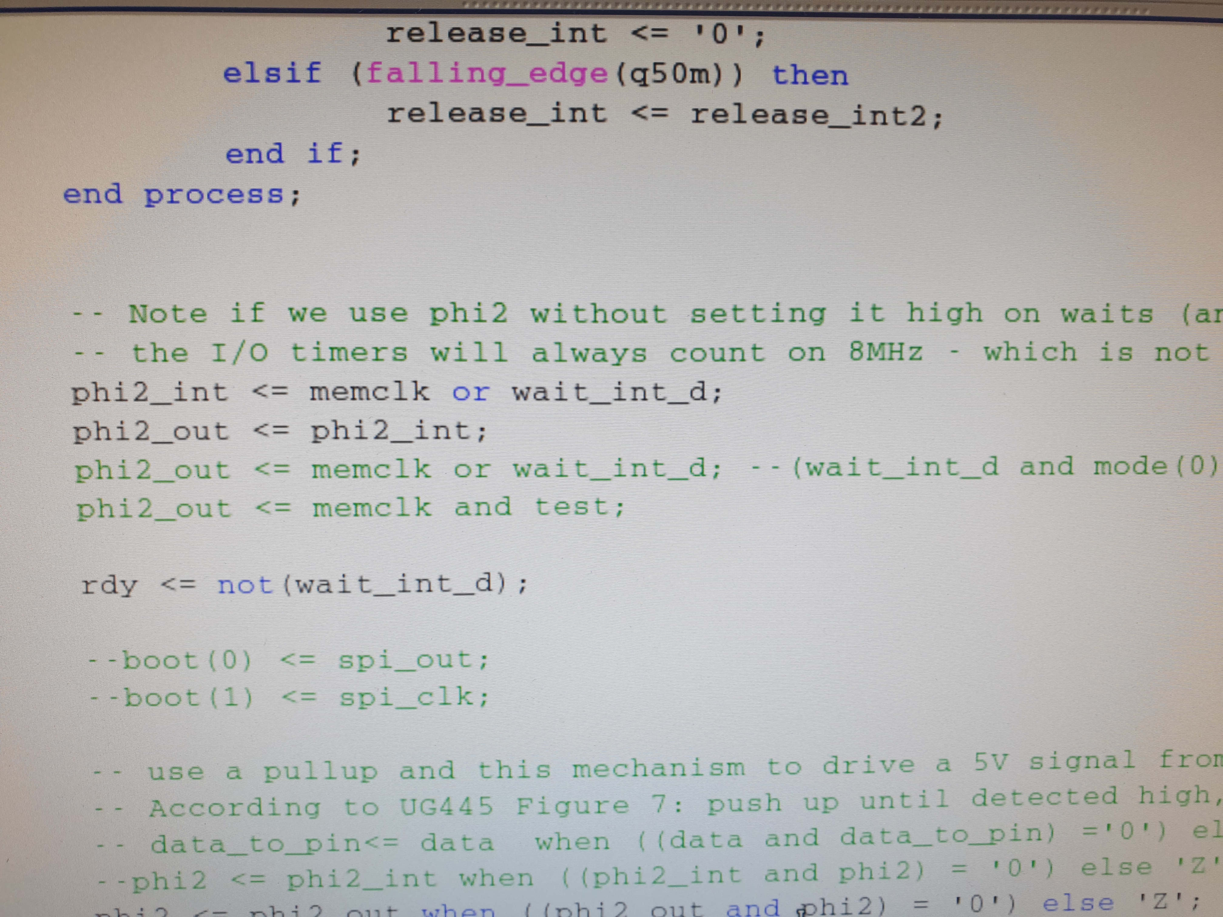

Hi there,
I have built my Micro PET and I wanted to switch from stretched phi2 clock to RDY-based wait states, so the VIA timers count a regular clock, not the stretched clock.
It runs fine with RDY output, and stretched clock - only when I switch stretched to normal clock, it stops working.
My assumptions / understanding from the datasheet:
- RDY is sampled shortly before the falling edge of Phi2
- My RDY is defined at the rising edge of phi2 when the access should be delayed, and released after the following rising edge of phi2 (in the code it's the inverted of wait_int_d)
- So RDY covers the fully Phi1
- When I stretch the clock, I simply OR phi2 with the inverted RDY (ie wait_int_d)
you can have a look at the attached screenshots of the code and the scope shots.
The change in "phi2_out" is the _only_ change, and phi2_out is _only_ used to create the phi2 output (while phi2_int is the stretched clock and is used internally for all the accessed)
Code is found on github: https://github.com/fachat/MicroPET/blob ... LD/Top.vhd
I am really running out of ideas. Any help is appreciated!
Thanks
André

Btw, some update. I still haven't got the RDY stuff working - most likely it needs a pull-up resistor similary to phi2 to create a good quality signal (interestingly the data bus that presents data read from memory does not seem to need this). I'll probably check that over the weekend if I get the time.
However, I managed to get the VIA timer running at proper speeds while the CPU is waiting for slow memory / read conflicts with video, using a split phi2 clock. I.e. CPU gets a stretched phi2, VIA gets a normal phi2.
I got the idea from your discussions, so thank you!
I am convinced that the 65C816's control inputs are CMOS-compatible, but the data bus is TTL-compatible. This is based upon my observations of my POC units, which use ROM and SRAM whose outputs are TTL-level. The current version of POC, V1.2, runs at 20 MHz using a 27C256 EPROM and an ISSI 128KB SRAM, both devices whose outputs are TTL-level. There are no pull-up resistors on the data bus. I doubt stable operation would be possible if the 65C816 insisted on having the data bus driven to CMOS levels.
PLDs generate TTL-level outputs, but RDY won't think it's at a logic 1 unless driven to around 4 volts minimum (per the data sheet—the threshold seems to be around 3.6-3.7). BTW, don't forget RDY is bi-directional and should not be solidly driven to Vcc at any time. A series Schottky diode and pull-up will assure proper operation.
Indeed that seems to be the case. Using a pull-up and the same logic as used with Phi2 on RDY work to run the CPU with 1 MHz, on an 8MHz phi2, with slowdown using RDY. (as explained above, CPLD pulls up (fast) until it notes the input of the same signal as high, then goes high-Z and let the pull-up do the rest. Looking at the scope also reduces ringing considerably)
Good point. I think I will be going with stretched / split clock here, and consider RDY as in output signal of the CPU only, to avoid any hassle (and reduce number of parts, pull-up and diode as you mention).
