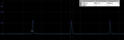

Hi all,
Typically you set Address first, then CE and OE. Then ROMs work as planned (with MCU for example). In this setup, OE and CE are always enabled so it is not natural that addresses are changed on the fly. This is something I checked on scope almost right after I had the setup ready.
This is what the output of EEPROM looks like when HC163 is calculating:
I was expecting spikes but not that strong.
With 138&139 I noticed that there is a slight time difference in practice. In 1-2MHz range, it has absolutely no meaning tho.
That's why I was curious to know how AC performs in the same place. (Also, there are different access times in EEPROMs used so the result is not directly comparable).
Axel.
