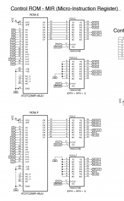

Ax2013 wrote:
Drass, just curious: have you noticed switching spikes between phase (Q0-Q4?) changes in ROM E and ROM F outputs?
Hi Axel,
ROM E and ROM F reside on the K24 Card, which I've yet to build. However, the same circuits are present for the Microcode ROMs on all the cards. Like this:
In each case there is a 74AC574 Microcode Instruction Register ("MIR") at the outputs of the ROMs to capture the values of control signals - this is part of the microcode pipeline implementation. There are no other "drivers" to conflict with the ROM outputs so I would expect smooth operation on these lines. I can't confirm that without an scope though. Curious if you're seeing something that might suggest a problem.
Interestingly, I do expect spikes at the outputs of the MIR when switching between MIR and MIR2. This happens in two instances: (1) when adjusting the high byte of an indirect address, and (2) when a branch is NOT taken. The outputs of both MIR and MIR2 drive a common control bus, so we can anticipate collisions and spikes on every switch - this is something I wish I had taken the time to correct!
The design manages to partially mitigate these collision in the first instance above by arranging the microcode to change only 2 of the 32 bits in the control bus when the switch occurs. No such luck in the second instance. In one critical-path operation, however, control signals are "pre-set" in the MIR from one micro-instruction to the next, which in effect provides a "pre-decode" function. It's one of those "get to 20MHz" contortions to squeeze a few nanoseconds out of the critical-path.

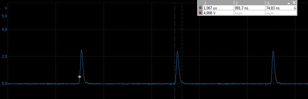

Joined: Thu Jul 27, 2017 7:48 pm
Posts: 68
Hi all,
Typically you set Address first, then CE and OE. Then ROMs work as planned (with MCU for example). In this setup, OE and CE are always enabled so it is not natural that addresses are changed on the fly. This is something I checked on scope almost right after I had the setup ready.
This is what the output of EEPROM looks like when HC163 is calculating:
I was expecting spikes but not that strong.
With 138&139 I noticed that there is a slight time difference in practice. In 1-2MHz range, it has absolutely no meaning tho.
That's why I was curious to know how AC performs in the same place. (Also, there are different access times in EEPROMs used so the result is not directly comparable).
Axel.
