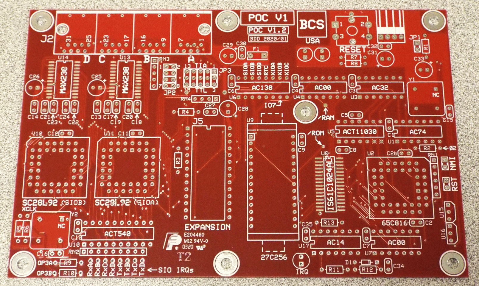

POC V1.2 is assembled.
PCB Component Side
PCB Component Side
PCB Solder Side
PCB Solder Side
Above are photos of the bare PCB. For some unfathomable reason, I decided to get red boards this time. It wasn't a good idea, as the relatively bright color gave me some grief in trying to place and solder comoponents.
