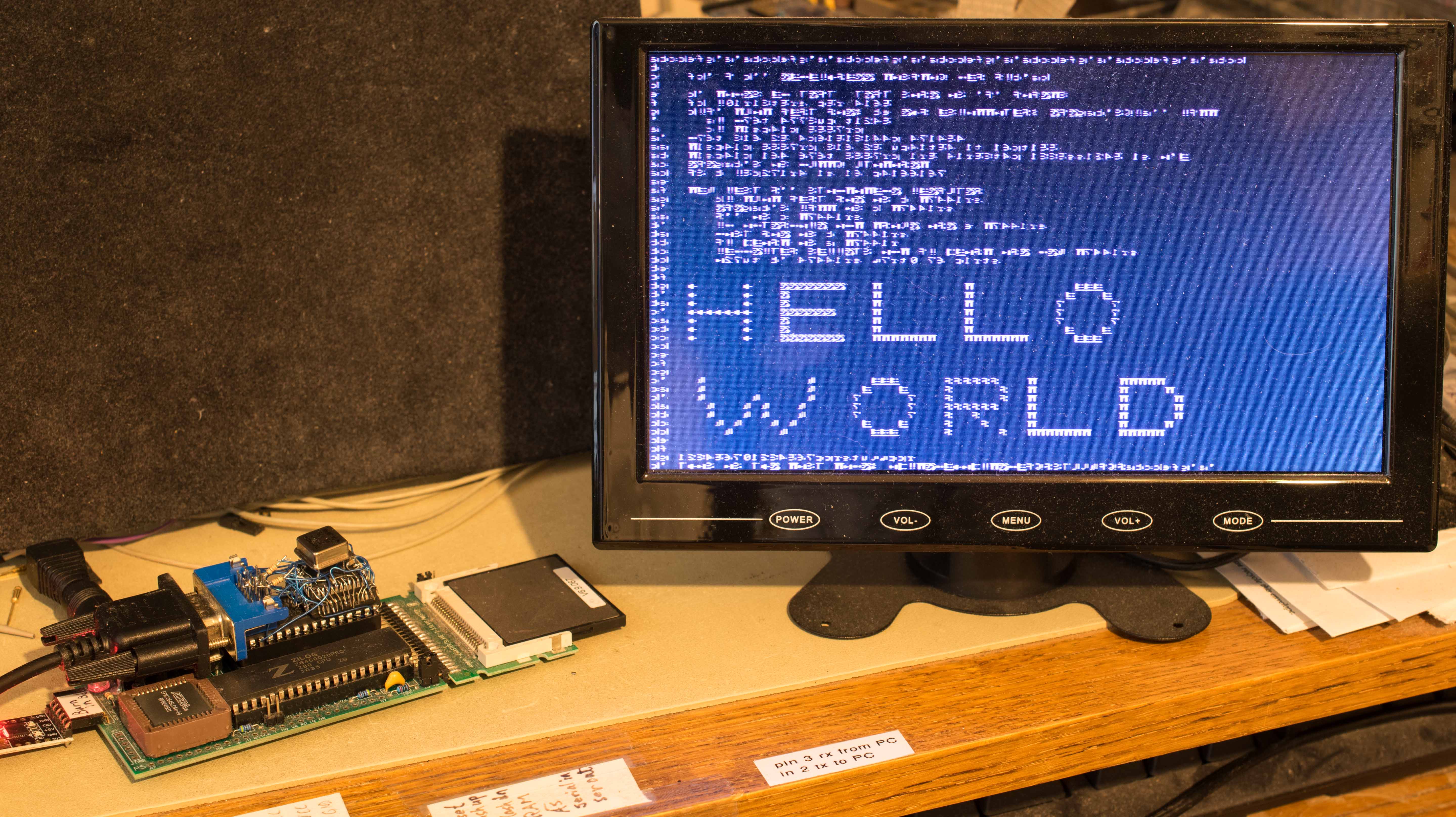

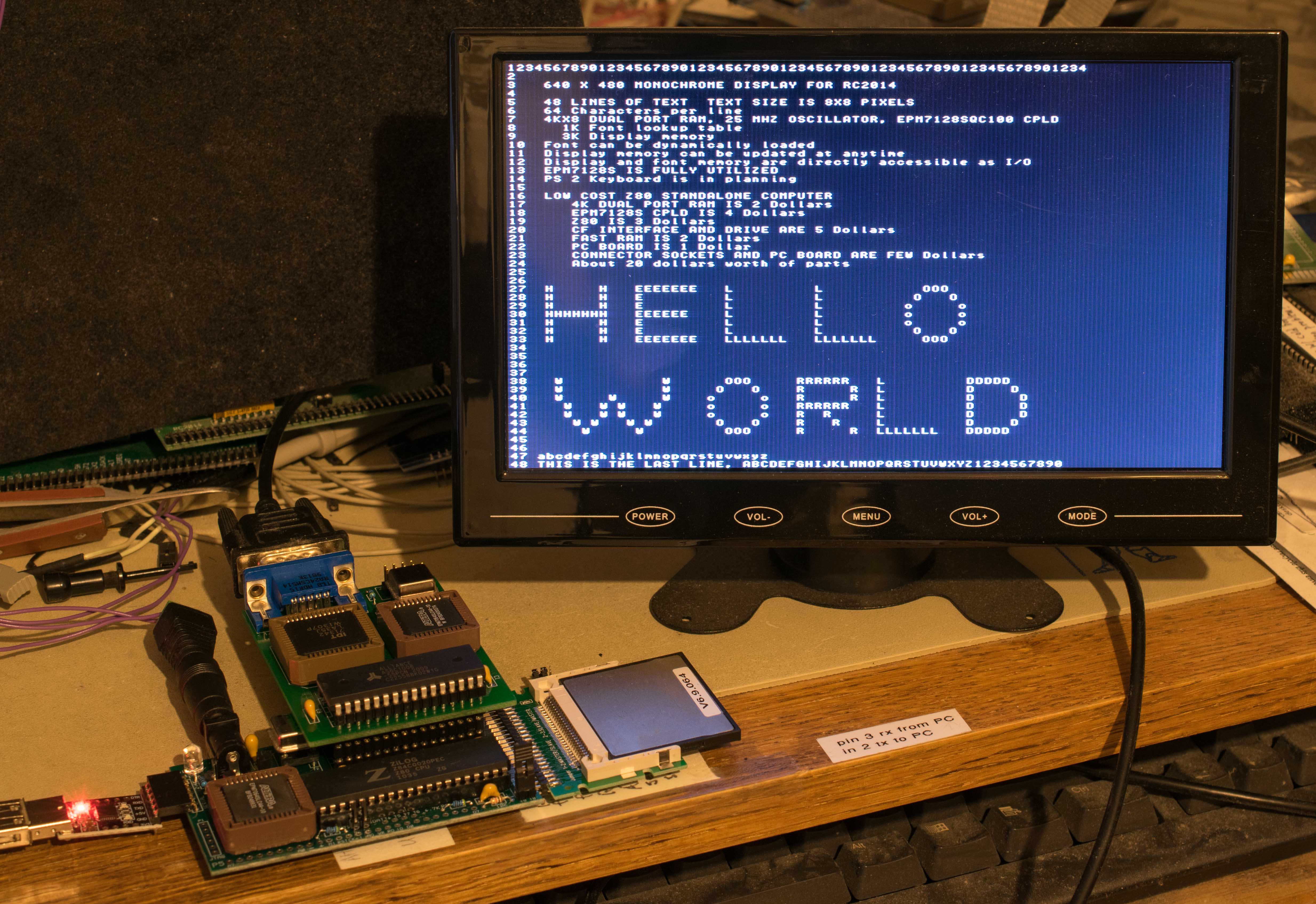

The test program is 4K of initialization data for the block of memory from 0xA000-0xAFFF where 0xA000-0xABFF are screen texts and 0xAC00-0xAFFF are font tables for the 128 characters; each character is 8x8 pixels so each character requires 8 bytes of fonts. Attached is the initialization data file; and the attached picture shows what is displayed when the initialization data is loaded into memory. At first glance it looks good; the lines of text are displayed correctly, BUT look at the texts closely, they are all gibberish. I know from previous designs that the font tables are correct so the gibberish texts must be because of wiring mistakes. However, after looking at the connections under inspection microscope carefully, I can not find any wiring mistakes.
After digging around a bit more, I realized RAM data connections on ZRCC SBC are scrambled to make them easier to route. RAM's data and addresses pins can be reassigned to simplify board layout but that'll mess up the VGA display unless I also reassign the CPLD's address/data pins to match. This is an interesting wrinkle in the piggyback VGA design where signal assignments of the RAM expansion socket must be clearly defined. Changing the CPLD pin assignments are do-able, except the JTAG programming signals are not connected on the prototype. So I'm going back to the bench trying to add 6 wires to the CPLD...except I have too much caffeine already; I'll rest up and let the caffeine wears off before tackling that task in the morning.
PS, @Dr. J, yes, the VGA socket is glued to the RAM chip with a few drops of super glue. It is holding for now, but I do hold on to the connector while inserting or extracting the VGA cable.

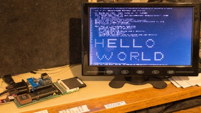

Re: VGA6448, text-based VGA in ATF1504AS CPLD
Attached 4 JTAG signals to the CPLD and I'm able to reprogram the CPLD with data bus pin assignments to match that of ZRCC RAM. With that fix, the display is working properly. I also attach the CPLD schematic.
My sprained ankle is also mostly fixed, so it is back to gardening.

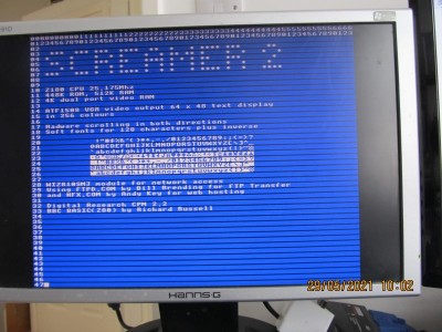

With a 128 macrocell ATF1508AS CPLD dedicated to just handling the video, I was able to fit in colour and scroll registers as well as 8 bit RRRGGBBB output.
The VDHL is attached for anyone who wants to look at it. It's probably not the best code in the world, but it gets the job done NB Version 1 was 6bit colour, I figured the 2 extra bits of output was worth a major version number upgrade

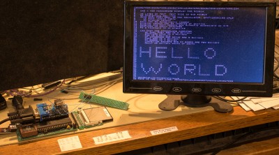

I designed a pc board for the piggybacked VGA prototype. Picture shows it plugged into ZRCC's 128KB RAM socket and drove a 9" VGA monitor. Design information for the pc board is here.
Very cool, indeed. That mess of wires that was your prototype cleaned up very nicely.
