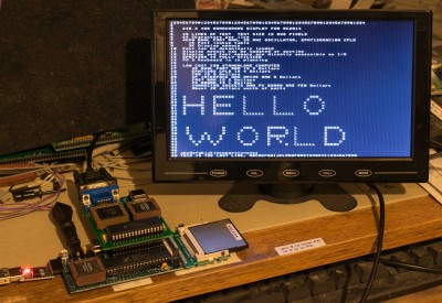

The test program is 4K of initialization data for the block of memory from 0xA000-0xAFFF where 0xA000-0xABFF are screen texts and 0xAC00-0xAFFF are font tables for the 128 characters; each character is 8x8 pixels so each character requires 8 bytes of fonts. Attached is the initialization data file; and the attached picture shows what is displayed when the initialization data is loaded into memory. At first glance it looks good; the lines of text are displayed correctly, BUT look at the texts closely, they are all gibberish. I know from previous designs that the font tables are correct so the gibberish texts must be because of wiring mistakes. However, after looking at the connections under inspection microscope carefully, I can not find any wiring mistakes.
After digging around a bit more, I realized RAM data connections on ZRCC SBC are scrambled to make them easier to route. RAM's data and addresses pins can be reassigned to simplify board layout but that'll mess up the VGA display unless I also reassign the CPLD's address/data pins to match. This is an interesting wrinkle in the piggyback VGA design where signal assignments of the RAM expansion socket must be clearly defined. Changing the CPLD pin assignments are do-able, except the JTAG programming signals are not connected on the prototype. So I'm going back to the bench trying to add 6 wires to the CPLD...except I have too much caffeine already; I'll rest up and let the caffeine wears off before tackling that task in the morning.
PS, @Dr. J, yes, the VGA socket is glued to the RAM chip with a few drops of super glue. It is holding for now, but I do hold on to the connector while inserting or extracting the VGA cable.

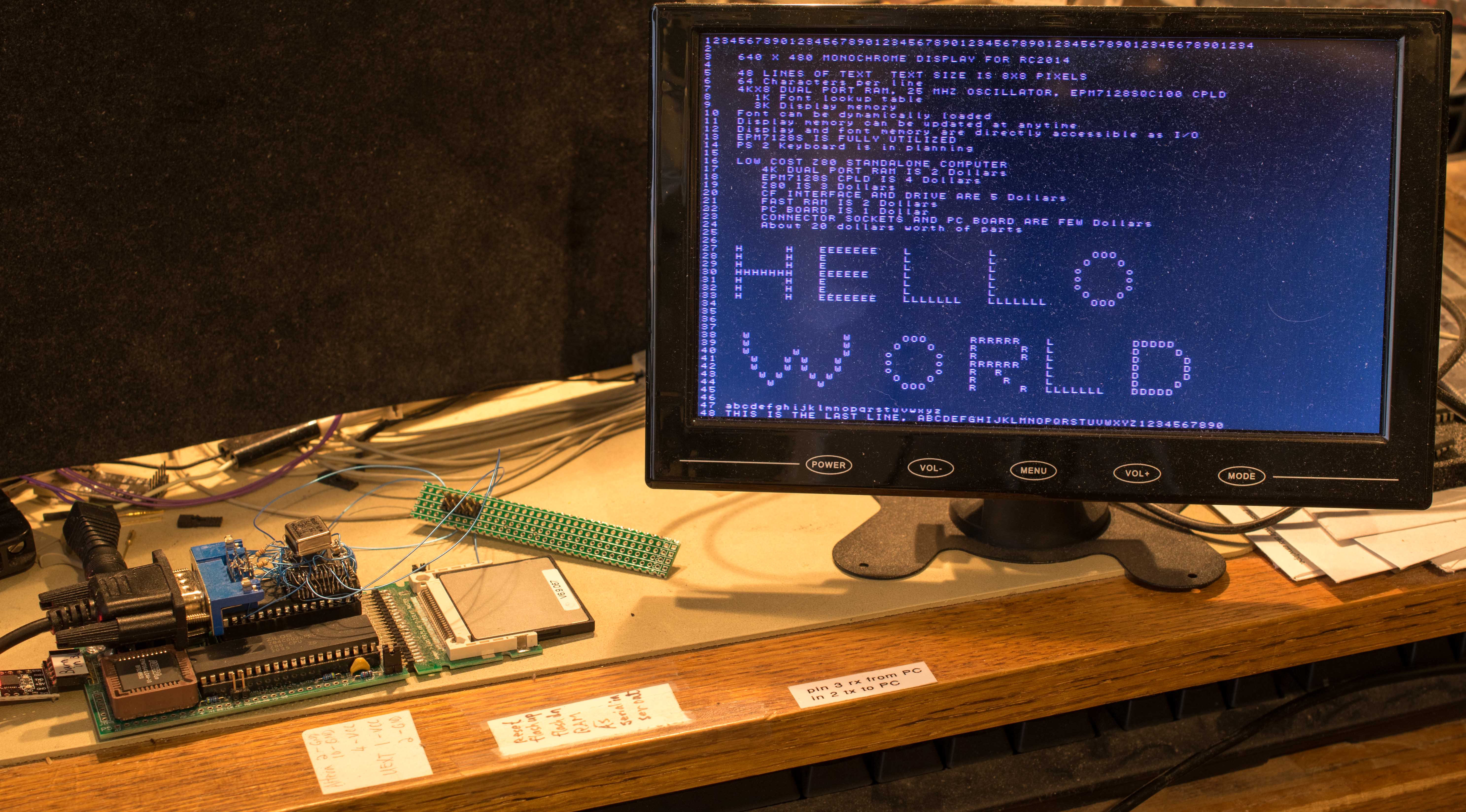

Attached 4 JTAG signals to the CPLD and I'm able to reprogram the CPLD with data bus pin assignments to match that of ZRCC RAM. With that fix, the display is working properly. I also attach the CPLD schematic.
My sprained ankle is also mostly fixed, so it is back to gardening.

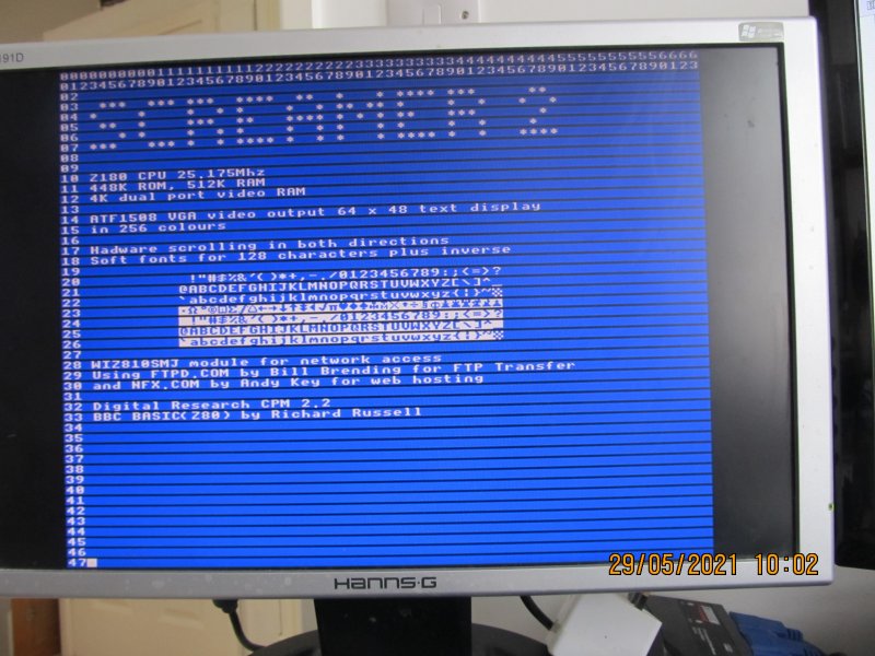

So, I've been watching this with interest, and had a go at building one myself, though not in the "stacked" format.
I hesitated to post my "interpretation" as I too matched it to a Zilog CPU. In my case a Z180, as the 33mhz version is "perfect" for running off the VGA clock to reduce the component count. The Z180's built in MMU making it possible to move the display ram in and out of visible memory as required to allow 64K RAM for CPM.
With a 128 macrocell ATF1508AS CPLD dedicated to just handling the video, I was able to fit in colour and scroll registers as well as 8 bit RRRGGBBB output.
File comment: Demo screen drawn in BBC BASIC using a BBC like soft font.
The VDHL is attached for anyone who wants to look at it. It's probably not the best code in the world, but it gets the job done

NB Version 1 was 6bit colour, I figured the 2 extra bits of output was worth a major version number upgrade :).

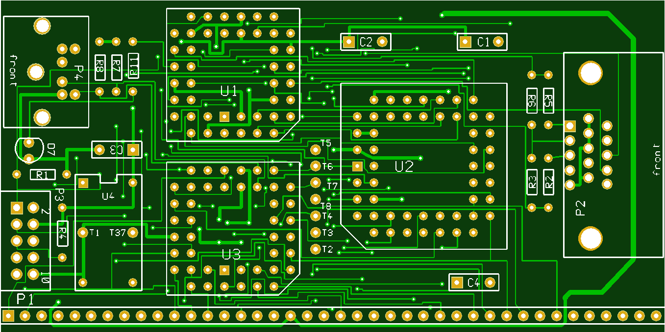

I designed a pc board for the piggybacked VGA prototype. Picture shows it plugged into ZRCC's 128KB RAM socket and drove a 9" VGA monitor. Design information for the pc board is here.

PostPosted: Mon Jun 21, 2021 12:33 am
Posts: 760
Location: Huntsville, AL
Very cool, indeed. That mess of wires that was your prototype cleaned up very nicely.
