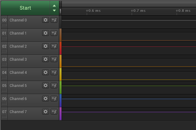

I just analyse the SYNC. In every address I have used ($ E5, $ EA) it is always high. What can this mean? Malfunction of the processor?
Re: Writing in EEPROM and reading by 6502
It means that your CPU is executing 1-cycle NOPs. The reason why, we have not yet determined - but an outright faulty CPU is not very likely.
It's much more likely that something is wrong with your data bus. I suggest checking not only for continuity between pins of the EEPROM and the corresponding pins of the CPU, but for shorts between adjacent wires. Especially between D0 and D1.

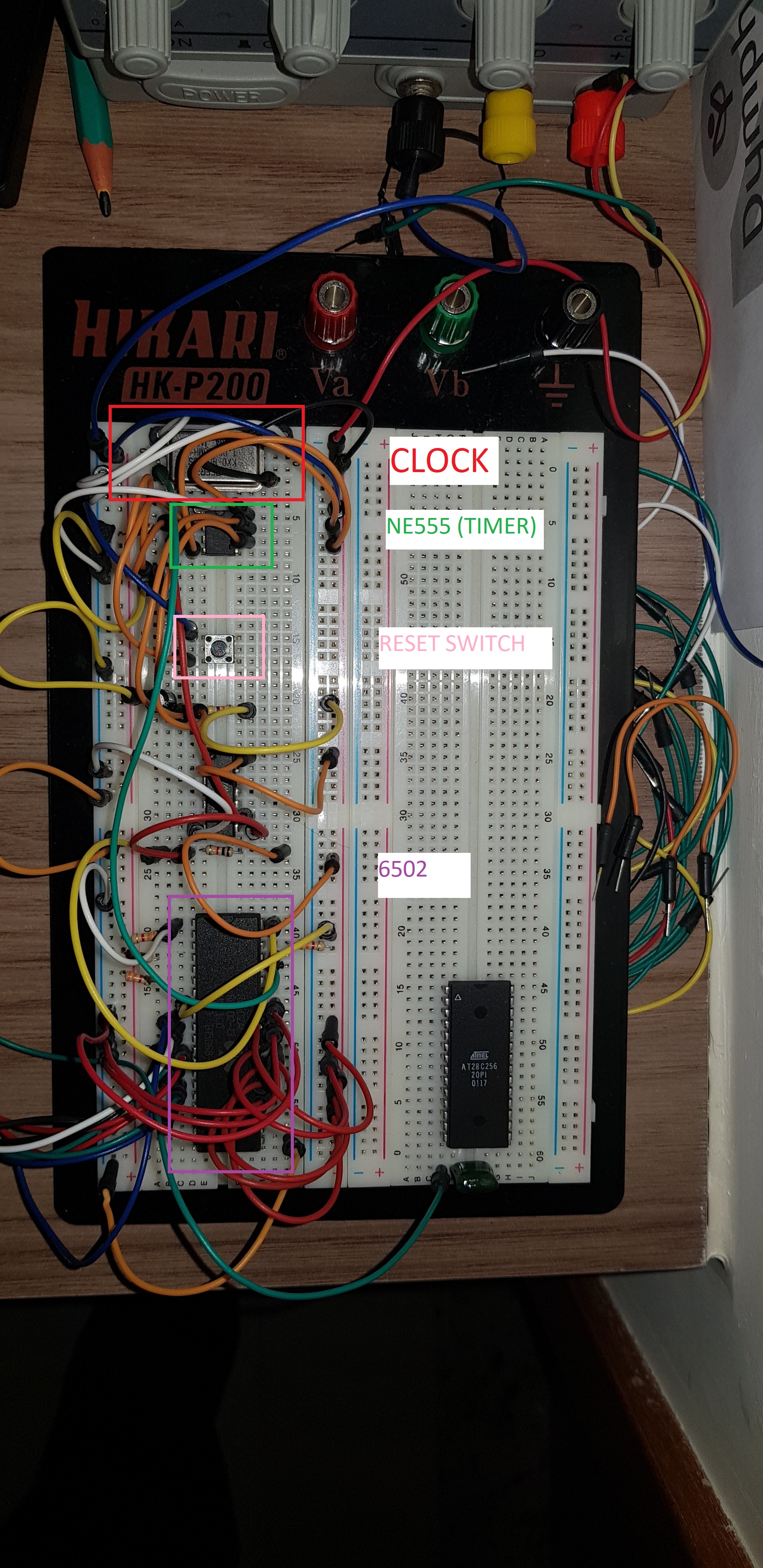

Can you post a photo of your project, please? Also, you haven't told us what sort of CPU you are using. Remember we can only help based on the information you provide! Please try to tell us as much as possible.
There are several possibilities. For example, it's possible your observation is incorrect, and SYNC is *not* always high. This can be the result of a misunderstanding with your instruments -- which is something that can happen to anyone. Maybe you can use a different method or a different instrument to verify the SYNC observation -- that's what I would do if it happened to me.

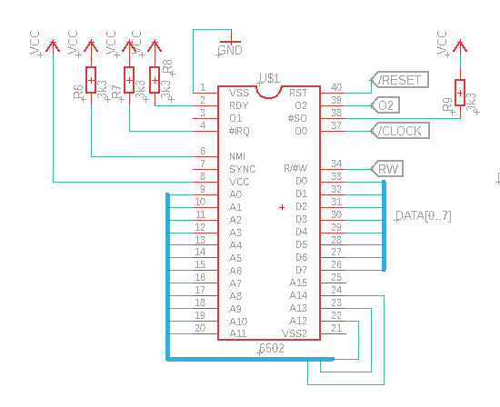

Well, I'm going to put all the documentation I've done so far about my project. The first component is the clock running the 1 MHz frequency through the Kyocera KO-43B. The analysis of the wave in the oscillator is correct generating the desired frequency.

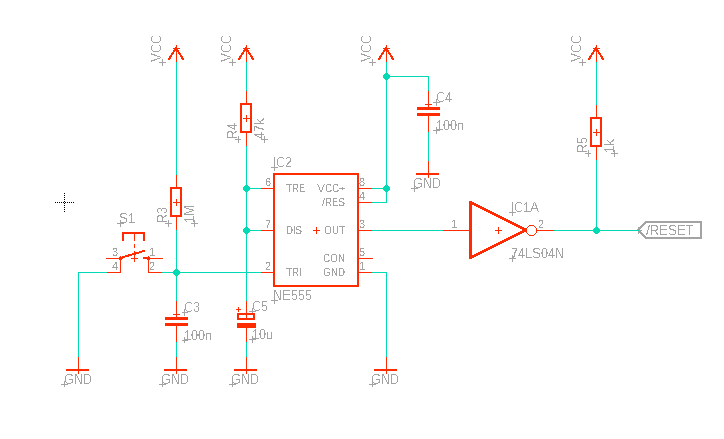

After the clock, I have a timer circuit with reset button. When the button is pressed, it takes a few seconds to return to normal. I use the NE555 as shown in the diagram.
Finally I turn on the 6502 clock, reset and VCC. For the RDY, IRQ, NMI and SO pins I connected directly to the VCC with 3k3 resistor.
I started using EEPROM, but I took a few steps back to ensure that simple code execution is correct. But the NOP does not consume the two clock cycles as it should.
Did I do something wrong? If you need more information, I can put it.

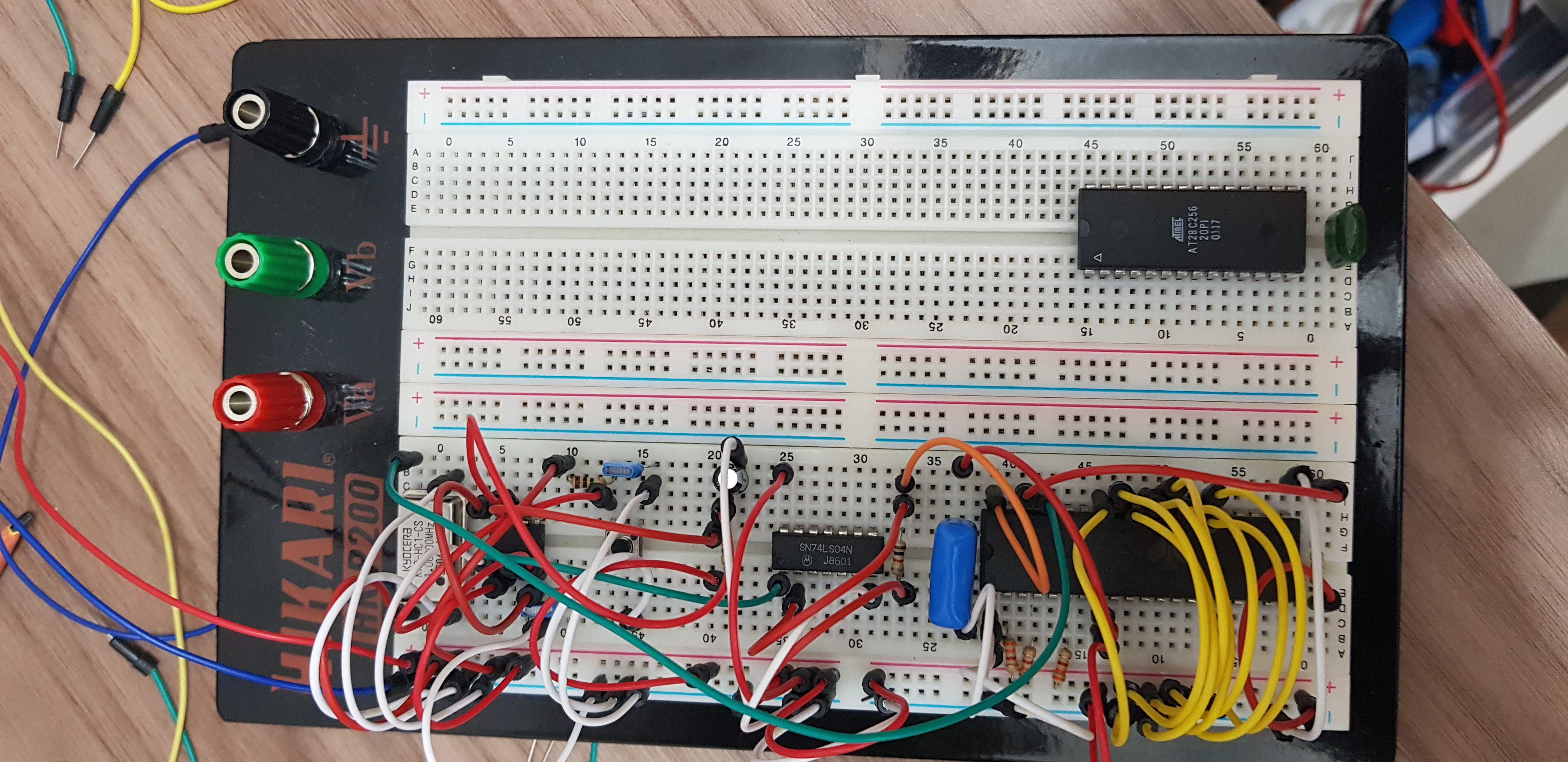

Okay, so in that photo you have a Rockwell CPU (looks like R6502AP, which is an NMOS device, not a CMOS one) wired up for $EA NOPs, and your logic analyser attached to the low-order address lines. You have an oscillator and a reset controller. RDY, /NMI and /IRQ are pulled high.
Concerns:
1: You appear to have hardwired A15 to Vcc, just "south" of the eight data pins. A15 is an *output* from the CPU and should never be directly connected to a power bus.
2: I don't see any power bypass capacitors anywhere. Prototype boards need them even more than PCBs do. Without them, expect ground bounce to induce spurious transitions on critical inputs such as the clock.

I turned off the entire circuit and called again to make sure nothing was wrong. I put the capacitors, I believe in the right places. But the behavior remains the same. The A0 remains with 500 KHz cycle. I do not know what this problem can be anymore.

Is the reset circuit working? If you hold reset low, the 6502 will have some bus activity, but it won't be executing instructions.
