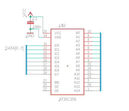

Well, I'm going to put all the documentation I've done so far about my project. The first component is the clock running the 1 MHz frequency through the Kyocera KO-43B. The analysis of the wave in the oscillator is correct generating the desired frequency.
After the clock, I have a timer circuit with reset button. When the button is pressed, it takes a few seconds to return to normal. I use the NE555 as shown in the diagram.
Finally I turn on the 6502 clock, reset and VCC. For the RDY, IRQ, NMI and SO pins I connected directly to the VCC with 3k3 resistor.
I started using EEPROM, but I took a few steps back to ensure that simple code execution is correct. But the NOP does not consume the two clock cycles as it should.
Did I do something wrong? If you need more information, I can put it.
Thank you so much guys.
Transparency: I use the grappendorf website as a source of information.
EEPROM
EEPROM
6502
6502
Reset
Reset
Clock
Clock
Protoboard
Protoboard

Okay, so in that photo you have a Rockwell CPU (looks like R6502AP, which is an NMOS device, not a CMOS one) wired up for $EA NOPs, and your logic analyser attached to the low-order address lines. You have an oscillator and a reset controller. RDY, /NMI and /IRQ are pulled high.
Concerns:
1: You appear to have hardwired A15 to Vcc, just "south" of the eight data pins. A15 is an *output* from the CPU and should never be directly connected to a power bus.
2: I don't see any power bypass capacitors anywhere. Prototype boards need them even more than PCBs do. Without them, expect ground bounce to induce spurious transitions on critical inputs such as the clock.

Hi Chromatix,
I turned off the entire circuit and called again to make sure nothing was wrong. I put the capacitors, I believe in the right places. But the behavior remains the same. The A0 remains with 500 KHz cycle. I do not know what this problem can be anymore. :-(
