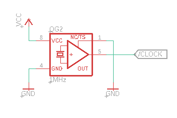

Well, I'm going to put all the documentation I've done so far about my project. The first component is the clock running the 1 MHz frequency through the Kyocera KO-43B. The analysis of the wave in the oscillator is correct generating the desired frequency.
File comment: 6502
File comment: Reset
File comment: Clock
