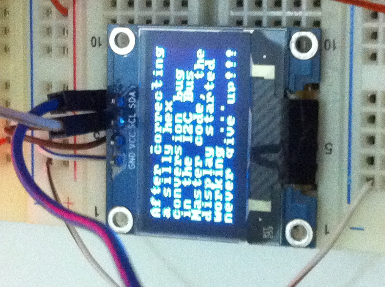

As mentioned in one of the previous posts, the QBX talks to the ATTiny85 via the UART0 by sending I2C ASCII/HEX command sequences. This implementation is kept very generic, and the code running on the QBX 'has to know' the bytes to write and to read.
To give an example, let's write a capital 'A' to the top left corner of the screen. This can be done by letting the QBX send two I2C write commands via UART0 to the ATTiny85 I2C Bus Master:
I2C3C0400000010B0
I2C3C090040007C7E13137E7C00
The ASCII/HEX format had been chosen for ease of debugging and testing. I wrote a monitor extension routine, which lets me input sequences like these, in order to communicate with the I2C devices on the bus.
Breakdown of the first command sequence:
I2C3C0400000010B0
I2C   command prefix
3C    I2C device address
04    number of bytes to write
00    number of bytes to read (from the device after write is complete)
00    data byte 1
00    data byte 2
10    data byte 3
B0    data byte 4
The SSD1306 does not have a built-in character ROM, so one has to transmit 8 bytes of bitmap data in order to display a character on screen. The second sequence does basically that where the first sets the current write (cursor) position. Further details in the data sheet.
For non time critical stuff this approach works quite satisfactory, since one can plug additional I2C modules on the bus and talk to them right through the monitor.
For the display, I converted the character map data from a monochrome bitmap font I found on gitHub (https://github.com/dhepper/font8x8/blob ... x8_basic.h) and swapping the bits into the column oriented format required for the SSD1306. After writing still some crude display routines and a monitor extension for char based text input and then printing it on the display.
All that stuff is growing really fast, summing up already 6k (code and data) in memory.
Here is what the result looks like:
Happy breadboarding ;-)

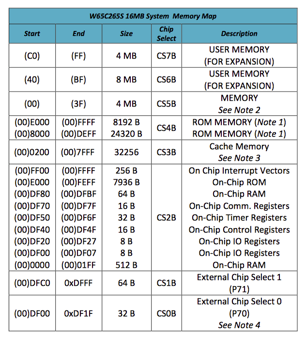

this weekend I am planning to add one of my W65C21S Peripheral Interface Adapter to my breadboard assembly.
I am not sure about the required logic for the three chips RAM, ROM (currently NVRAM) and the PIA to play nicely together.
I came up with the following idea, which would require 3 auxiliary logic chips I have in stock.
What do you think ... could that work?
Regards.

A more detailed I/O memory map would be nice. The information you've given doesn't really tell enough to determine if your logic is completely correct.
In any case, the logic as designed will be quite slow, especially with using the CD4081. Take a look at the 74HC21, which is faster, and see if you can simplify your circuit to reduce the number of gates between the address bus and the individual chip selects. Further reductions may be possible by not trying to cram all of the I/O hardware into one page.
Also, the 54LS04 inverter is not recommended in an all-CMOS circuit. I suggest you use 74AC04 or 74HC04. Mixing TTL and CMOS logic may cause hard-to-diagnose problems due to the families' differing notions of what voltage levels constitute a valid logic condition.

Hi!
Thank you very much for your help!
I had no idea about such huge timing differences. I assume we are talking about the propagation time. As of the data sheet, the CD4081 is about 10x slower than the 74HC21 you suggested.
The image below shows the memory map from the WDC data sheet. As of my understanding, the PIA should be mapped to either $DF00-$DF1F or $DFC0-$DFFF.
Regards.

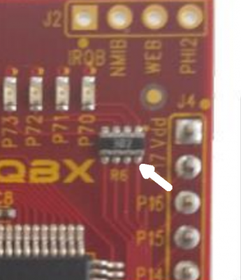

If you dare to solder a tiny wire to the outer pin of resistor network R6 left to P17 of J4 you have P70=CS0B which you could use as chip select for your PIA.
This requires some skill in soldering!

Mmmh ... but who takes care that the CS4B External ROM and the CS0B PIA won't interfere, since both overlap in terms of address range?

This is done internally to the W65C265 as layed out on page 22 of the data sheet. In this case you need to enable external busses (BCR0=1) and PCS0=1. The latter enables CS0B @ P70. (see 2.9.2 @ pg.37).
Datasheet: http://6502.org/documents/datasheets/wd ... 3_2010.pdf

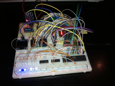

today I am very happy to be able to announce that the PIA 65C21 now works on the breadboard. Both ports, configured as output, are lighting up some LEDs implementing a simple counter.
As suggested in this thread, I tried to simplify the address decode logic to a minimum of stages. Also I am still using the original (slow) components, as the faster ones are a bit difficult to obtain.
In order to simplify the address logic I realized, that I am not limited to the specific range of $DFxx and I also didn't take the risk to ruin the board soldering a wire in order to access the CS0B pin directly. Thus I could allocate the PIA to virtually any unused address and choose $C000 giving me the following address mapping:
|  Addr. Range  |  Usage/Chip   |
| $E000 - $FFFF | Intern. ROM   |
| $C000 - $C003 | External PIA  |
| $8000 - $9FFF | Ext. NVRAM    |
| $0000 - $7FFF | Ext. SRAM     |
The CS0 and CS1 lines are tied the the A15 and A14 lines. The CS2B line is qualified with PHI2 through an inverter. The RS0 and RS1 are tied to the A00 and A01 lines respectively,
Unfortunately, when wiring up the chip, initially I switched the RS0 and RS1 lines which caused the LEDs light up inversely :oops: . Writing $FE into $C000 lighted the first and writing $01 into $C000 all but the first.
After fixing this silly mistake, everything works fine as intended.
