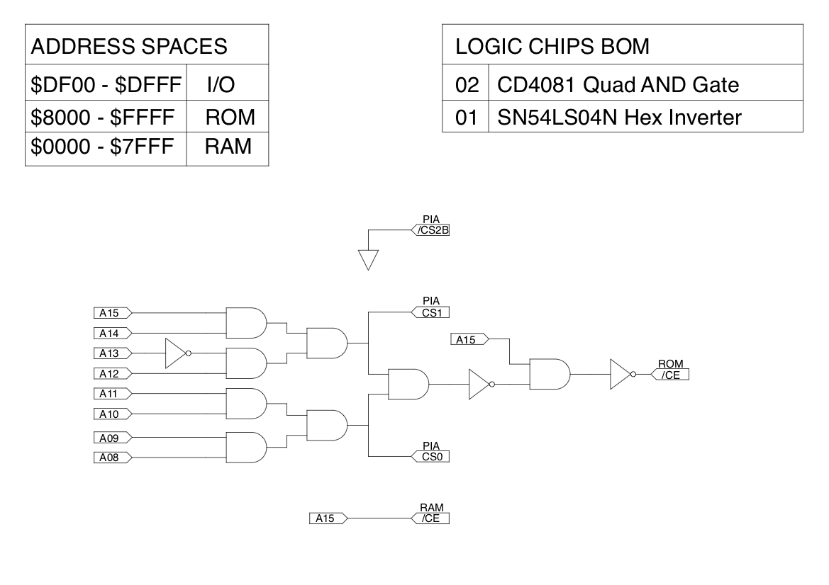

this weekend I am planning to add one of my W65C21S Peripheral Interface Adapter to my breadboard assembly.
I am not sure about the required logic for the three chips RAM, ROM (currently NVRAM) and the PIA to play nicely together.
I came up with the following idea, which would require 3 auxiliary logic chips I have in stock.
What do you think ... could that work?
Regards.
PostPosted: Fri Jun 22, 2018 8:01 pm
Posts: 8239
/RESET wrote:
Hi!
The attachment ChipSelect21.png is no longer available
Regards.
A more detailed I/O memory map would be nice. The information you've given doesn't really tell enough to determine if your logic is completely correct.
In any case, the logic as designed will be quite slow, especially with using the CD4081. Take a look at the 74HC21, which is faster, and see if you can simplify your circuit to reduce the number of gates between the address bus and the individual chip selects. Further reductions may be possible by not trying to cram all of the I/O hardware into one page.
Also, the 54LS04 inverter is not recommended in an all-CMOS circuit. I suggest you use 74AC04 or 74HC04. Mixing TTL and CMOS logic may cause hard-to-diagnose problems due to the families' differing notions of what voltage levels constitute a valid logic condition.

PostPosted: Fri Jun 22, 2018 8:45 pm
Joined: Thu Apr 12, 2018 8:27 pm
Posts: 33
Location: RS/Brazil
Hi!
Thank you very much for your help!
I had no idea about such huge timing differences. I assume we are talking about the propagation time. As of the data sheet, the CD4081 is about 10x slower than the 74HC21 you suggested.
The image below shows the memory map from the WDC data sheet. As of my understanding, the PIA should be mapped to either $DF00-$DF1F or $DFC0-$DFFF.

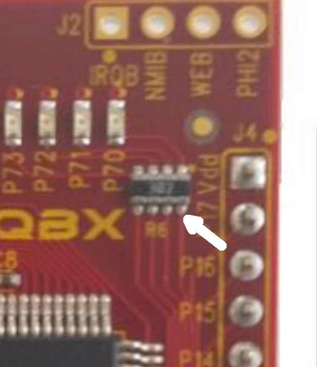

If you dare to solder a tiny wire to the outer pin of resistor network R6 left to P17 of J4 you have P70=CS0B which you could use as chip select for your PIA.
This requires some skill in soldering!

Mmmh ... but who takes care that the CS4B External ROM and the CS0B PIA won't interfere, since both overlap in terms of address range?

PostPosted: Fri Jun 22, 2018 9:52 pm
Posts: 660
Location: North-Germany
This is done internally to the W65C265 as layed out on page 22 of the data sheet. In this case you need to enable external busses (BCR0=1) and PCS0=1. The latter enables CS0B @ P70. (see 2.9.2 @ pg.37).

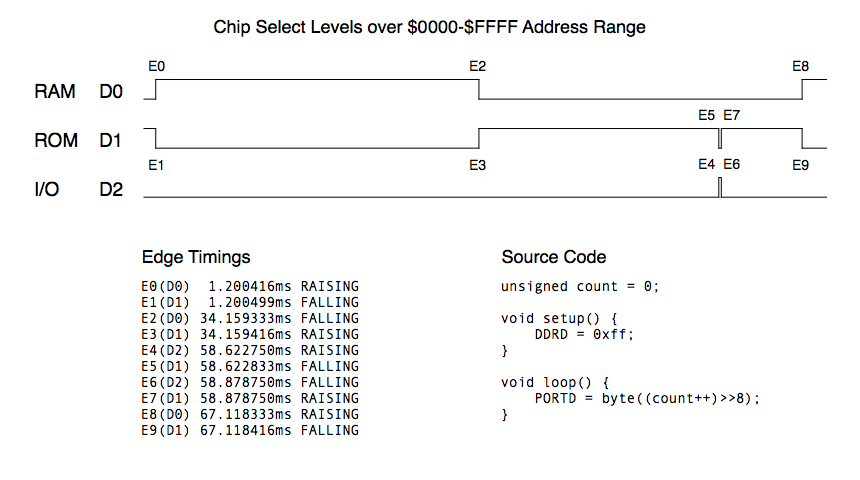

Initially everything went well. I managed to build the logic circuit like presented in the previous post. This time using the components I had at hand, which later could be replaced by the suggested faster components.
To test the circuit, I put a ATMega328 on a breadboard using the 8 pins of port D to simulate the A8 to A15 address lines of the 65C816 of the QBX. The ATMega runs at 16MHz. A short sketch iterates a 16bit integer simulating sequential addressing and the Hi-Byte of the counter is used as output on PORTD.
The image below, shows the produced signal levels and timing for one cycle over the whole 16-bit address range.
So far so good. Looks like the circuit is doing what it is supposed to do. Enabling the RAM for adresses $0000-$7FFF then enabling ROM from $8000-$DEFF and then enabling I/O from $DF00-$DFFF and enabling ROM again from $E000-$FFFF.
Looking close at the edge timings, there is some overlapping of around 83ns. But let's ignore that for now. To compensate I could go for faster logic chips and/or slow down chip access timing via the '816 speed control register (SSCR).
If I had stopped here the weekend would have been a success, but I resolved to test some more variations for the simulation, basically fast alternations between pairs of address spaces: $81 (ROM) and $00 (RAM), $DF (I/O) and $81 (ROM), $DF (I/O) and $00 (RAM).
It happens that the last alternating address combination between $DF (I/O) and $00 (RAM) shows a strange behavior I could not explain. Even the $81 (ROM) is not involved, the corresponding signal briefly goes high immediately before the I/O chip select line does.
The image below shows the different simulations along with the source code for better understanding.
Any idea what could cause this behaviour?

PostPosted: Tue Jun 26, 2018 10:58 pm
This is a classic "glitch" signal, caused by some parts of the address transitioning or being decoded more quickly than others. You will note that $81 has the most-significant and least-significant bits set, and so does $DF (as well as most of the others).
In particular, A15 is decoded much faster (only 1 gate delay) than the combination of A15-A8 which selects the I/O (4 gate delays), and there's a further 2 gate delays before the latter deselects the ROM when A15 initially selected it.
This is an excellent argument in favour of qualifying all output and write enabled with the clock, giving time for the decode logic to settle before driving or interpreting the data bus.

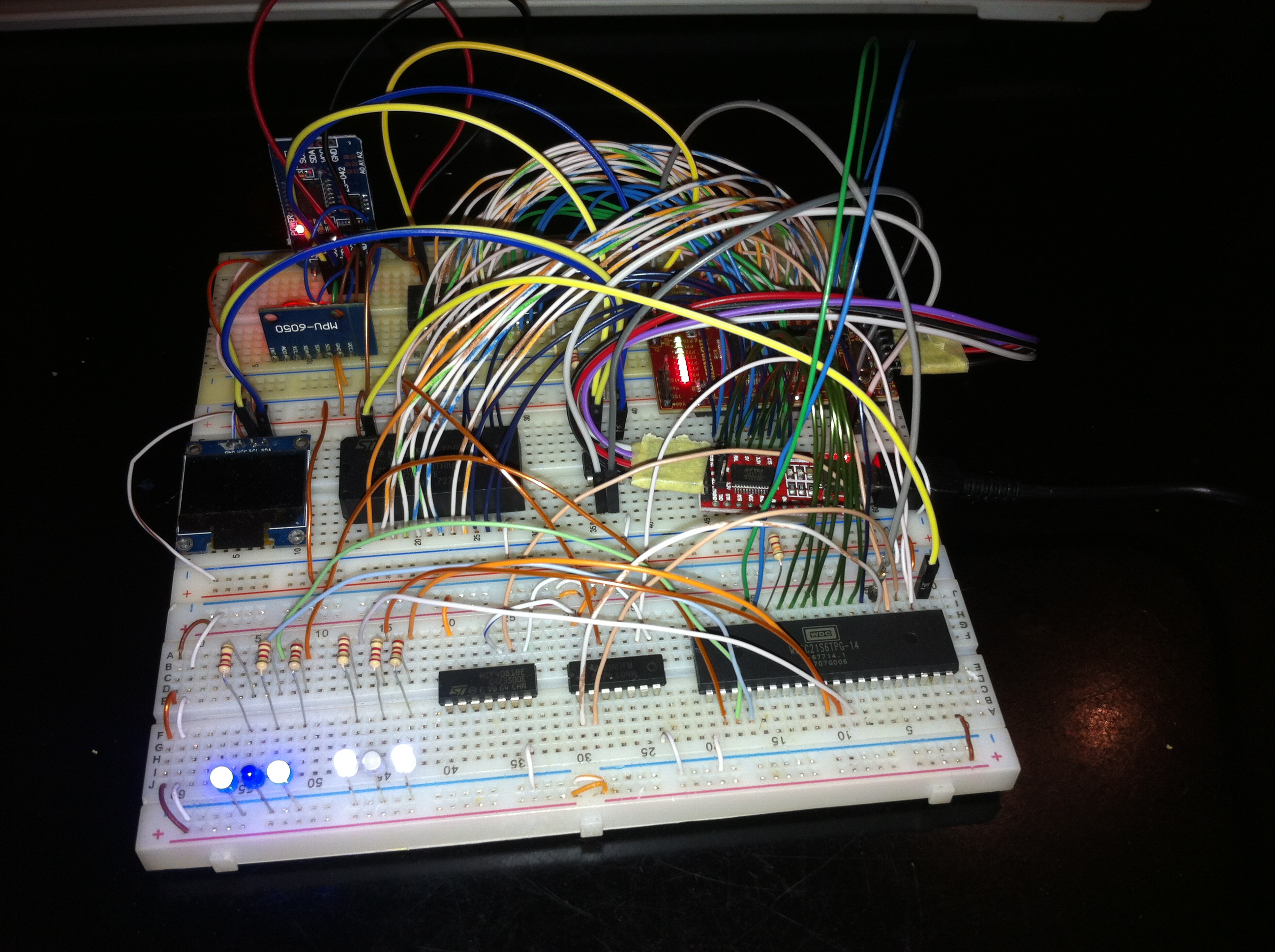

today I am very happy to be able to announce that the PIA 65C21 now works on the breadboard. Both ports, configured as output, are lighting up some LEDs implementing a simple counter.
As suggested in this thread, I tried to simplify the address decode logic to a minimum of stages. Also I am still using the original (slow) components, as the faster ones are a bit difficult to obtain.
In order to simplify the address logic I realized, that I am not limited to the specific range of $DFxx and I also didn't take the risk to ruin the board soldering a wire in order to access the CS0B pin directly. Thus I could allocate the PIA to virtually any unused address and choose $C000 giving me the following address mapping:

The CS0 and CS1 lines are tied the the A15 and A14 lines. The CS2B line is qualified with PHI2 through an inverter. The RS0 and RS1 are tied to the A00 and A01 lines respectively,
Unfortunately, when wiring up the chip, initially I switched the RS0 and RS1 lines which caused the LEDs light up inversely :oops: . Writing $FE into $C000 lighted the first and writing $01 into $C000 all but the first.
After fixing this silly mistake, everything works fine as intended.
