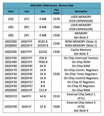

The image below shows the memory map from the WDC data sheet. As of my understanding, the PIA should be mapped to either $DF00-$DF1F or $DFC0-$DFFF.

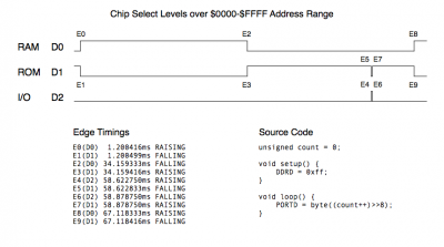

Initially everything went well. I managed to build the logic circuit like presented in the previous post. This time using the components I had at hand, which later could be replaced by the suggested faster components.
To test the circuit, I put a ATMega328 on a breadboard using the 8 pins of port D to simulate the A8 to A15 address lines of the 65C816 of the QBX. The ATMega runs at 16MHz. A short sketch iterates a 16bit integer simulating sequential addressing and the Hi-Byte of the counter is used as output on PORTD.
The image below, shows the produced signal levels and timing for one cycle over the whole 16-bit address range.
So far so good. Looks like the circuit is doing what it is supposed to do. Enabling the RAM for adresses $0000-$7FFF then enabling ROM from $8000-$DEFF and then enabling I/O from $DF00-$DFFF and enabling ROM again from $E000-$FFFF.
Looking close at the edge timings, there is some overlapping of around 83ns. But let's ignore that for now. To compensate I could go for faster logic chips and/or slow down chip access timing via the '816 speed control register (SSCR).

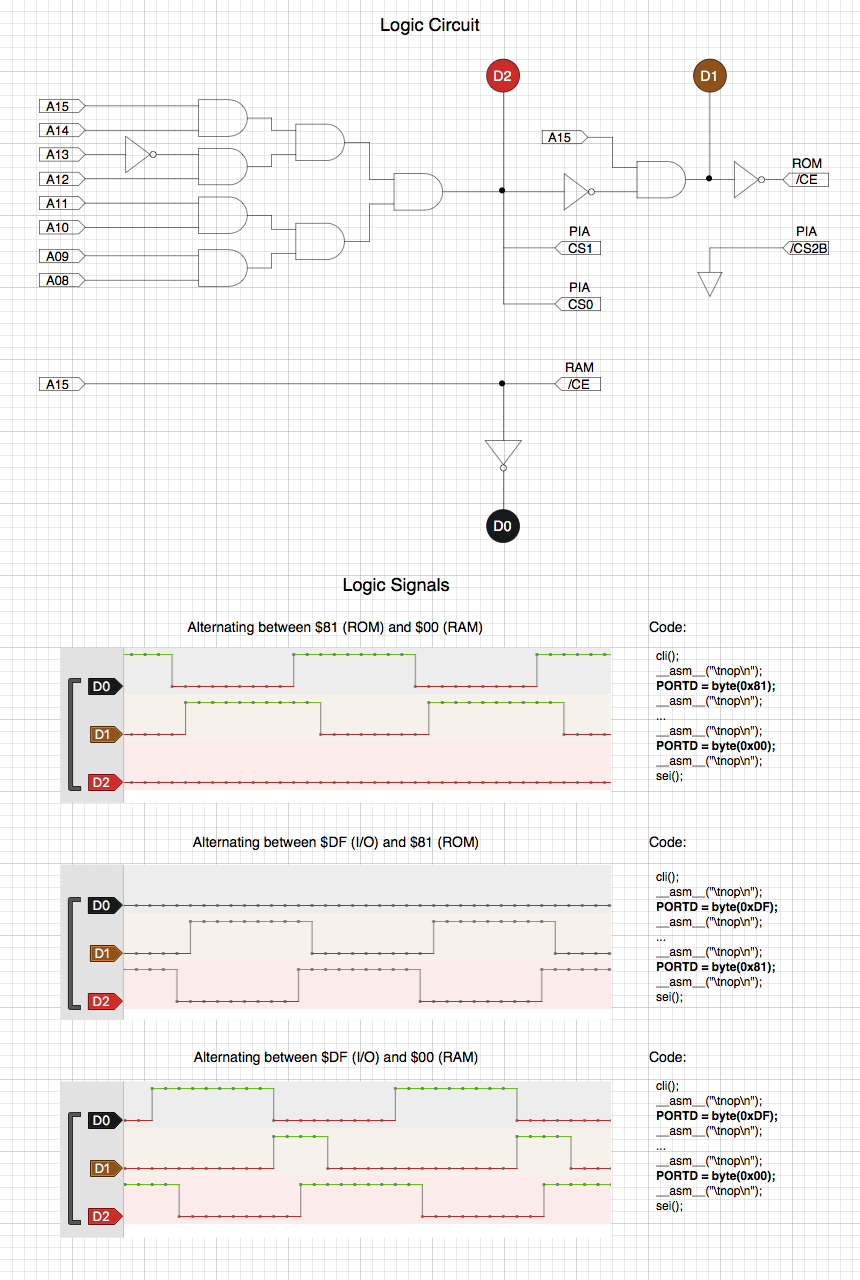

If I had stopped here the weekend would have been a success, but I resolved to test some more variations for the simulation, basically fast alternations between pairs of address spaces: $81 (ROM) and $00 (RAM), $DF (I/O) and $81 (ROM), $DF (I/O) and $00 (RAM).
It happens that the last alternating address combination between $DF (I/O) and $00 (RAM) shows a strange behavior I could not explain. Even the $81 (ROM) is not involved, the corresponding signal briefly goes high immediately before the I/O chip select line does.
The image below shows the different simulations along with the source code for better understanding.
Any idea what could cause this behaviour?

PostPosted: Tue Jun 26, 2018 10:58 pm
This is a classic "glitch" signal, caused by some parts of the address transitioning or being decoded more quickly than others. You will note that $81 has the most-significant and least-significant bits set, and so does $DF (as well as most of the others).
In particular, A15 is decoded much faster (only 1 gate delay) than the combination of A15-A8 which selects the I/O (4 gate delays), and there's a further 2 gate delays before the latter deselects the ROM when A15 initially selected it.
This is an excellent argument in favour of qualifying all output and write enabled with the clock, giving time for the decode logic to settle before driving or interpreting the data bus.
