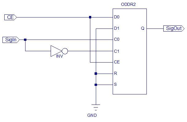

It's become obvious to me now, after hooking up the 640x480 TFT I've had success with using the Spartan 3 family, that I'm going to have to start the design from ground zero (i.e. CPU core only with RAMs, ROM and TFT i/f).
The Reset line is behaving correctly now (unsure what the deal is with the 800x480 latching the reset low, still awaiting its return), and I am seeing active signals on all the lines to the TFT. The TFT is behaving strangely, so I will need to concentrate on proper off-chip clock forwarding techniques.
These are the signals I need to bring out to the TFT:
A0, D0-D7, O2, WEn, TFTCSn, RESn.
A0 from CPU core selects 0=DCOM (TFT Command Reg) 1=DDAT (TFT Data Reg).
D0-D7 from CPU core. Lower 8 bits of Data Bus.
O2 from Spartan 6 DCM. Main 20MHz Clock signal out (clkfx) from 100MHz in DCM.
WEn. R/W to TFT. What has worked with the Spartan 3 is an inverted WE signal AND'd with O2...
TFTCSn is address decoded for active low $FFFF0010-$FFFF0011.
RESn is active low from POR DS1818. Inverted for CPU core RES.
So if I understand correctly, all signals must be output through a FF present on an IOB. For the Spartan 6 family these FF's are available as DDR types, which allows a signal to be clocked without dividing it's speed in half.
So schematicwise, I have something that looks like below. The inverter is local and hopefully will not create a delay problem, as I think the proper way to do it for strictest timing is to use the clkfx180 in conjuction with the clkfx from the DCM. (clkfx is the 20MHz used for the internal O2 clock). How would I go about hooking my signals up to this?
This is the Verilog Coding:
module ClkOutFF(CE,
                SigIn,
                SigOut);
    input CE;
    input SigIn;
   output SigOut;
   wire XLXN_2;
   wire XLXN_7;
   ODDR2 #( .INIT(1'b0), .SRTYPE("SYNC"), .DDR_ALIGNMENT("NONE") ) XLXI_1
         (.CE(CE),
                 .C0(SigIn),
                 .C1(XLXN_2),
                 .D0(CE),
                 .D1(XLXN_7),
                 .R(XLXN_7),
                 .S(XLXN_7),
                 .Q(SigOut));
   INV  XLXI_2 (.I(SigIn),
               .O(XLXN_2));
   GND  XLXI_3 (.G(XLXN_7));
endmodule
Now what do to about the 8-bit wide DataBus? Will each line have to go through an ODDR2? There are no bus-wide DDR2 FF's.

Unless you're bringing out the clock itself, you should use regular FFs. This produces a valid signal on the output pad at the rising clock edge. Using DDRFF don't really give you an advantage. The advantage that the data is valid sooner is negated by the fact that this will shorten the timing budget inside the device, which will force you to use a lower clock.

Arlet wrote:
Unless you're bringing out the clock itself, you should use regular FFs...
So you're saying use a DDR FF for the O2Out Clock and regular FF's for all the other signals?
I'm currently working now on running a successful ISim. Will have to go back to the original 65Org16.b Core before your recent updates. I may have messed up adding those updates from your postings on GitHub...
Arlet
Joined: 16 Nov 2010
Post by Arlet »
I'm not sure what the O2Out clock does, but if you want to clock external devices with the same clock as your internal clock, you need to bring that out with a DDR FF, and the rest of the signals with regular FFs.
