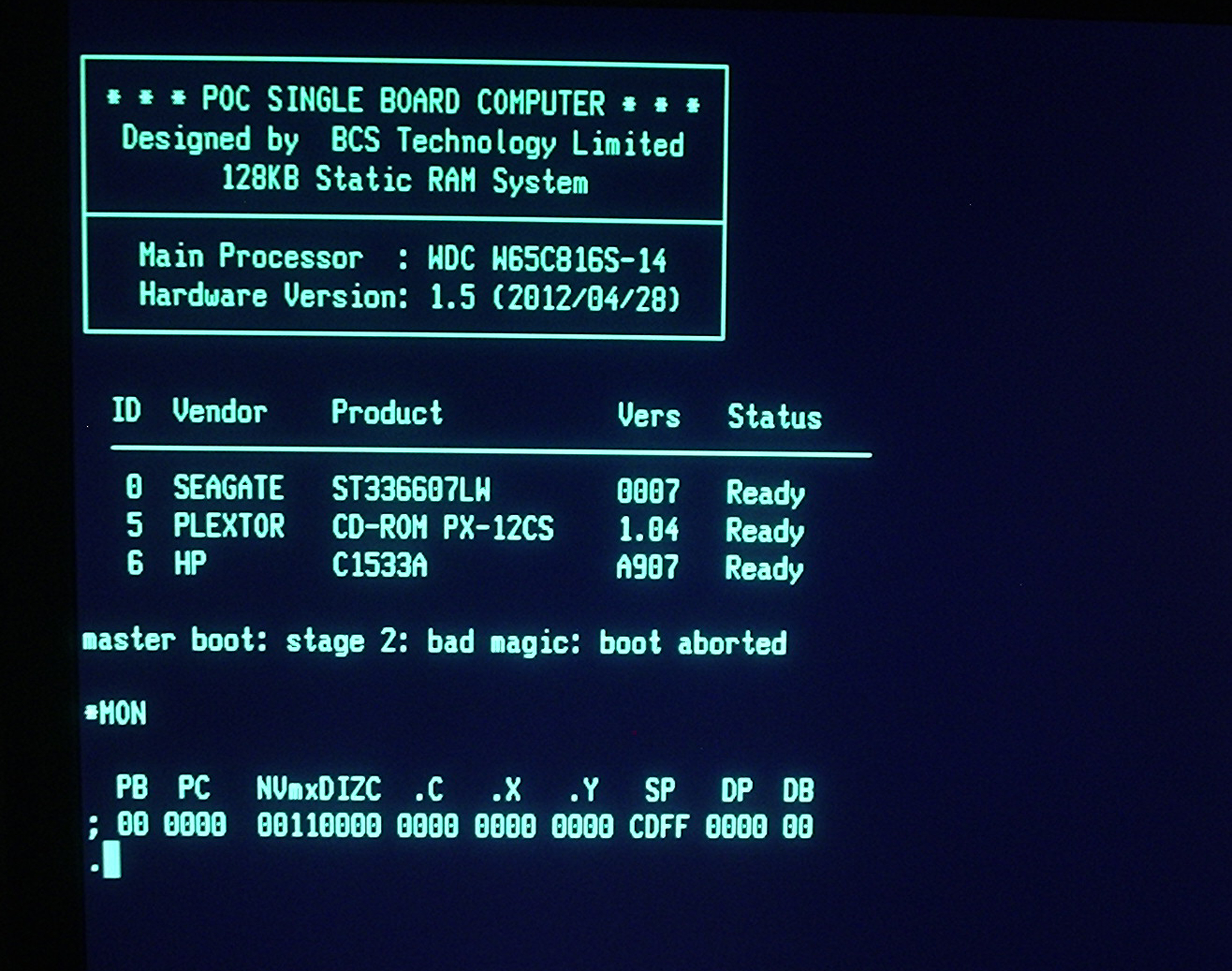

The above is the boot screen after POC has attempted to load an operating system. By default, it drops into the machine language monitor if the OS load doesn't succeed.

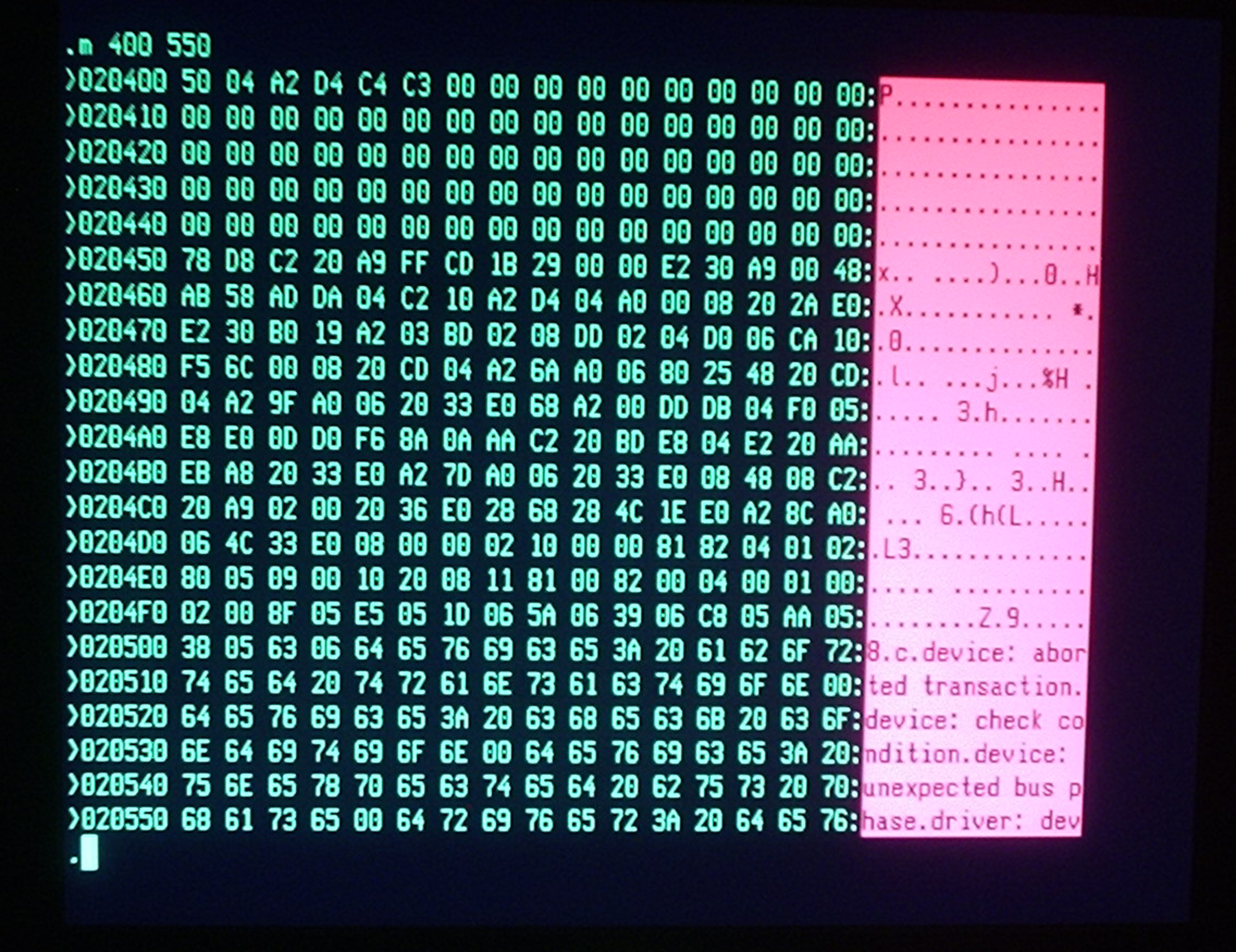

The above is a memory dump of the boot block that was read in from disk. The boot block is two physical disk blocks, so it isn't possible to display all of it on the screen. You can see some error messages that are part of the code. Also in the boot block is a filesystem table, with capacity for a maximum of four filesystems per disk. The S51Km design will support a maximum filesystem size of 64GB, which means a total of 256GB per disk can be supported. The disk currently attached is 36GB, so I can max it out with a single filesystem.

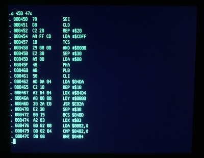

The above is the disassembly of part of the boot code. The code starting at $000462 uses a BIOS call (JSR $00E02A) to load the second stage boot segment, which is what will actually search for and load an operating system. All of this stuff is functional.

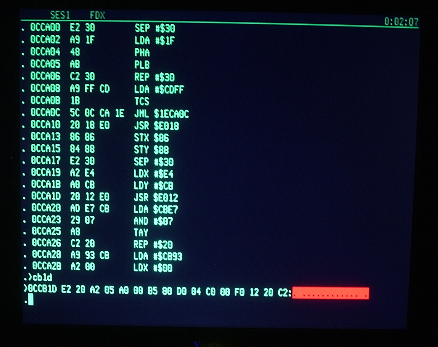

The above was some nonsense code I assembled to demonstrate how the machine language monitor's assembler works. It supports every 65C816 instruction and all addressing modes. Note how I goofed at $002010 when I entered the PEI instruction. When a mistake is made, the assembler prints the *ERR diagnostic and again prompts with the assembly address.

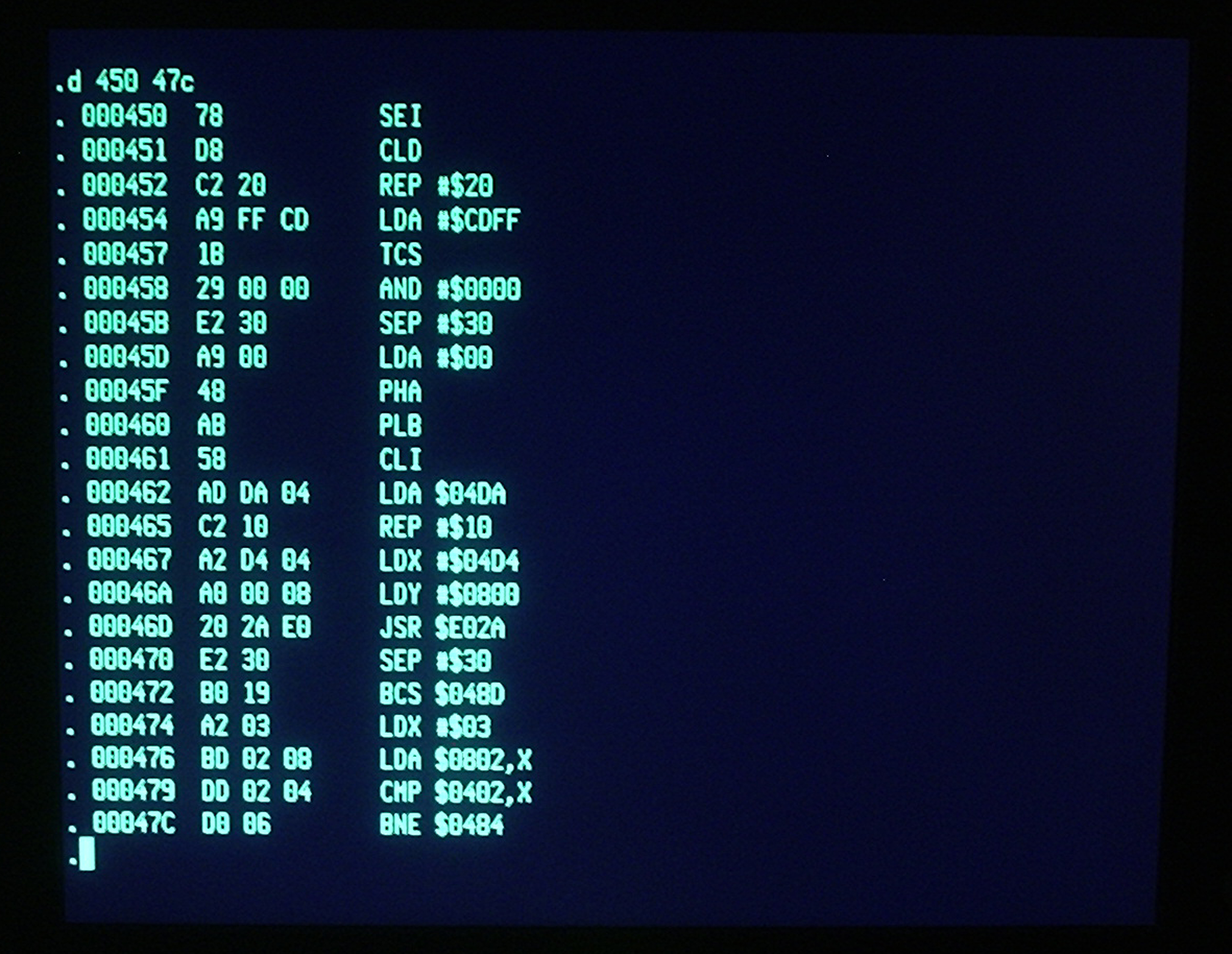

One of the first programs I wrote for POC once I got the M/L monitor functional was code to read the real-time clock and display the time and date. I then added to it to read the 32 bit IRQ-driven uptime counter and display the uptime.
Also in that picture, I had just finished transferring code from my UNIX software development box to POC. As the transfer progresses the loader prints a dot for each Motorola S-record that is successfully processed. When the load has completed the start and end addresses are printed and the program counter is set to the starting load address. All that is needed to run the program is to type g and hit the return key.
