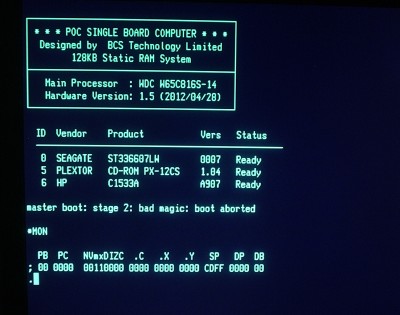

The above is the boot screen after POC has attempted to load an operating system. By default, it drops into the machine language monitor if the OS load doesn't succeed.

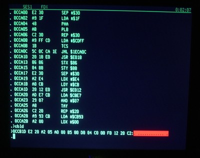

The above is a memory dump of the boot block that was read in from disk. The boot block is two physical disk blocks, so it isn't possible to display all of it on the screen. You can see some error messages that are part of the code. Also in the boot block is a filesystem table, with capacity for a maximum of four filesystems per disk. The S51Km design will support a maximum filesystem size of 64GB, which means a total of 256GB per disk can be supported. The disk currently attached is 36GB, so I can max it out with a single filesystem.
The above is the disassembly of part of the boot code. The code starting at $000462 uses a BIOS call (JSR $00E02A) to load the second stage boot segment, which is what will actually search for and load an operating system. All of this stuff is functional.

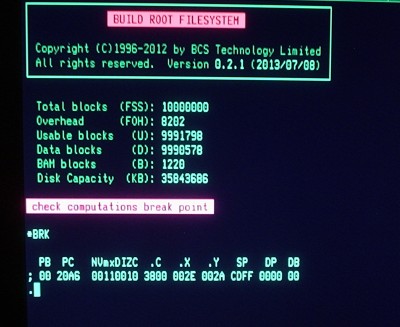

The above picture is the early phases of testing my build-a-filesystem code. The break point is after all of the filesystem geometry has been calculated. Prior to getting to this point, the program had to get the disk parameters (capacity, etc.) read the filesystem table in from the boot block and scan it to find an open slot. Also, the code had to verify that the filesystem name is unique. Once all those steps are handled a series of calculations are used to work out the filesystem structure. Displaying the results to the screen makes for more pleasant debugging than trying to read little-endian 32 and 64 bit binary integers in a memory dump and converting them to decimal.
The next step will be complete the code that will actually generate the filesystem.
