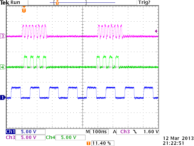

Working on SPI flash interface for CPU now. I'm making a very simple CPU interface with a memory mapped data register. Writing to the data register causes a byte to be shifted out over the SPI interface, and another byte to be shifted in at the same time. Later, I'll also add a read-only register that will cause $FF to be shifted out, and another byte to be shifted in, just by reading the register.
I'm using a 24 MHz SPI clock (main clock divided by 4), and because the CPU clock is 8 MHz, it takes less than 3 CPU cycles to shift a byte in or out. So, basically, the CPU can read serial flash data just as fast as it can access SRAM. Of course, you still need to set up the starting address, but as long as you read, say, 256 bytes at a time, that's not going to cost much. Here's a picture from the scope (top=data, bottom= clock), as a result of this code:
A write to $b110 causes the SPI byte to be written, and it's no problem to do back to back writes. I could even map the register in zero page.
ldx #$55
ldy #$aa
stx $b110
sty $b110

...I'm using a 24 MHz SPI clock (main clock divided by 4), and because the CPU clock is 8 MHz, it takes less than 3 CPU cycles to shift a byte in or out. So, basically, the CPU can read serial flash data just as fast as it can access SRAM. Of course, you still need to set up the starting address, but as long as you read, say, 256 bytes at a time, that's not going to cost much...
Re: 6502 Sandbox
You are right, I have a copy of an older version of the datasheet that only mentions 25 MHz operation. The newer ones go to 75 MHz. I'll modify the code to use a 48 MHz SPI clock instead.
Re: 6502 Sandbox

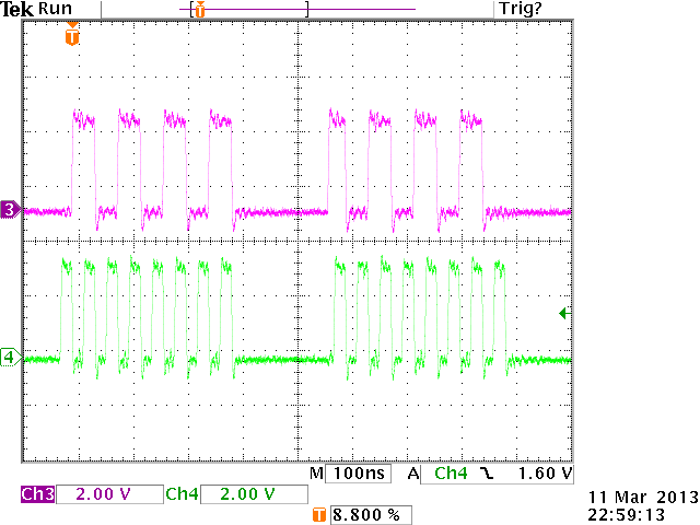

Here's the same thing, but now running with 48 MHz SPI clock. I've added the PHI2 signal for reference. Of course, when the 65C02 is driving the SPI interface, the higher speed is pointless, but it could become useful when the FPGA is driving the flash directly.
Flash is responding to read ID command:
Top trace is clock, middle is MOSI, bottom is MISO. Flash responds with $20, $20, $14, as stated in datasheet. I don't have a CPU interface for read data yet, so this is just hand decoded from the scope screen
