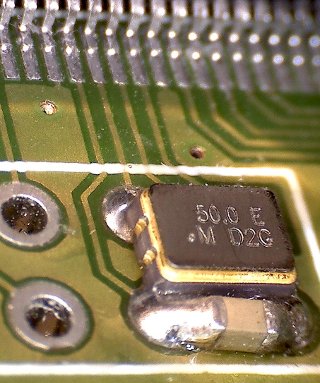

Here's a close up of the 50 MHz canned oscillator. It just happened to fit nicely on the 100 mil grid intended for the GPIO header, with the clock output pin matching up with a GCLK input of the FPGA. As the FPGA is configured, it writes a "0" to the GND pin, and a "1" to the VCC pin of the oscillator, so I didn't have to add any patch wires
Configuration from M25P80 SPI Flash is also working correctly, so a push on the button reconfigures the FPGA, which then resets the 6502.

You had mentioned before I think, that the SPI flash can also store user programs and data in, addition to configurating the FPGA, for available transfer into the high speed FPGA blockRAM. I use SPI flash for my project exclusively for nonvolatile storage for this purpose. Although I have not worked on the drivers yet.
Re: 6502 Sandbox
Yes, but the configuration from SPI flash was new for me, so I'm happy to see it actually working. Reading the user data has less chance of mess ups, because it's just a matter of setting up user I/O pins, and the rest is all "software".
In rev 2 of my board, I also have room for a micro SD card, just like on your board. If I get that working, I'll be happy to share the code.

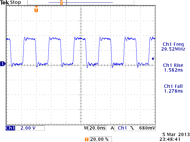

By the way, the SPI Flash configuration is based on Figure 2-12 from UG380, but I don't have the resistors to terminate the CCLK signal. It's just a straight connection (but less than 0.5 inch, so pretty short). Picture from scope shows the CCLK signal on the header pins next to the SPI flash, set to the highest speed it will go (26 MHz according to spec, but closer to 30 MHz on actual silicon). At this speed, configuration is near-instantaneous.
So, if you are thinking about doing SPI Flash configuration instead of Xilinx PROMs for any future projects, you can keep that in mind.

26MHz eh? Now that is a fast FPGA config! I believe that part is cheaper than the Xilinx FPGA PROM too.
From memory I thought my FPGA was being programmed at a 6MHz cclk. I just checked and the config clock is only running @ 2MHz. Almost a full second before I see any action. Do you have a schematic for your SPI flash setup?

The CCLK speed is programmable. Using BitGen, you can change the CCLK speed. The initial bits of the bit stream provide information regarding the configuration options, the target FPGA of the bitstream, configuration stage in which several signals are released, etc.
The BitGen properties can be changed like the synthesizer and PAR options: right-click the Generate Programming File process. If I remember correctly, unless you set a specific speed for CCLK, it will use the default, or 1 MHz. The internal oscillator's tolerance is such that it may actually run faster than 1 MHz.
On the Spartan-3AN, the VS[2:0] pins configure the clock to the internal SPI configuration memory bonded to the FPGA.
On the Spartan 3A, the VS pins define the read command for the SPI memory. In this way, the SPI configuration option can support various SPI devices from different vendors, and various SPI read modes for those parts.
