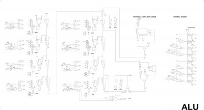

Re: Breaking 6502 apart
Todays speccy: ALU logic circuit
Later I maybe optimize SUM calculation, by replacing couple of NAND/NORs by XORs.
Don't want to mess with inverted carry chain ATM
