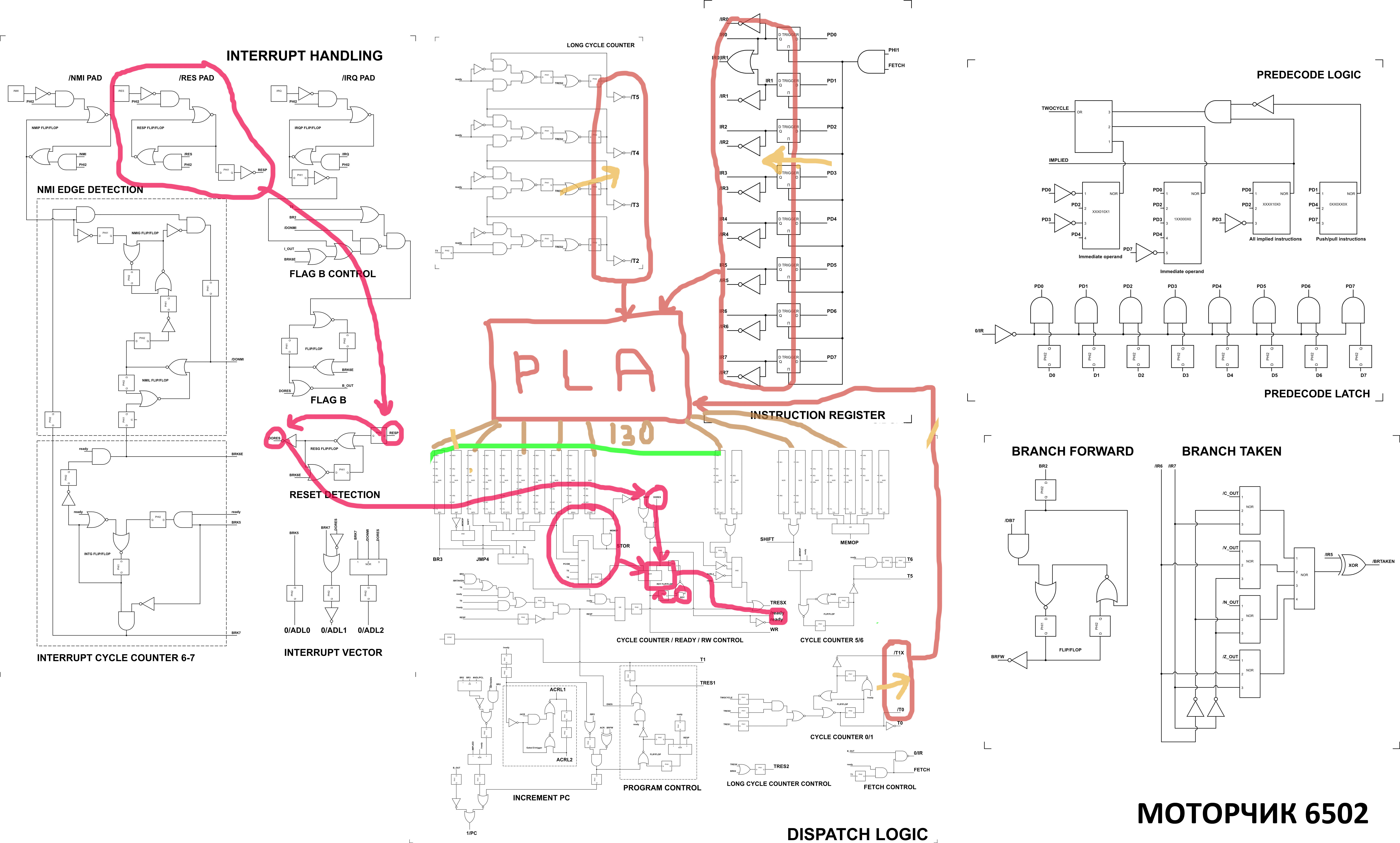

These are individual columns of the decoder PLA, each being a big NOR gate. The IR is the Instruction Register.
org
Posts: 201
Joined: 22 Jun 2012
Re: Breaking 6502 apart
Post by org »
Yeap, and BRK2 / JSR3 are decoder line names. Number after opcode represent cycle, when this decoder line is trigger.

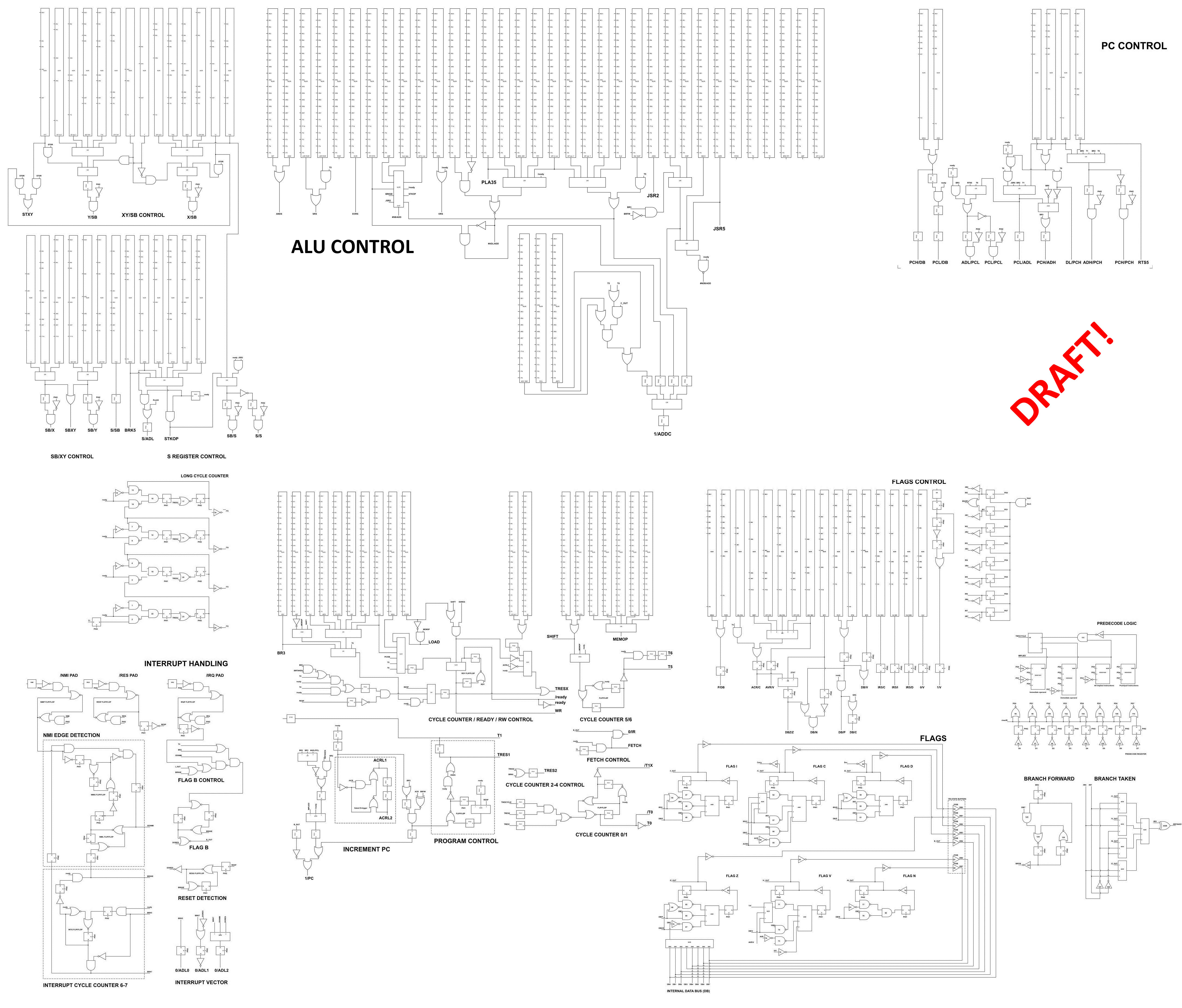

I almost completed top part on logic gates, and made some draft of it.
Don't look closely, it may contain typos and still not fully "de-morganized", just wanted to show you complexity and structural parts of it.
Bottom part will be done after top one.

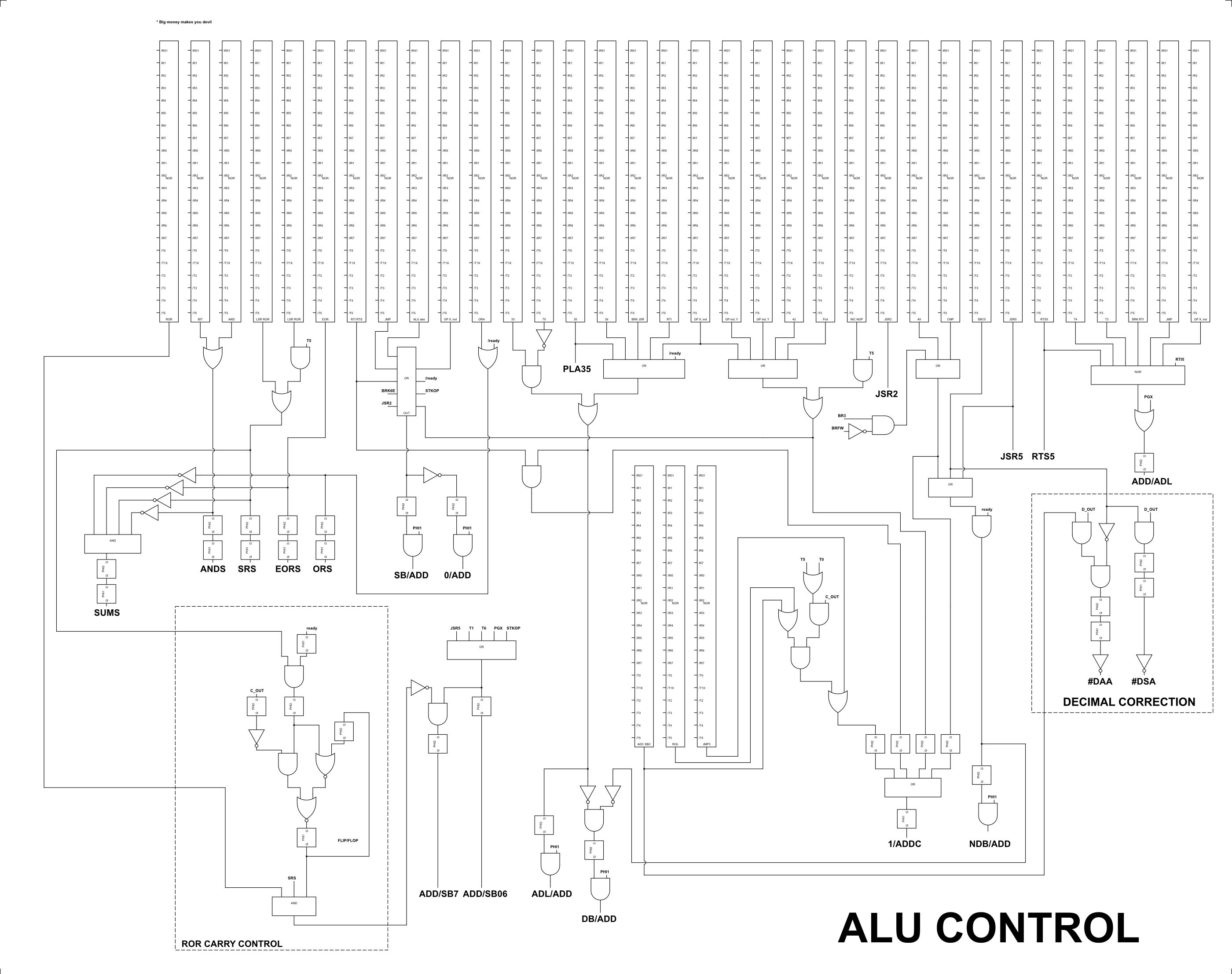

Todays speccy: ALU control
(I'm lazy to complete PLA lines, will be added later :P )
+fixed shortcut on ROR carry logic in transistor circuit.

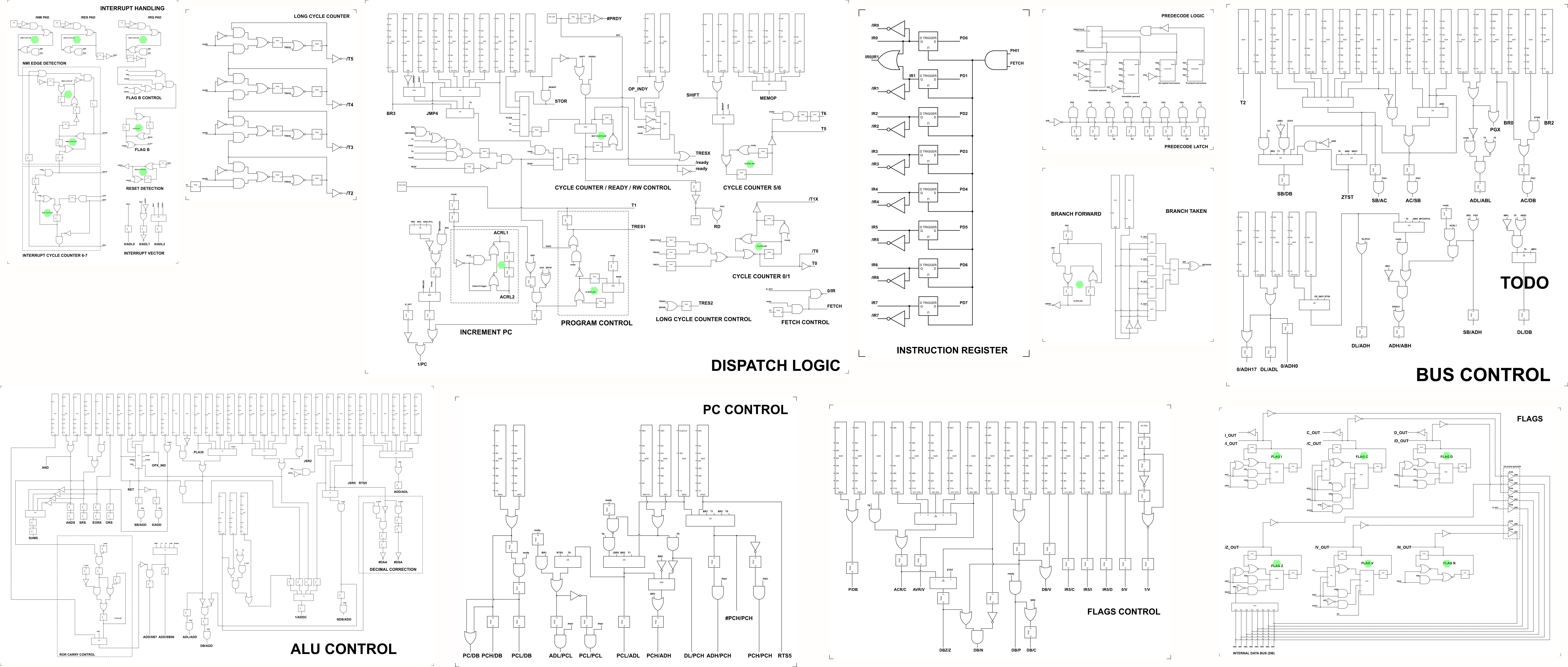

Ok, I'm done with top part.
I isolated 6502 "core" and trying to understand how its executing, step by step.
Some slides below :)

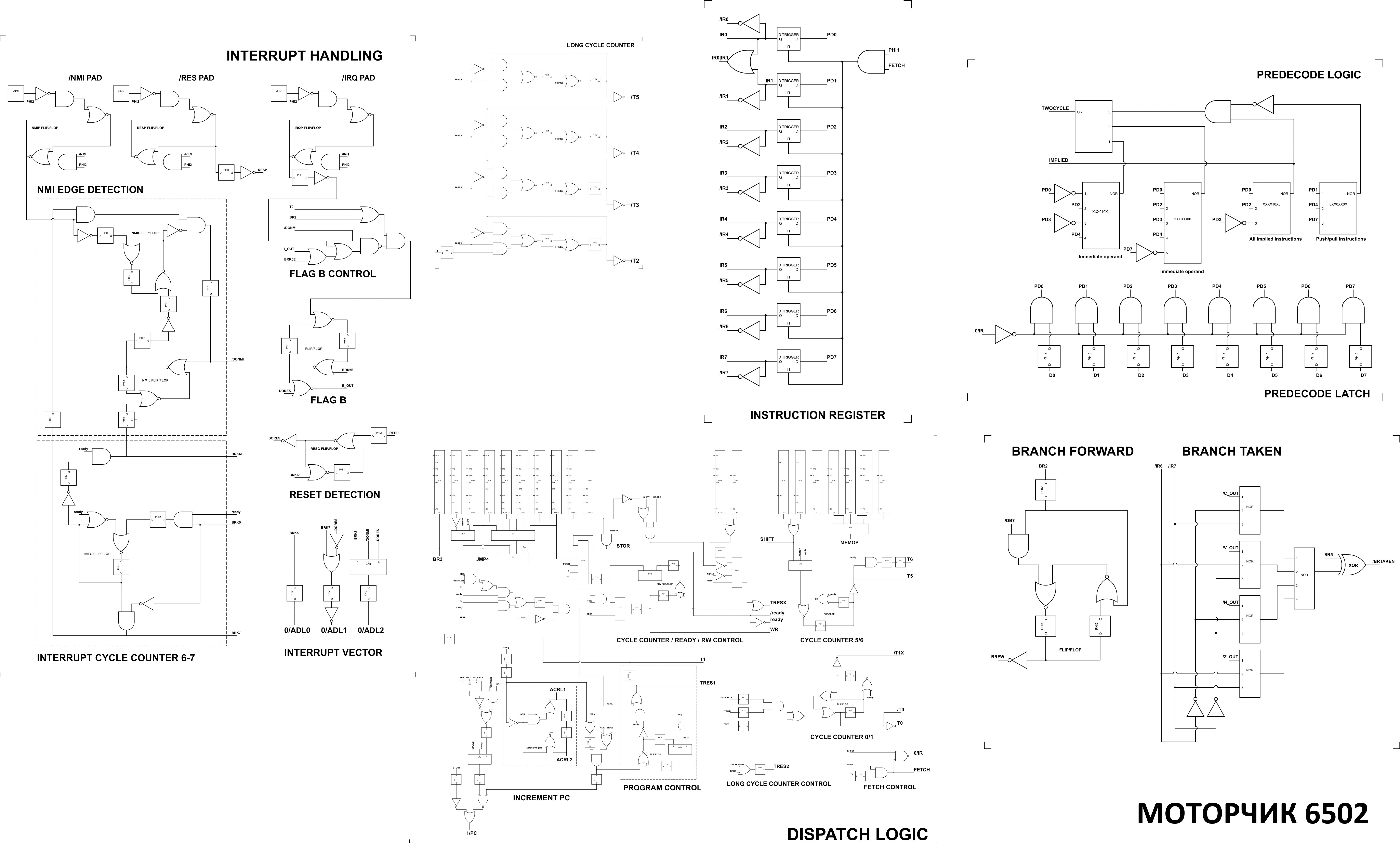

Updated transistor circuits. Fixed some errors and split it on two parts : top and bottom.
