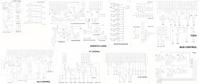

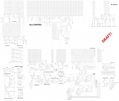

I almost completed top part on logic gates, and made some draft of it.
Don't look closely, it may contain typos and still not fully "de-morganized", just wanted to show you complexity and structural parts of it.
Bottom part will be done after top one.

Bravo!

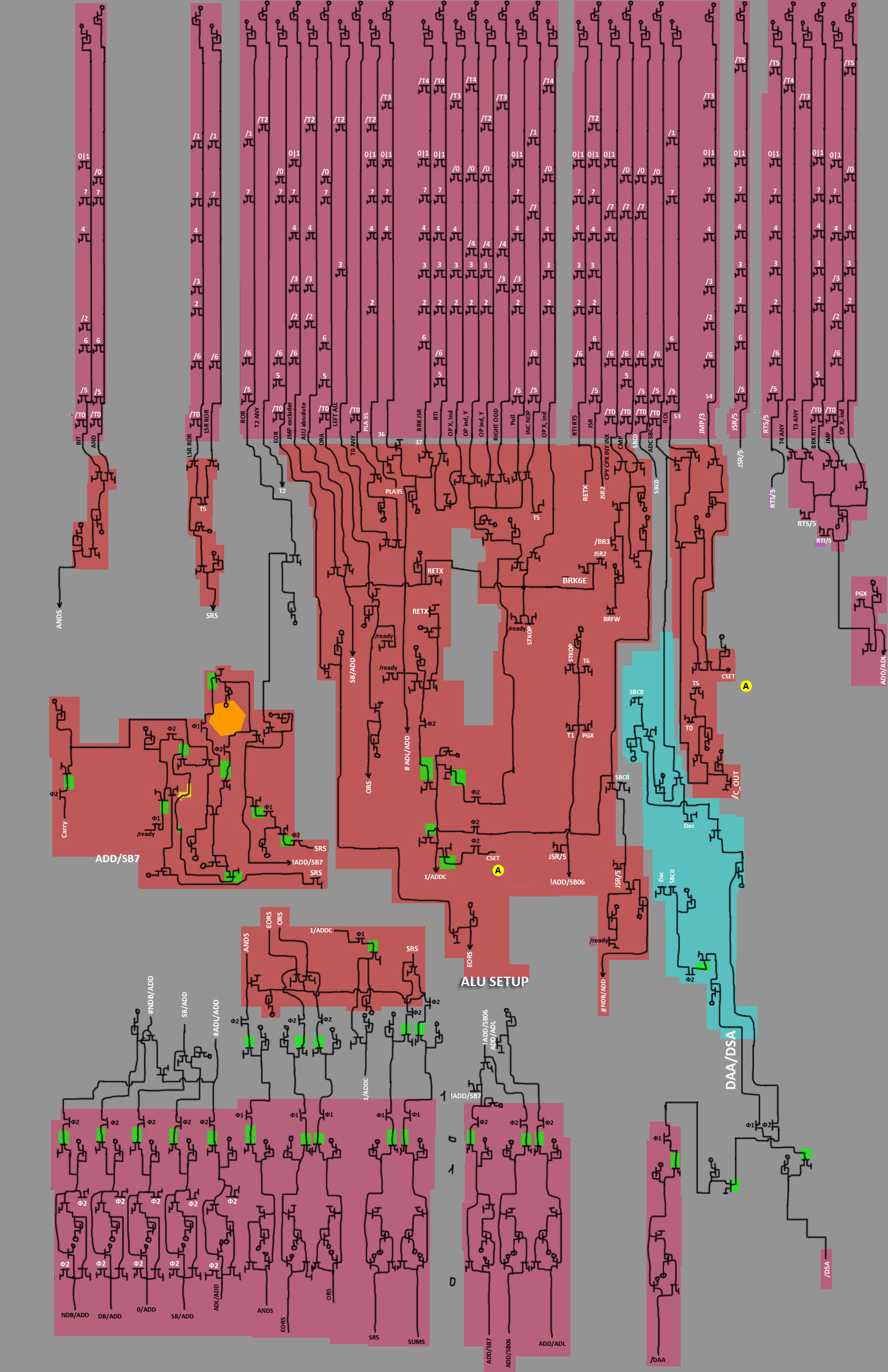

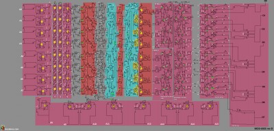

Todays speccy: ALU control
(I'm lazy to complete PLA lines, will be added later :P )
+fixed shortcut on ROR carry logic in transistor circuit.

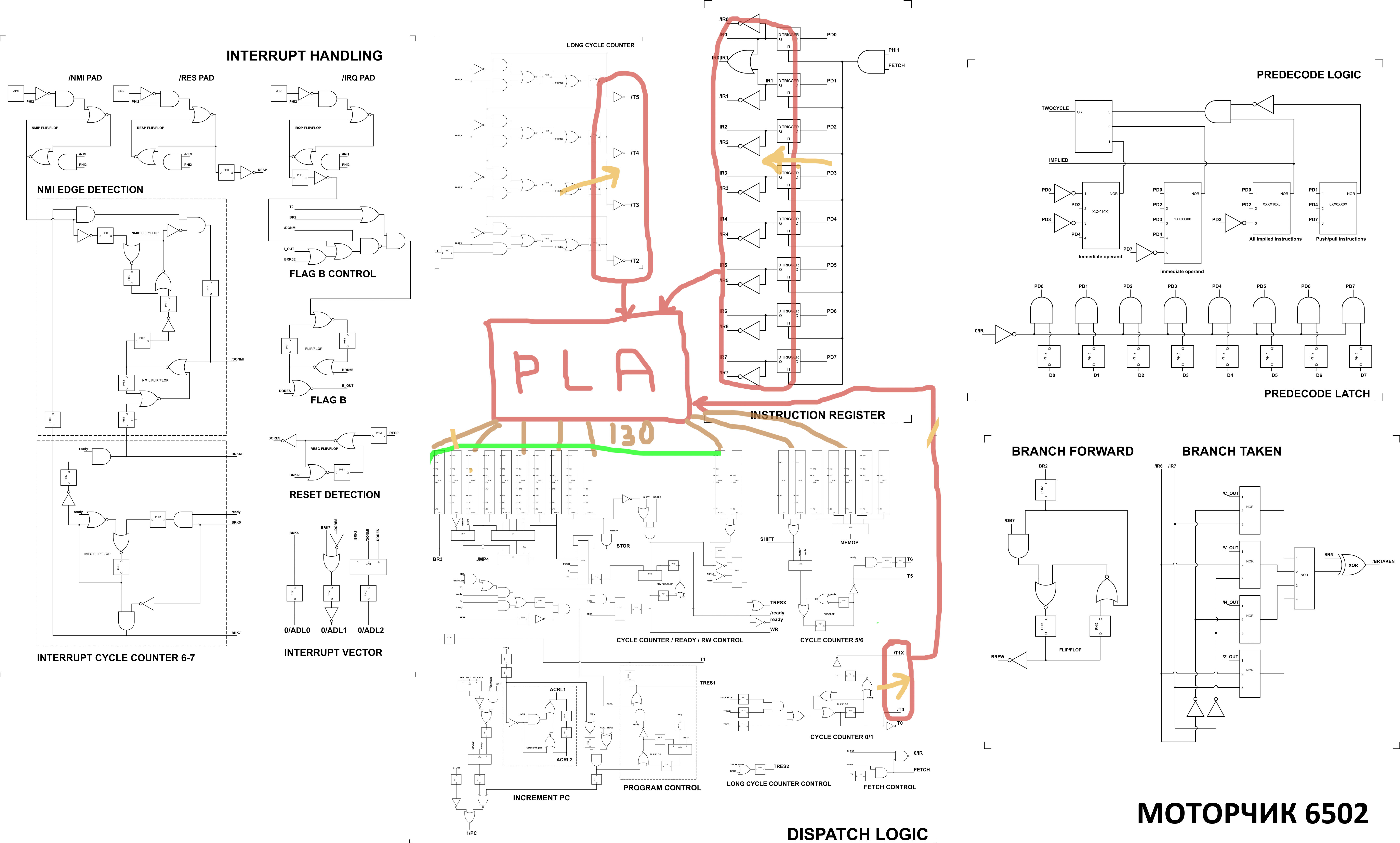

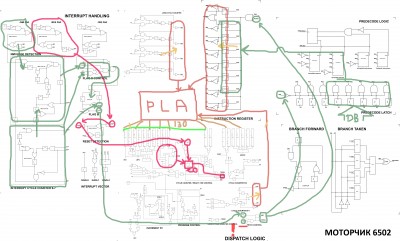

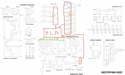

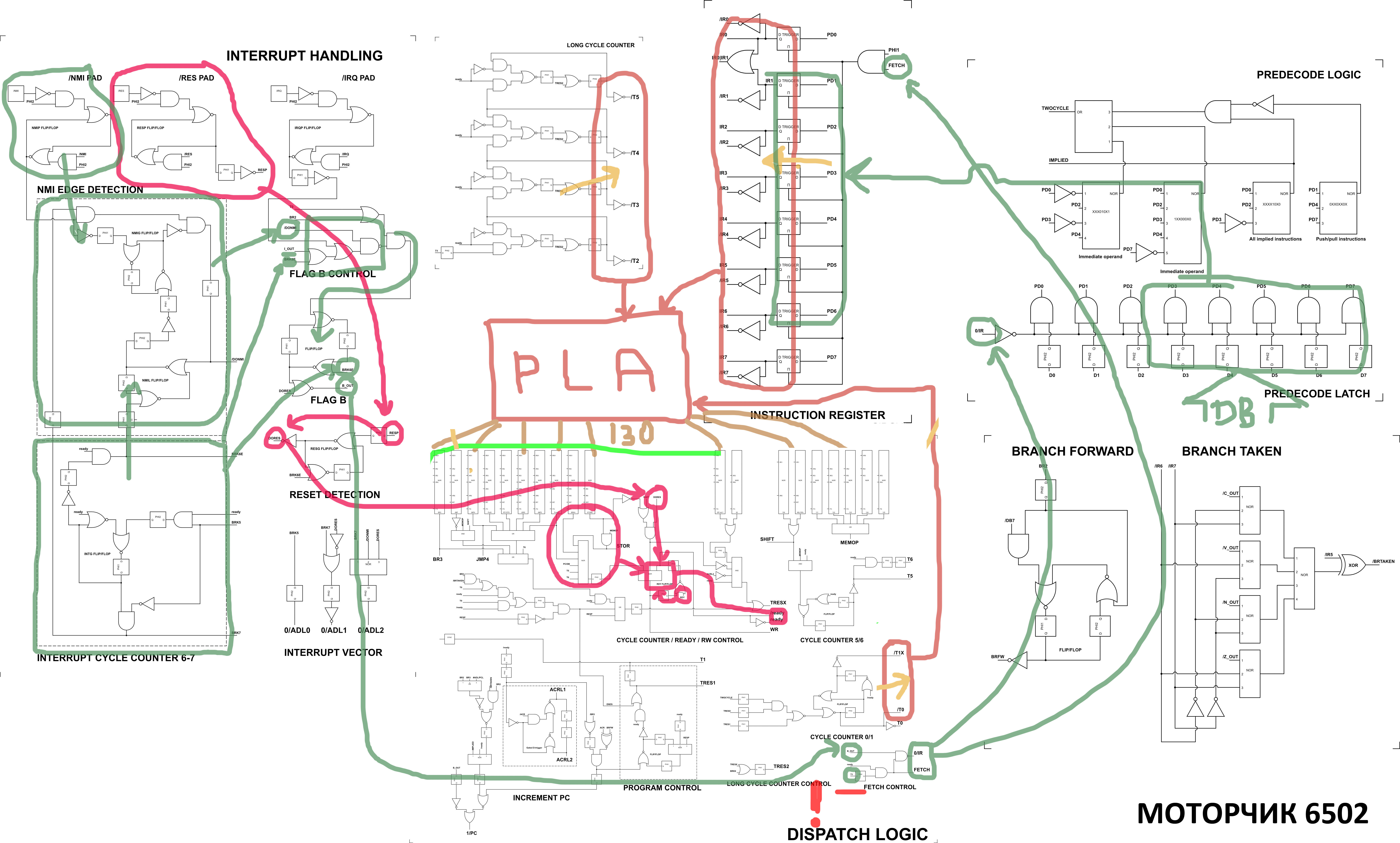

Ok, I'm done with top part.
I isolated 6502 "core" and trying to understand how its executing, step by step.
Some slides below :)

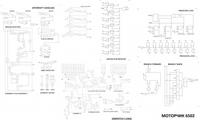

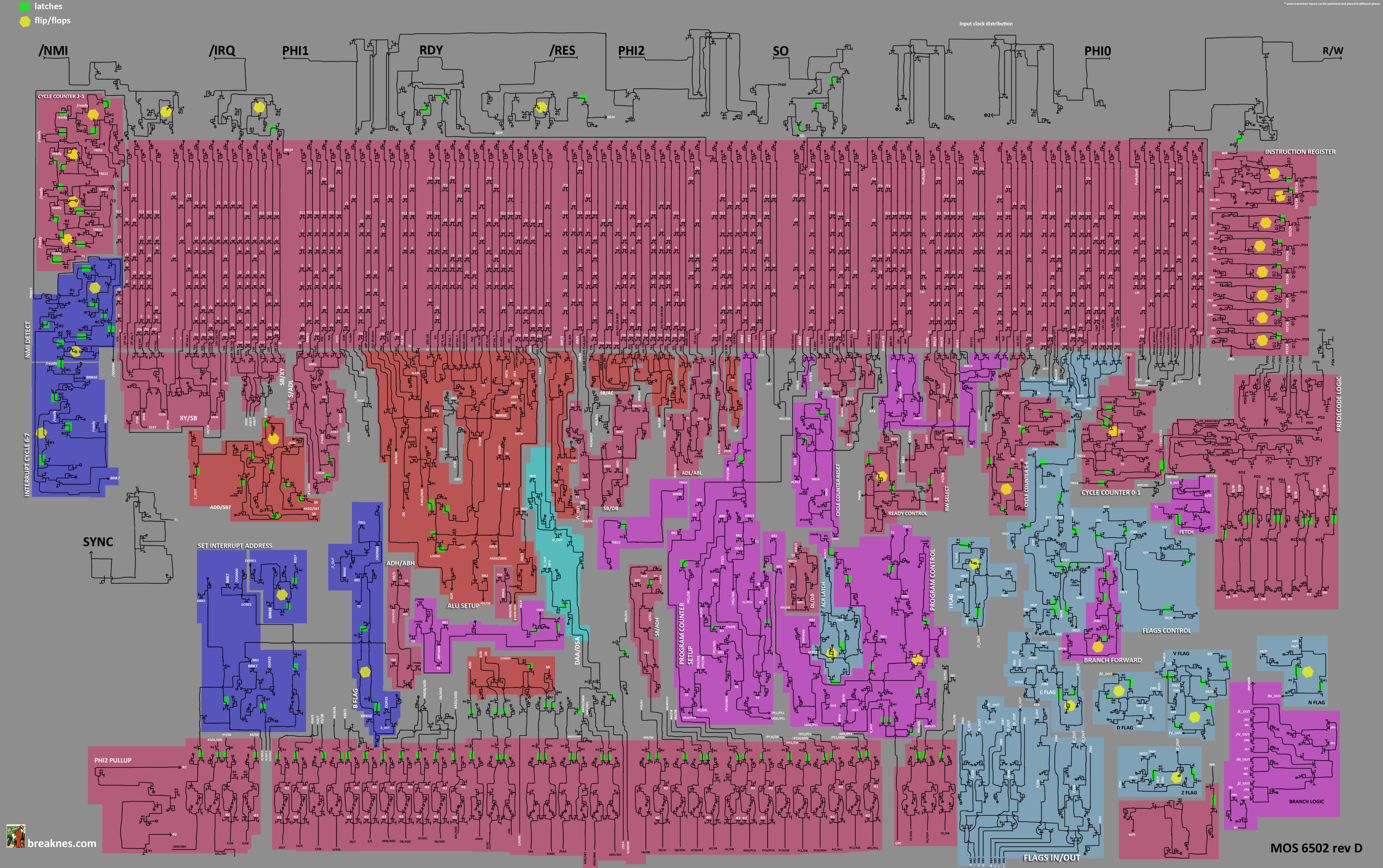

Updated transistor circuits. Fixed some errors and split it on two parts : top and bottom.

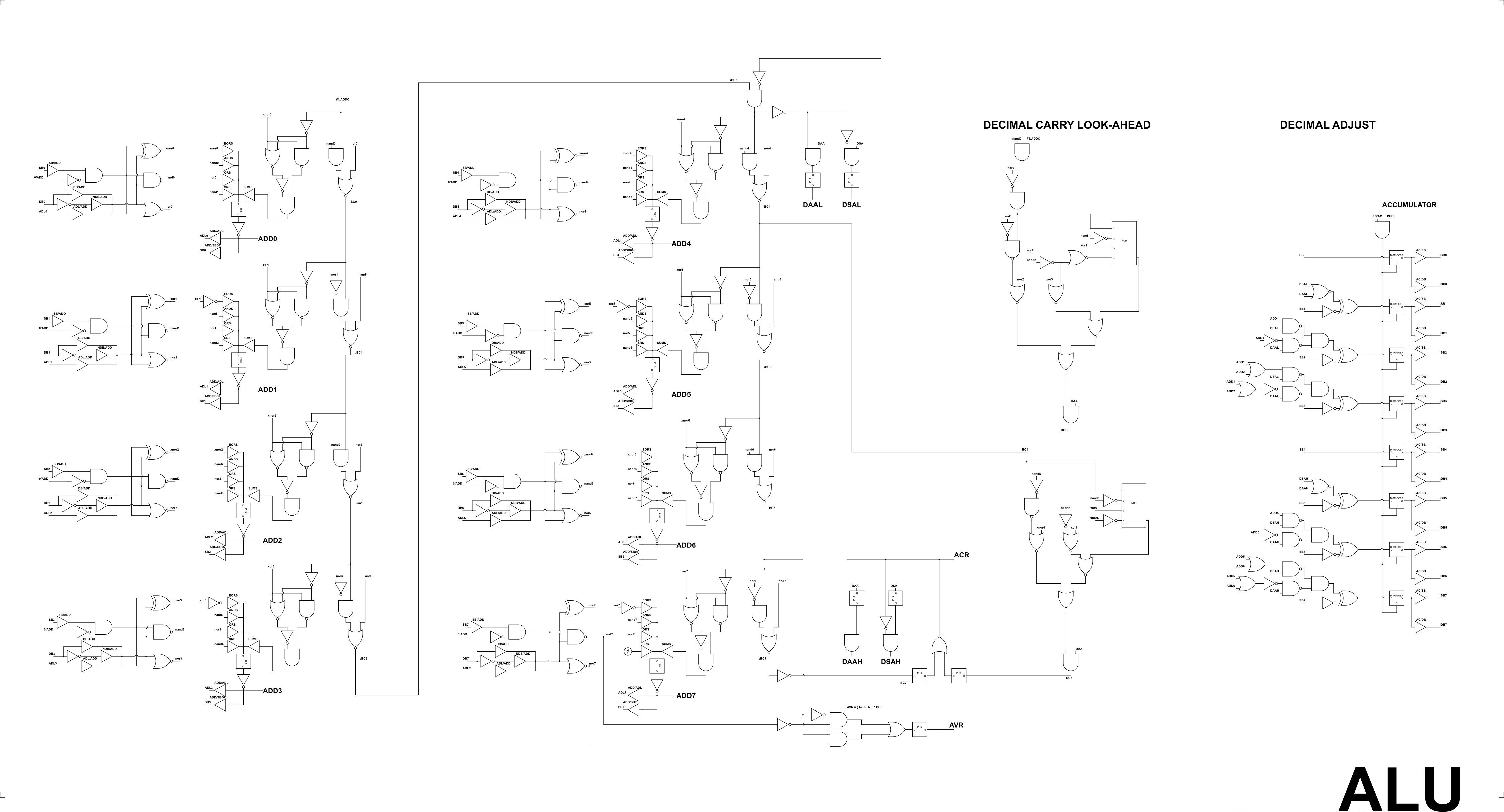

Todays speccy: ALU logic circuit
Later I maybe optimize SUM calculation, by replacing couple of NAND/NORs by XORs.
Don't want to mess with inverted carry chain ATM :)

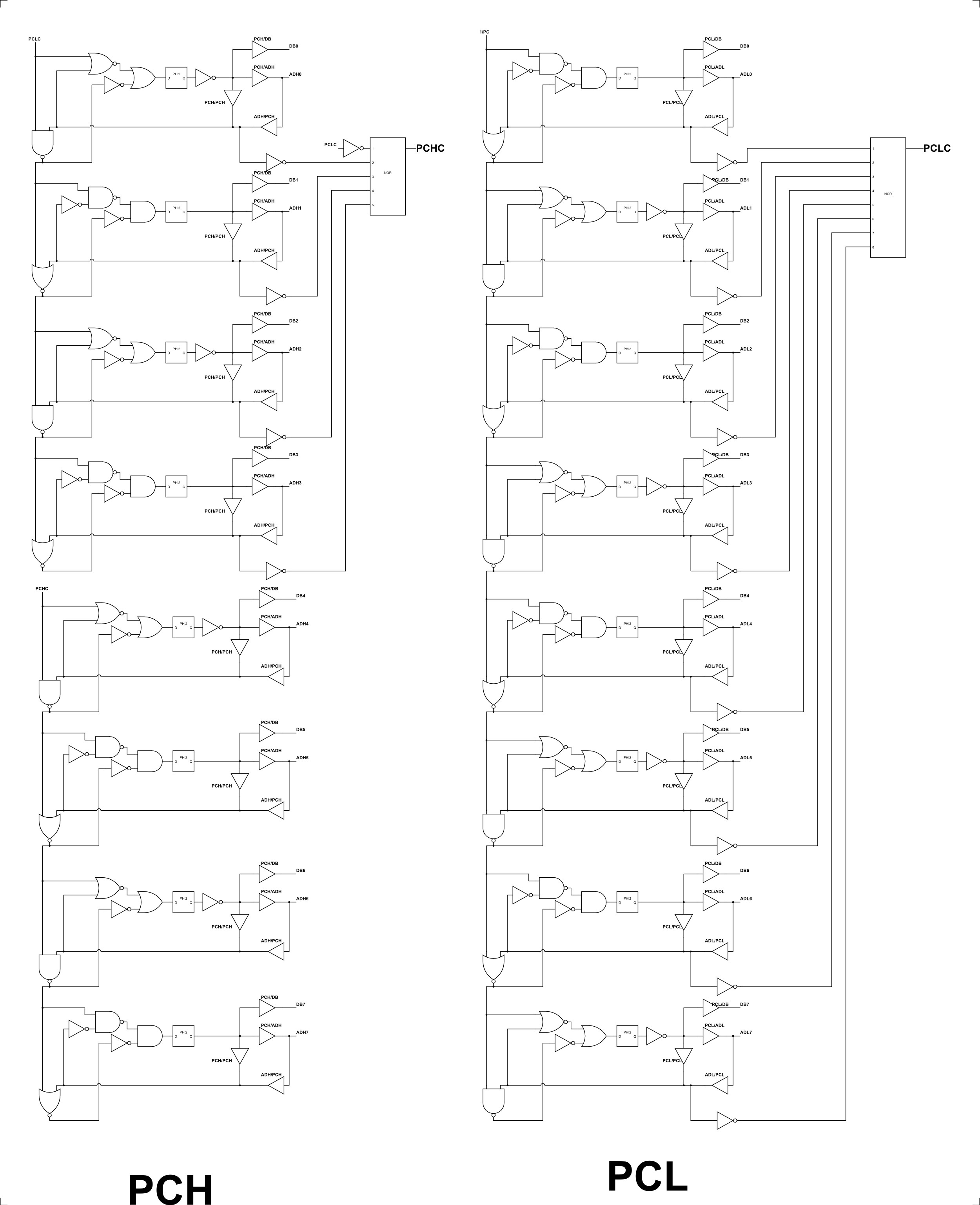

Todays speccy: Program Counter logic circuit
