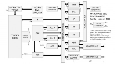

Hello everyone!
I found this project here:
viewtopic.php?f=12&t=5811
I'm doubt about architecture. Is it correct for a 6502?

Re: Build 6502 with TTL components
That's for his microprogrammed 6502-like CPU, not the 6502 itself which does not use microcode, nor does it have two ALUs. The 6502 and 65c02 data sheets will have the correct diagram. [Edit: Your earlier ones were better.]
But other folks might not be satisfied unless -- in addition to executing 6502 code -- some or all of the project's implementation details are the same as a 6502... details such as the project's arrangement of ALU's and internal buses, for example. Using that definition, then the C74 project would not be considered correct. (But that doesn't bother us in the slightest!
For the record, that block diagram appears here on the third page of JuanGg's thread "Micro programmed 6502-like CPU". The block diagram comes after the project has passed Klaus' test suite, so it is something which works.
Notably, there's no sign of a temporary data register - that's something which often turns up in re-implementations. Then again, it's only a diagram, not the actual machine. Although Juan hasn't visited here for a long time, it's good to see a project reach a successful conclusion!
(Garth, I believe you misread the diagram - there are not two ALUs, but two registered inputs to a single ALU)
I decided to follow this block diagram found in C74 project and its successor TTL 6502 Here I come (2015) and I haven't read all articles about both project, the questions:
Why this block diagram C74 project have a lot of registers in compare with the 6502 block diagram?
What modifications in C74 project we did to aim at speed?

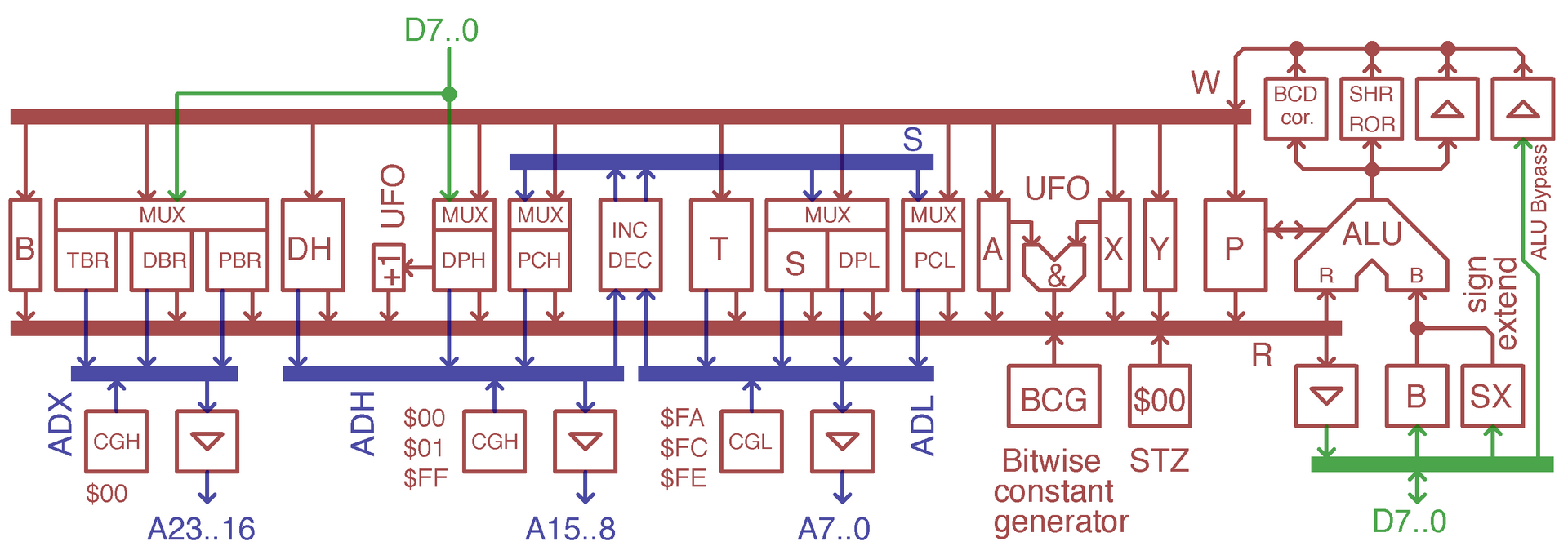

bmab wrote:
I decided to folow this block diagram found in C74 project and its successor TTL 6502 Here I come (2015) and I haven't read all articles about both project
BTW, this project is the same one described at the C74 project link. You may enjoy this video of a presentation about C74 by Drass at this event.
(The successor to C74 has not yet been built, and may perhaps never be, but the plans are quite far advanced; see 100MHz TTL 6502: Here we go! )
My point is, there can be various methods that all accomplish the same thing.
ps- Sean is correct about the added features. However, even without those added features, the C74 block diagram still does not match that of an actual 6502. For example, the C74 uses microcode rather than a PLA. This is one reason there are more registers -- for example, the pipeline registers, which are not visible by the programmer. ETA: oops, they're also not shown in that diagram!
About the "extra" registers - I don't know the C74 in detail, but it's worth noting
- there's more storage in a CPU than the programmer-visible registers
- a "register" in NMOS technology may need as little as one transistor per bit using the design style seen in the 6502 which means it takes up minimal space - at least, when "register" is allowed to include "transparent latch"
In this sense, the 6502 ALU has registers on both inputs - but you don't always see those in a block diagram.
But it may be that the "extra" registers you are seeing relate to extra functionality, as Jeff notes.

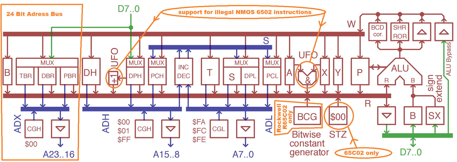

It's been a while, and I don't remember too much of the details...
Original C74 block diagram:
Tried to mark the parts which you probably won't need in orange:
Address Bus Bit 16..23: only 65816 has 24 Bit address bus, NMOS 6502 and 65C02 have 16 Bit address bus.
Anything labeled "UFO" is support for illegal NMOS 6502 instructions (which were "UnFOrseen by the original NMOS designers", long story).
65C02 has STZ instruction, while NMOS 6502 has not.
BCG (Bitwise constant generator) is support for the Rockwell R65C02 Bit testing/manipulation instructions (NMOS 6502 and non_Rockwell 65C02 lack them).
