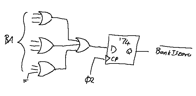

... Adrian's post made me stop and ask: "If I can use a '540 to do the inversion before latching the result then why must I wait until PHI2 high before beginning address decoding?"
Let's say I'm doing some combinatorial logic on the Bank and Address lines. And I want to know if the bank address is zero - I can use four triple or gates wired together to detect 8 bit zero (active low). As long as the result is valid and latched before PHI2 goes high then I have practically no propagation delay after PHI2 goes high. The work is already done and latched.
If we assume a I'm using a W65C816S6TQG-14 with VDD at 5V and with a 20Mhz clock.
Address Predecode.png (10.41 KiB) Viewed 8829 times
then I have measured that the address lines become valid after 10 to 11ns. And the bank address lines become valid maybe a bit before 13ns*. This gives around 12ns to do address 'predecoding' and I think in systems with fast clocks that could be quite useful.
Bank is Zero Latch.png (9.53 KiB) Viewed 8829 times
If I use four 74LVC1G332s with VCC at 5V and latch their result into a 74LVC1G79 also with VCC at 5V then I get a total propagation delay across that little circuit of 1.6ns + 1.6ns + 1.6ns. Let's just call it 5ns. And that fits easily in the 12ns I had remaining (25 - 13).
Of course after thinking I was really smart to have worked this out I clicked that this is probably the method that 6502 systems have used to deal with address decoding and chip selection since their have been 6502 systems. And probably a lot of 65816 systems too; the WDC suggested circuit just constantly latches the bank address while PHI2 is low. It's only the Bank-Address-is-disappearing restriction in my head that made me think I should only start doing address decoding after PHI2 has gone high and after the '573** has stopped latching.
* Judged by looking at failures at higher clock speeds. The datalines are too chatty for me to actually measure.
** [Edit] Updated '574 to '573. Brainfart or finger trouble but I should have typed '573. Thanks to Garth for spotting that.
Re: Quickest method to detect 8 bit zero using discrete ICs
With all 65xx systems, the entire address, including the bank address on the'816, must be valid and stable for address decoding to begin before Φ2 goes high.  It has always been this way.  This is covered in the first chapter (after the index page) of the 6502 primer, at http://wilsonminesco.com/6502primer/addr_decoding.html .  The circuit WDC publishes in the '816 data sheet uses a '573 for latching the bank address.  The '573 is a transparent latch, so the output follows the input until Φ2 rises, whereupon the value gets locked in to free up the data bus.
There is something quite important there, but I wouldn't say it exactly that way myself.(*) I hope this isn't mere pedantry - sometimes it makes good pedagogic sense to be less than completely accurate, and sometimes it's also practically sufficient. But pushing an '02 or '816 system to the highest speeds does need an accurate model.
It is true that the 816 uses the databus for two purposes, and so it's necessary to capture the high bits of the address before phi2 rises. It's useful (but not necessary) to use a transparent latch to do that capture, as it gives you more time, and therefore allows the possibility of running faster. And it's a nice idea to do some of the decoding upstream of that latch - maybe allowing for a smaller latch.
Personally I like to distinguish between an edge-sensitive and a level-sensitive capture by referring to the former as a flop or flip-flop and the latter as a latch or a transparent latch.
(*) Some 6502 family peripheral chips capture their chip select inputs on the rising edge of phi2, I think, and for those chips it is necessary to get the decoding done before that. Otherwise, in a simple '02 system, the rising edge of phi2 is merely a convenient timing point. It's the falling edge where work is done, and it's relative to the falling edge that timing constraints apply. In an '816 system, the rising edge of phi2 does serve a timing purpose. Systems which use the first half of the cycle for other purposes, such as video access to RAM, also need to care.
