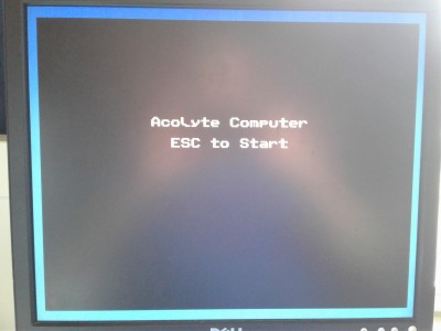

Now, my next issue is the auto-adjust on the screen. It seems my monitor "doesn't like" my new video ROM signals as much as previously. It is still running smoothly at 60 Hz, but I need to manually change the phase and horizontal position to get it to fit right.
Makes me wonder, should I add a border? The C64 and VIC-20 did that, a big fat border around the edges. Why? I suppose it's because older TV's were not as universal, and some edges could be clipped off? Anyways, if I added a small border around the edges of the screen, it would fit inside the monitor still, give me 38-column text, and I believe my living room TV with the VGA-to-HDMI adapter would display it better (it was clipping off the sides last time I tried).

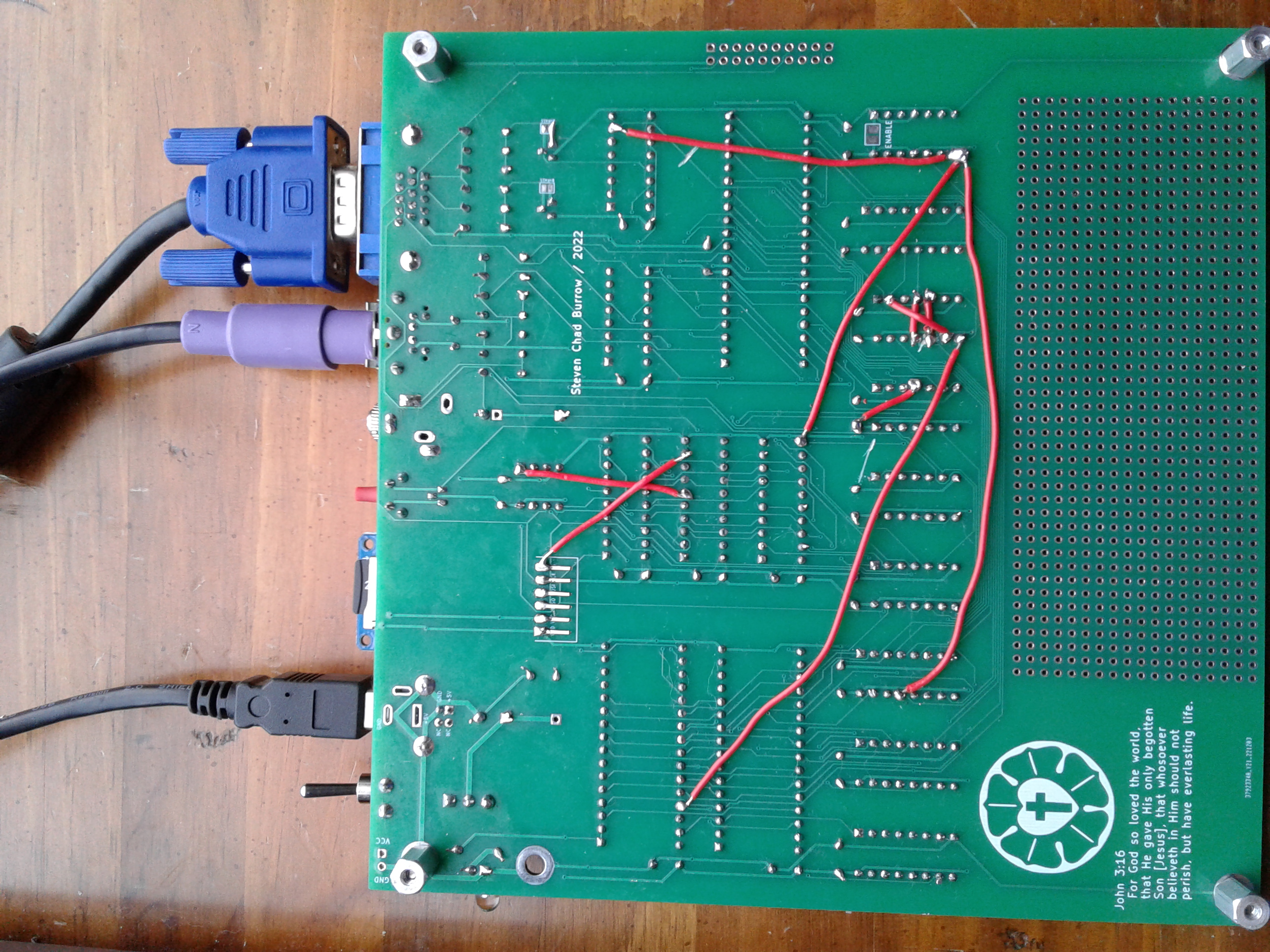

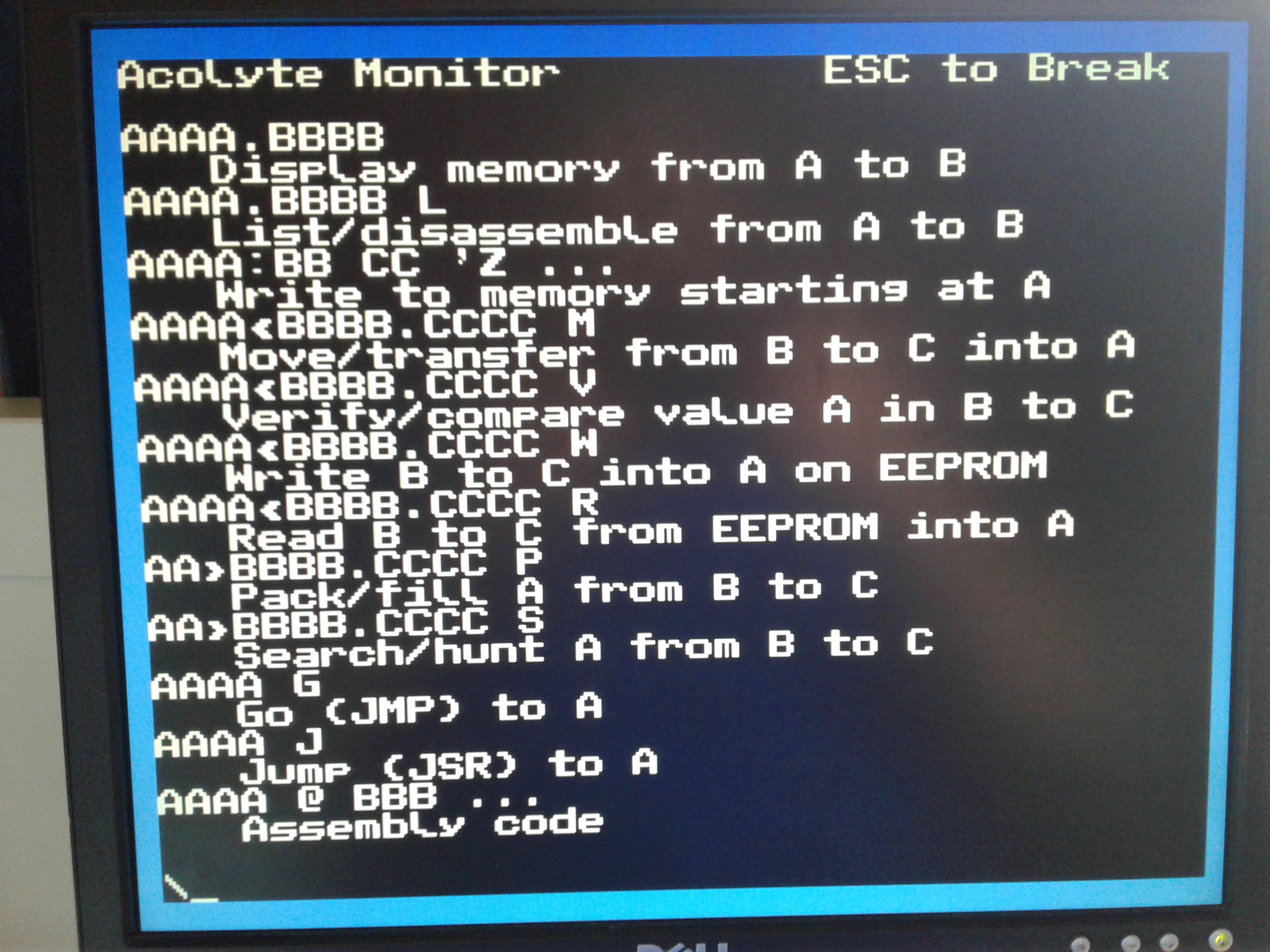

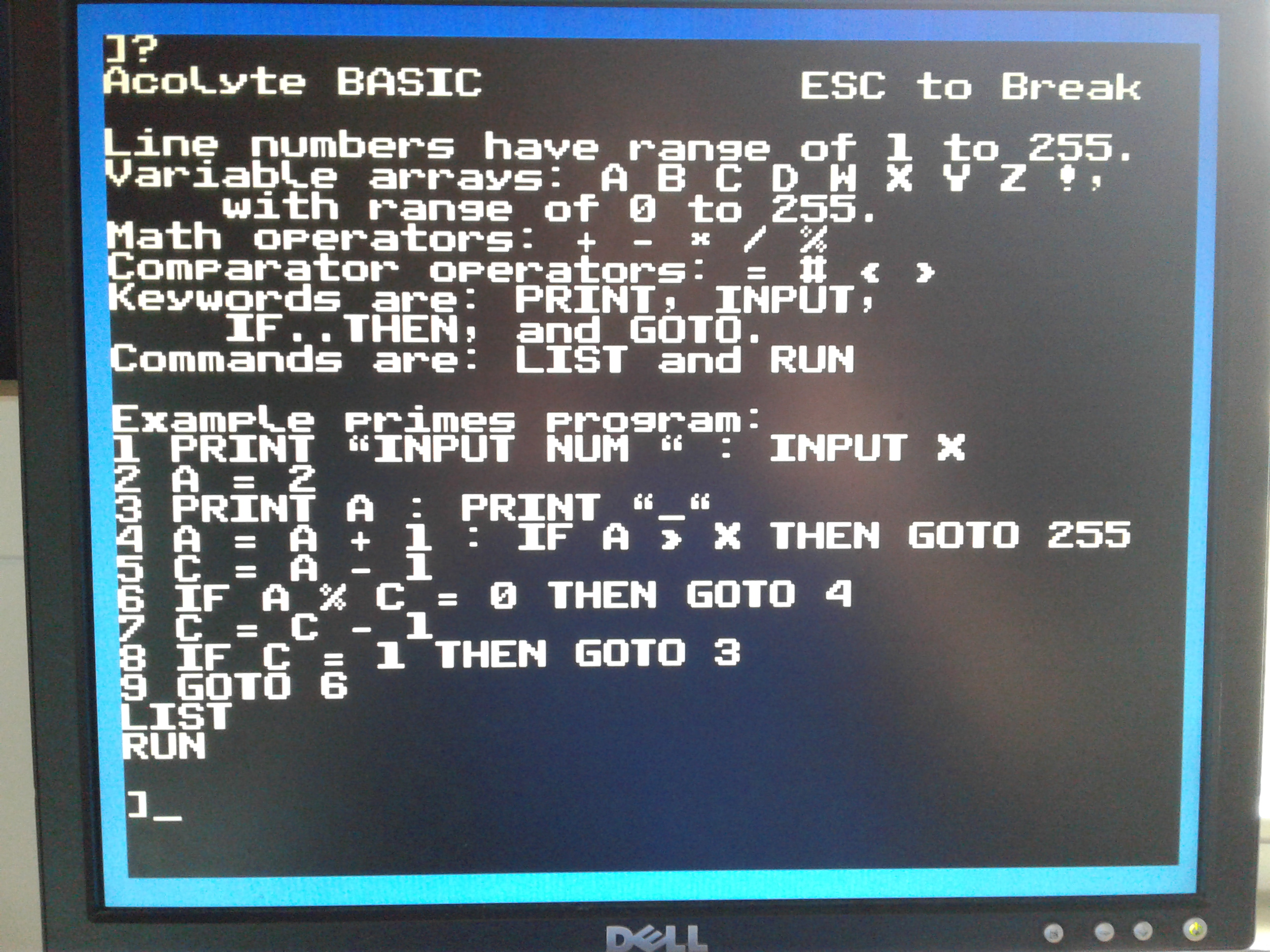

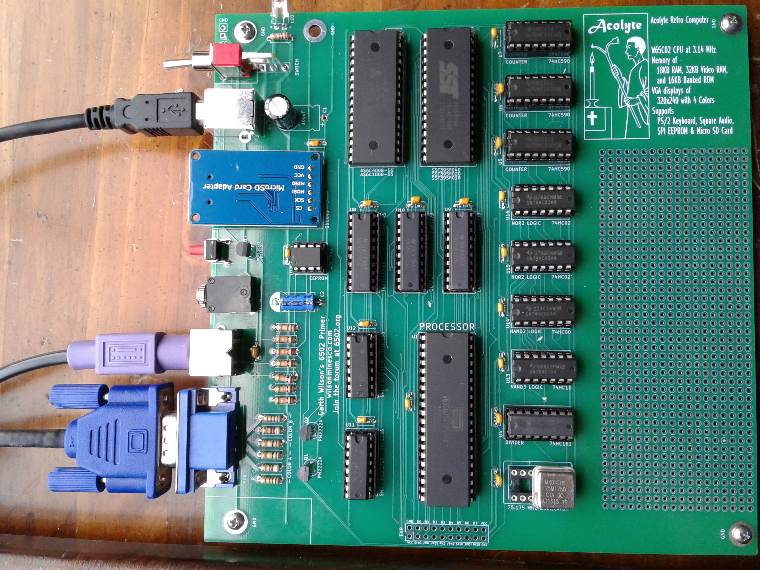

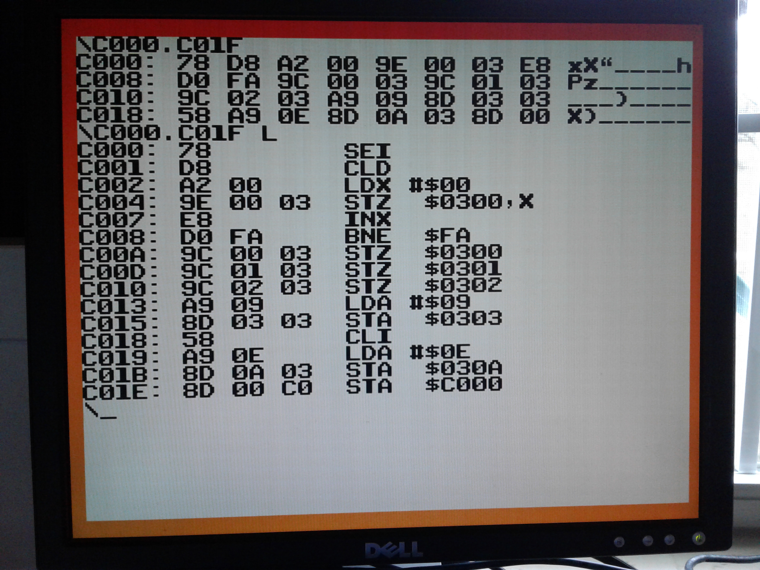

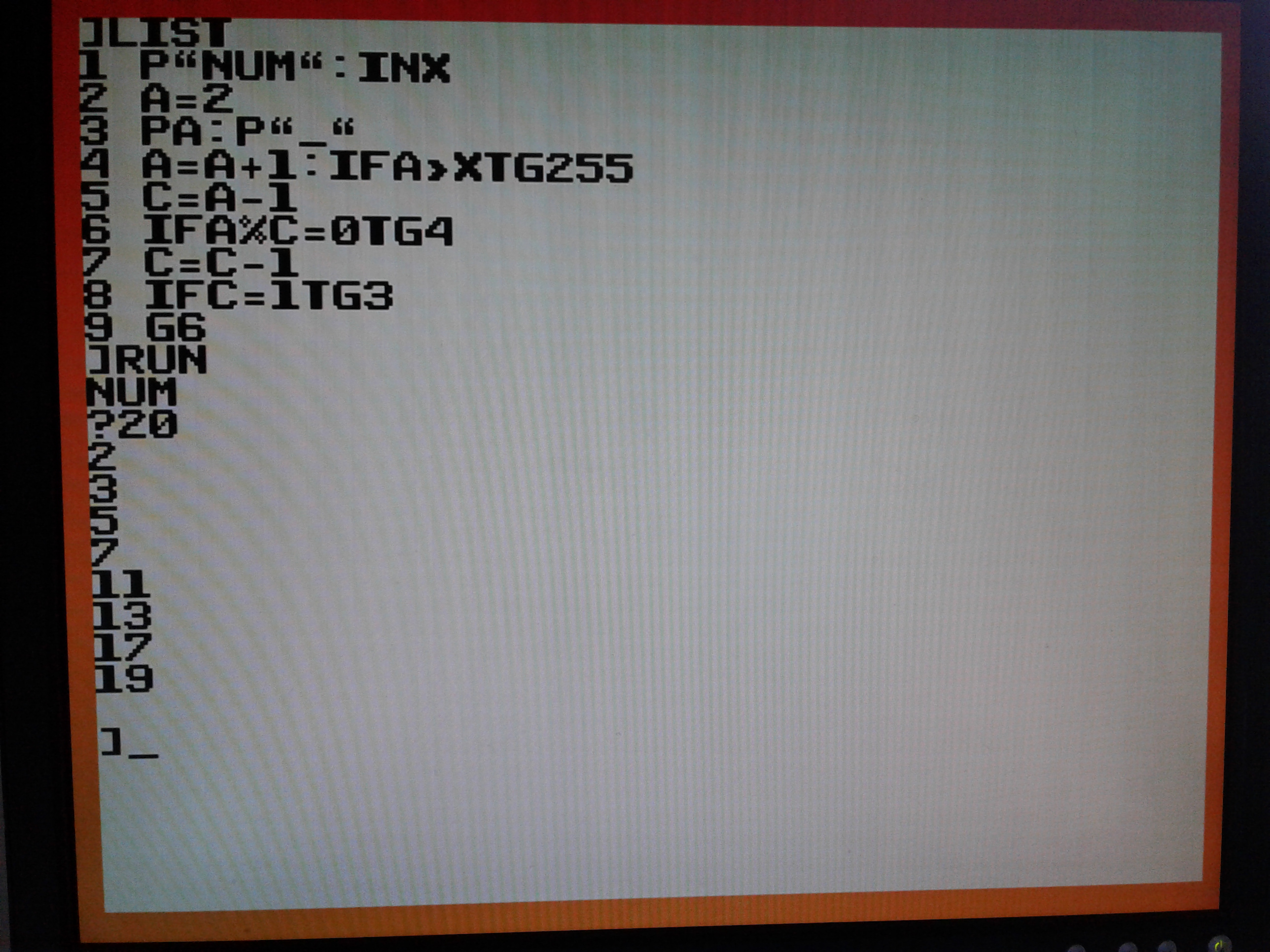

Alright, every feature on this board now works! Code, keyboard, audio, SPI EEPROM, and SDcard.
Attached are some pictures of the board and the surgery I did to it. Also attached are some pictures of the monitor and BASIC, with two different possible color schemes.
I also included the revised schematics (up to this point) which includes my surgery done to the board.
And then I'm including my code. Each bank is only 16KB, and the monitor and BASIC are both on Bank1. I'm using Bank2 as just a testing area right now. It is mostly uncommented, I plan on going back and commenting a lot very soon.
Lastly I'm including my SDcard code, which again is just for testing but at least shows the capability.
Now, the goal is to make a better design document, detailing everything on this board. This would also include commenting the code I have in Bank1. After that, I'm going to make a (good) game!
Well, there you have it. The Acolyte Computer is finally done.

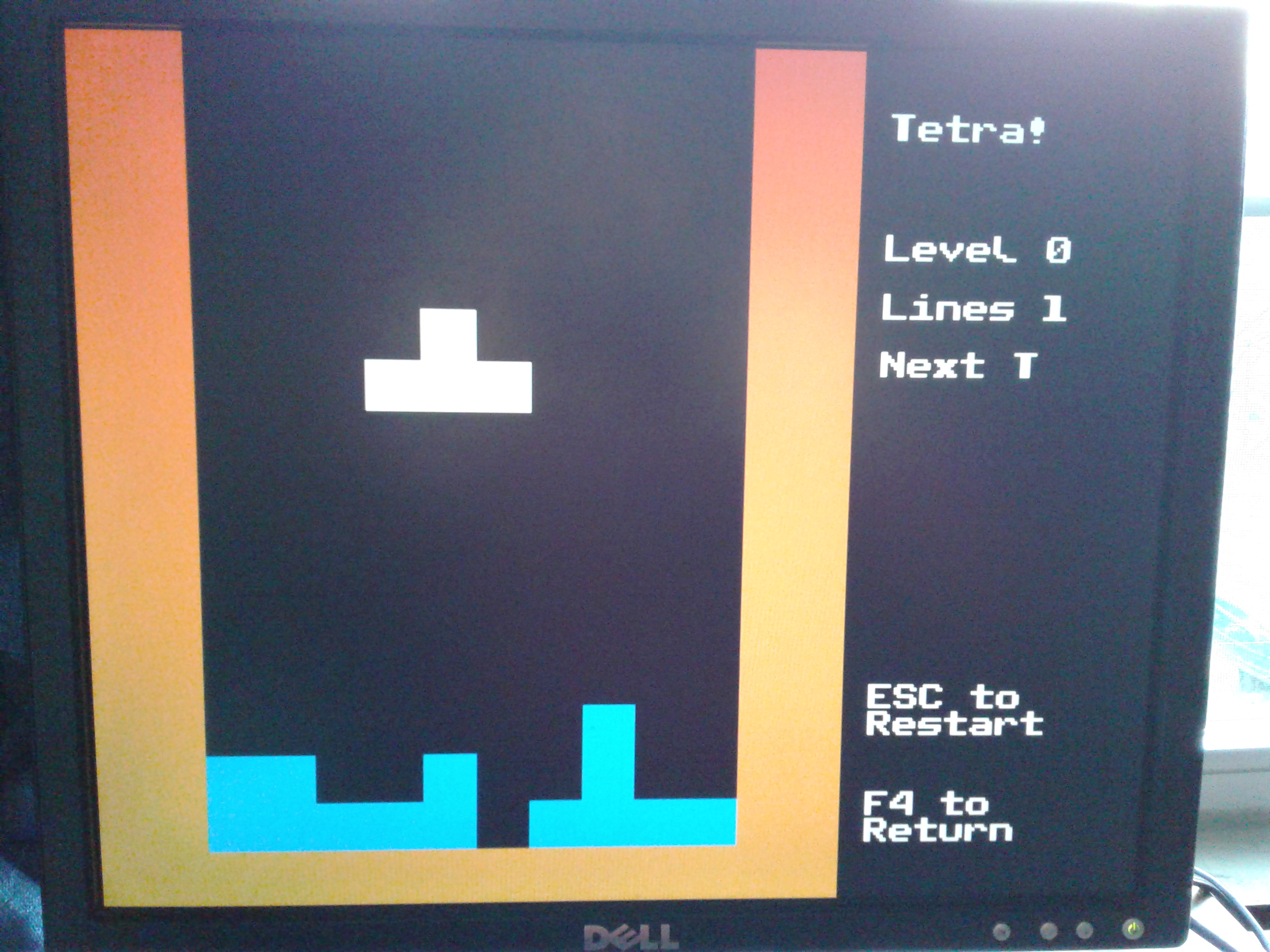

Probably the last update for a bit (maybe):
I got Tetris! I probably spent around 4 hours coding this (no comments, so I'm not including it here yet). I tried 2 other times and saw it failing. So, my recommendation is: If it doesn't look like it's working, just start over! And that really helped me.
I want to include the music, or at least sound effects. That will require a bit more testing than my simulator can handle, so that process would be much slower. It would also be cool to make the blocks look a bit better. But overall, it's 99% done.
Up next would be a MUCH more detailed design document.

So, I got the boxes to be a tiny bit better looking. I then tried doing some sound. I got a simple Tetris theme going, although it sounds "sickly". I got some beeps and boops whenever you complete a line and all that, but I found that they slow down the game WAY too much. The audio is directly manipulated by the 6502, so if you want to play a tune, it must dedicate nearly all processing power to the music. With keyboard interrupts also going, the program starts stuttering the sound, and when it is finally done the next piece is halfway down the field! So, I just removed sound entirely. I'll try again later. I know there are ways to make it work.

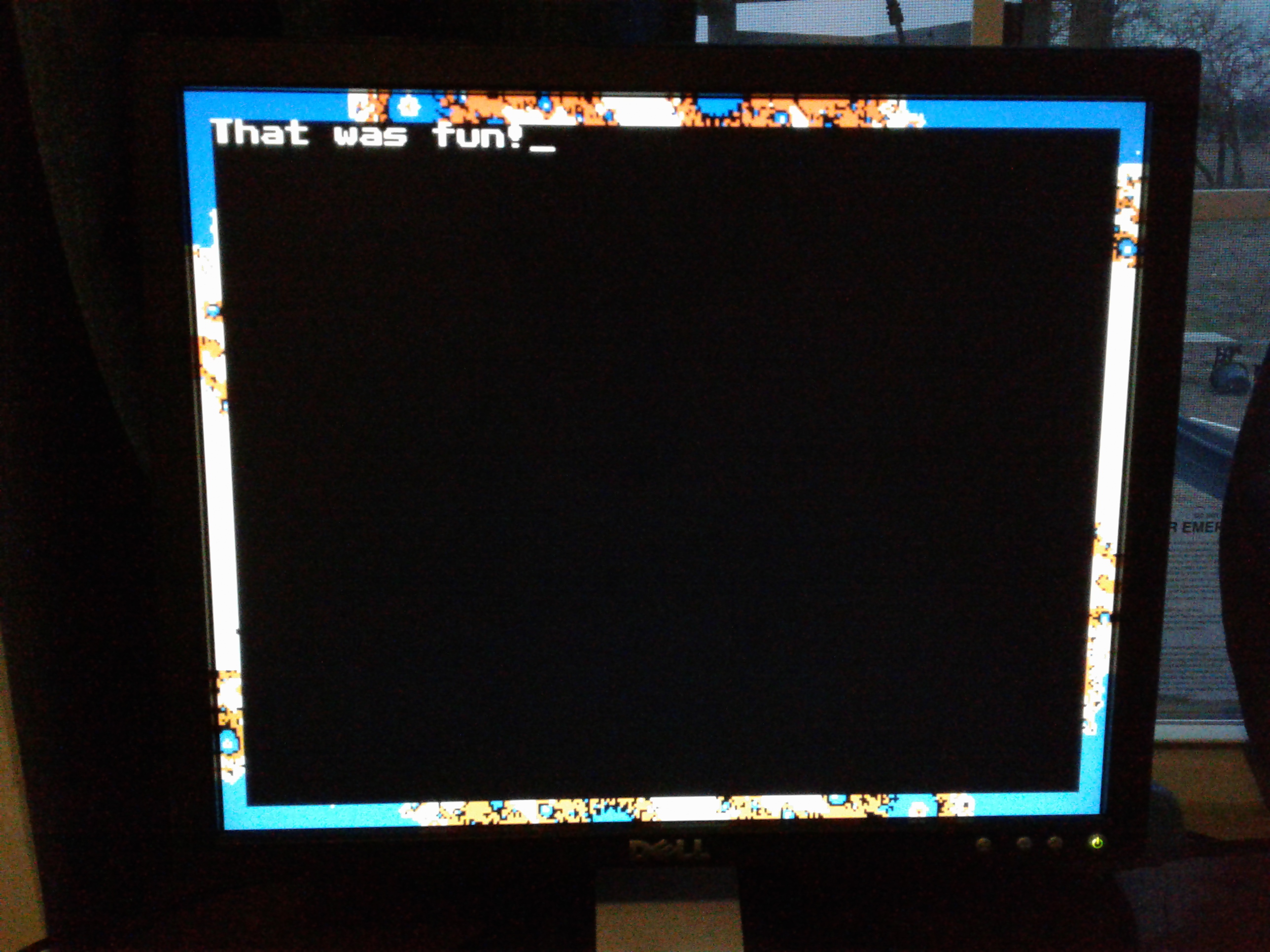

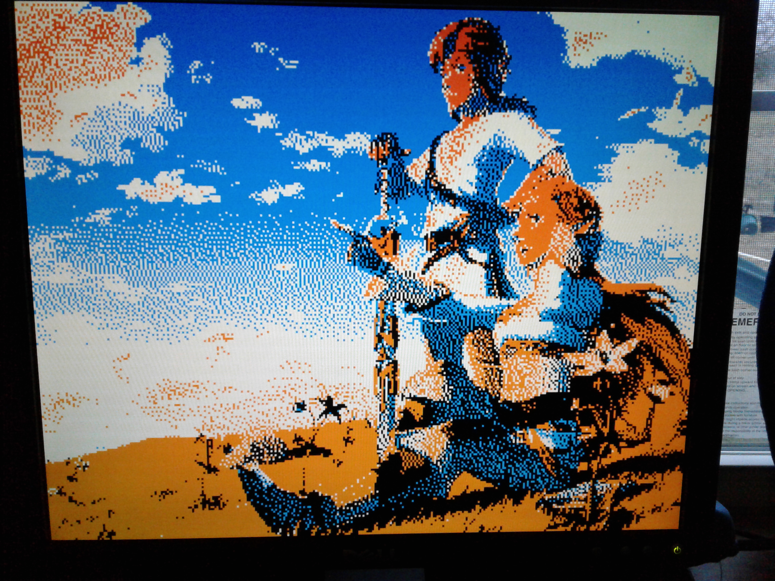

Been working with the SD card code this morning. Learning what it can do, etc. Just wanting to show off some stuff.
Attached is my code for drawing a bitmap picture to the screen. It takes about 30 seconds to initialize and draw the whole thing. It's super slow because I use a lot of delays and pumps while reading. Using GIMP and my own C++ code, I can convert any ol' JPG into hex code within a couple of minutes, like I did with Link and Zelda (original here https://wallpaperaccess.com/full/3596270.jpg).
I'm thinking I will use this capability for a slideshow during our upcoming Math Appreciation Day in April 2023. Last year I was limited to 4 pictures because that's all the ROM could store. Now I will have 2GB worth of SDcard memory, plenty of room for pictures. If so, I'll probably tighten the code to make it quicker than 30 seconds to load.
I think the blue/orange combo is really nice. George (gfoot) had used this combo for some of his earlier VGA designs. I think it has a warm feeling and is pretty versatile, not harsh and alien like my (favorite) red/cyan mix I'm so used to. I also chose this because: blue + orange = white, exactly.
Just showing off, that's all.
Thanks everyone!
Chad

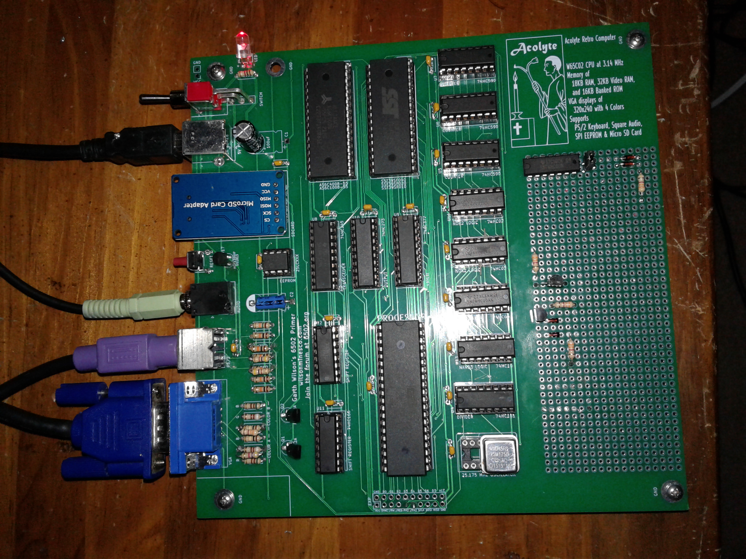

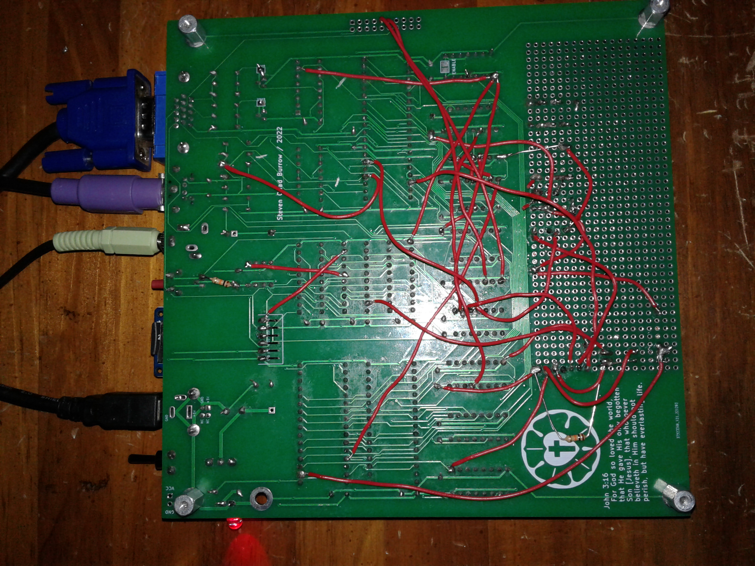

Update!
Attached are the latest schematics and some pictures of the board. What a mess! Compare with the earlier bodge wires, and yeah, this is going overboard.
Some improvements today in particular:
1) I connected PHI2 directly to BE, bypassing 3 logic gates. It is working flawlessly. I think one of y'all had suggested it, so I tried it, and it's great. Thank you.
2) I added my RAM expansion, giving it now a full 64KB of RAM and 128KB of ROM. It is tied to the audio-out line, so not always desired, and I have a jumper-connector-thing to select using it or not.
3) I reduced it by one chip! (Don't look at the fact that I actually ADDED a chip to *this* board, ha ha) After the PHI2 = BE thing, I decided to repurpose another gate, shift things around, and now I'm using diode logic and a transistor to help out. And it seems to work great!
4) I clipped the transistors on the color line long ago, and it has worked great. I also adjusted the colors slightly to make make a monochrome screen differentiate between all colors easier. The color change is so slight it's barely noticeable, but behind the scenes it just got more functionality.
5) I've learned a lot, and that's very important.
SDcard is working flawlessly, I have a 4 picture slideshow going right now, been running for hours without any issues.
And that's about it. Just hardware changes. Only small updates to code, making things easier and better. All the same functionality.
Thanks everyone!
Chad
