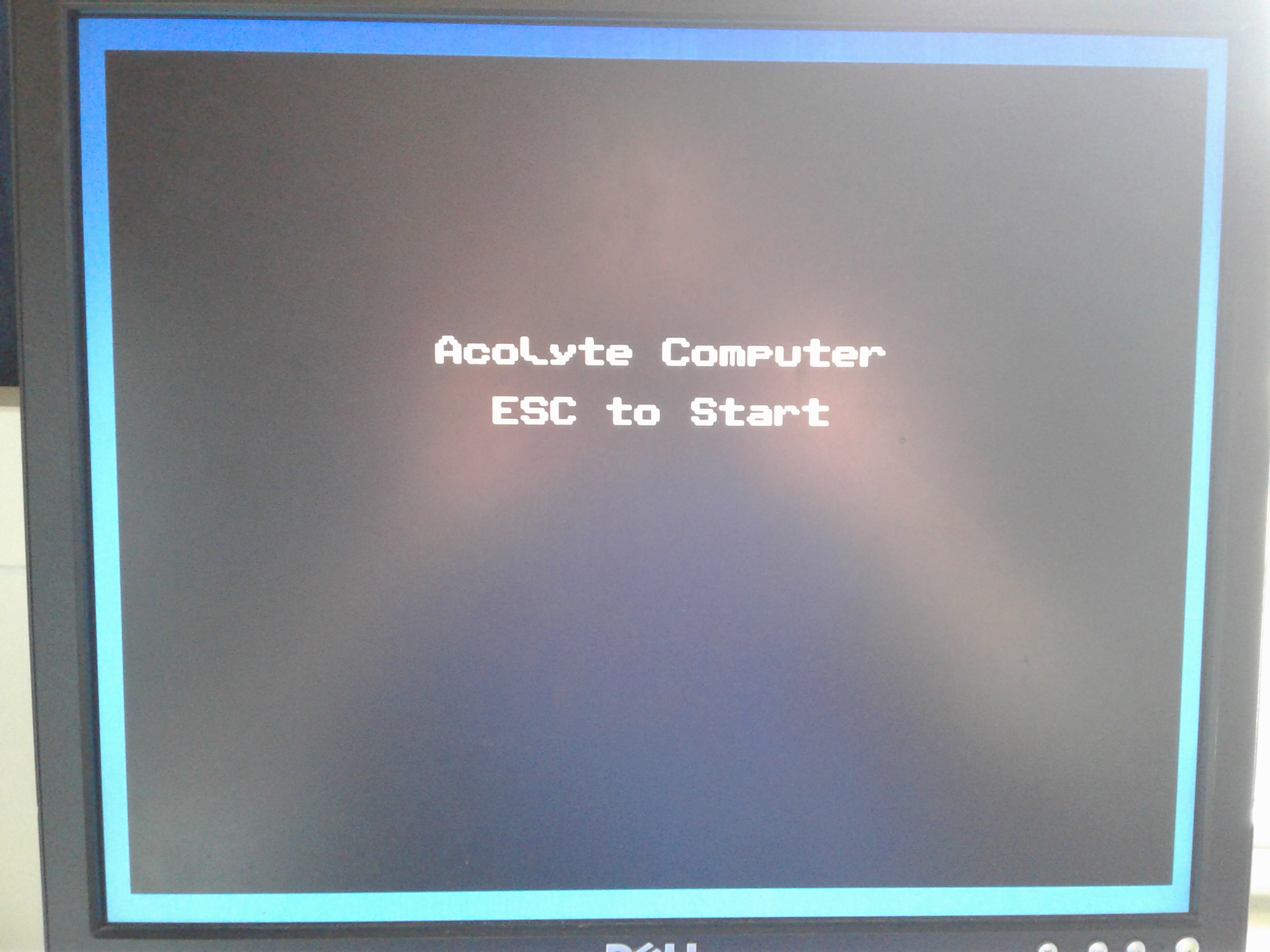

Alright, every feature on this board now works! Code, keyboard, audio, SPI EEPROM, and SDcard.
Attached are some pictures of the board and the surgery I did to it. Also attached are some pictures of the monitor and BASIC, with two different possible color schemes.
I also included the revised schematics (up to this point) which includes my surgery done to the board.
And then I'm including my code. Each bank is only 16KB, and the monitor and BASIC are both on Bank1. I'm using Bank2 as just a testing area right now. It is mostly uncommented, I plan on going back and commenting a lot very soon.
Lastly I'm including my SDcard code, which again is just for testing but at least shows the capability.
Now, the goal is to make a better design document, detailing everything on this board. This would also include commenting the code I have in Bank1. After that, I'm going to make a (good) game!
Well, there you have it. The Acolyte Computer is finally done.

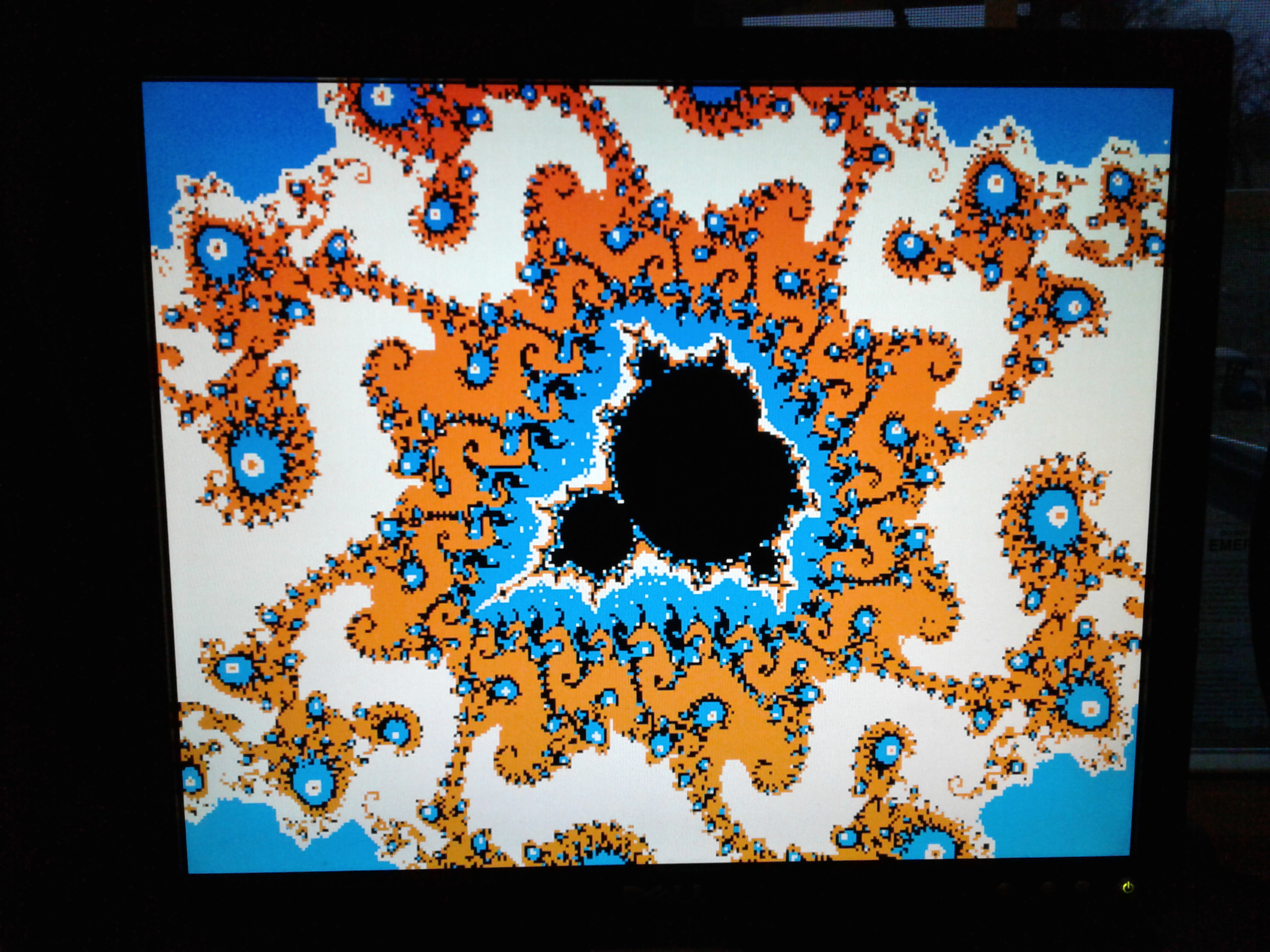

Been working with the SD card code this morning. Learning what it can do, etc. Just wanting to show off some stuff.
Attached is my code for drawing a bitmap picture to the screen. It takes about 30 seconds to initialize and draw the whole thing. It's super slow because I use a lot of delays and pumps while reading. Using GIMP and my own C++ code, I can convert any ol' JPG into hex code within a couple of minutes, like I did with Link and Zelda (original here https://wallpaperaccess.com/full/3596270.jpg).
I'm thinking I will use this capability for a slideshow during our upcoming Math Appreciation Day in April 2023. Last year I was limited to 4 pictures because that's all the ROM could store. Now I will have 2GB worth of SDcard memory, plenty of room for pictures. If so, I'll probably tighten the code to make it quicker than 30 seconds to load.
I think the blue/orange combo is really nice. George (gfoot) had used this combo for some of his earlier VGA designs. I think it has a warm feeling and is pretty versatile, not harsh and alien like my (favorite) red/cyan mix I'm so used to. I also chose this because: blue + orange = white, exactly.
Just showing off, that's all. :) Thanks everyone!
Chad
