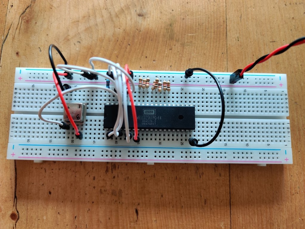

I thought I would build a simple NOP tester thingy. I want to prove to myself that I don't have a faulty 65C02.
I decided to forget the LEDs and use my (not very good) 'scope
I expected a square wave on the address lines doubling in wavelength as I work up through the address lines A0-A15.
I further expected A0 to be twice the clock frequency.
I indeed got exactly that - that's good
-but-
Can anyone explain the glitches in voltage in the address lines that go in time with the clock? (Address lines are yellow, clock blue)
Also, why is there a double trace on the Low part of the address?
This is A0
and this is A1
Edit: I forgot to say, the whole idea of the NOP tester was to look for oddities with IRQs. You may remember from above that one of the things I seem to be encountering are spurious (and lots of) interrupts, even though IRQ pin is tied high. With the NOP tester I should get a nice sequence of binary count on the address pins, if this sequence suddenly goes out of sequence that tells me there are spurious interrupts happening. If it counts nice and sequentially then that proves there aren't interrupts happening. Further, the 6502 is out of my main circut, further removing uncertainties.

If an interrupt were taken, you'd see three consecutive writes - you should be able to see that clearly on the RnW line.
You have no bypass capacitors, by the look of it, so it's not surprising that each clock edge is causing a bounce seen on other signals.

Ahh, right. Thank you! Simple as that.
I'll look at the R/W line.

As Ed noted, there are no bypass capacitors. Try adding some and see what happens.

Yep. That was it. Bypass capacitors improved things a lot. Thanks for that. I just wondered what it was. I will know if I see it again!

In digital circuits, bypass capacitors are like money: you can never have too much. :D

Well, again, it's not the MHz that hurts you, but rather the rate at which signals slew from a logic-low level to a logic-high level, or vice-versa; and the W65C02 and 74AC parts have much faster edge rates (slew rates) than what I got going in 1986 or '7 with 2MHz parts on a solderless breadboard. Jack Ganssle's YouTube video, "I Only Probed the Board With a Scope - Why Did My Board Crash?," the part from about 2:20 to 3:00, graphically shows on an oscilloscope that the ugly ringing remains unaffected as he turns the clock frequency up and down. (This is linked to in the AC-performance page of the 6502 primer.) The #1 thing you have to keep clean is the clock line; but these faster changes on other lines can inductively couple into the clock line. If it's bad enough, the clock line will now appear to have extra edges that are coming too close together for parts to meet the timing requirements.
