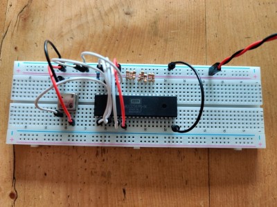

I thought I would build a simple NOP tester thingy. I want to prove to myself that I don't have a faulty 65C02.
I decided to forget the LEDs and use my (not very good) 'scope

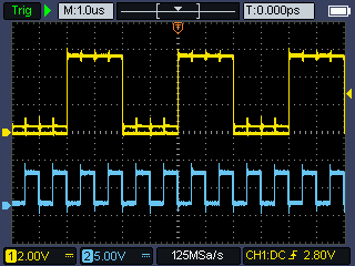

I expected a square wave on the address lines doubling in wavelength as I work up through the address lines A0-A15.
I further expected A0 to be twice the clock frequency.
I indeed got exactly that - that's good
-but-
Can anyone explain the glitches in voltage in the address lines that go in time with the clock? (Address lines are yellow, clock blue)
Also, why is there a double trace on the Low part of the address?
This is A0

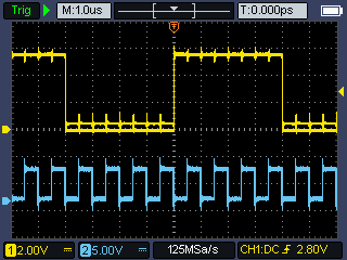

and this is A1

If an interrupt were taken, you'd see three consecutive writes - you should be able to see that clearly on the RnW line.
You have no bypass capacitors, by the look of it, so it's not surprising that each clock edge is causing a bounce seen on other signals.

As Ed noted, there are no bypass capacitors. Try adding some and see what happens.

Yep. That was it. Bypass capacitors improved things a lot. Thanks for that. I just wondered what it was. I will know if I see it again!
