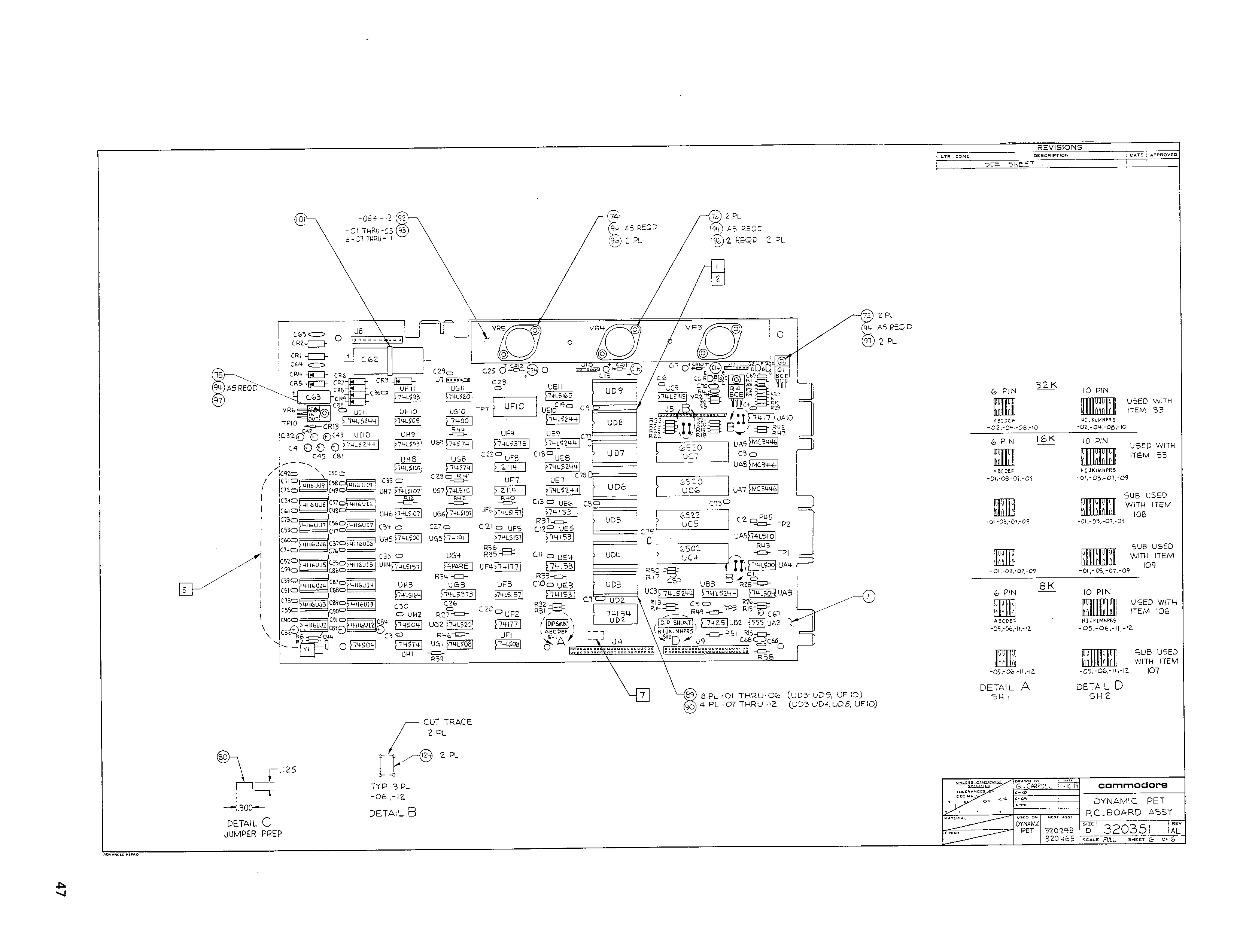

The schematic specifies a pair of LM340-5s to generate two separate regulated +5V supplies, a 7812 for the +12V regulator, and a 7905 for the -5V regulator. Of these, only the 7905 is actually present in your photo, next to the big silver 16V capacitor.
In place of the other three are a pair of LM323Ks for +5V regulation and an LM340-12 for the +12V. These are the big cans embedded in the black heatsink, which has a relatively new-looking sticker on it. It may be evidence of a repair already carried out, or merely substitution of equivalent parts during manufacture.
This should lead you to four voltages which can be tested.

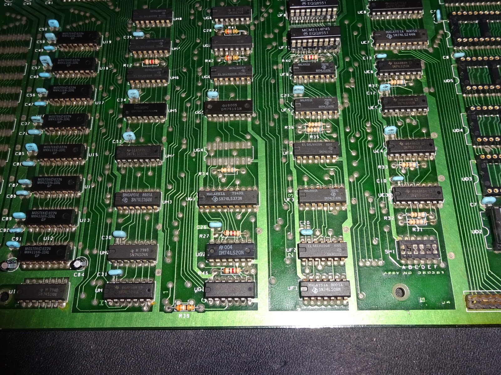

@Martin A: it might be a RAM upgrade, or probably is because the type of chip in the second memory bank is of the type NEC PD416 while the first memory bank has MK4116N chips. Did the RAM upgrade need any changes done to the board or could you just solder in new set?
Also, In my previous post i was posting some pictures asking if "this was normal". Comparing different pictures of PET 2001N boards, i think ive found some differences in at least on of the parts, labelled: SH1.
It has pins called A B C D E F. On all the pictures i find, the connections on A, B, and E seem cut, while the connections on C, D, and F seem untouched.
On my board, it is the following: A, B, D, and E are cut, while C, and F are connected.
sadly my board does not have the parts labelled so im attaching a picture where the board is clearly labelled.
Emmanuel
