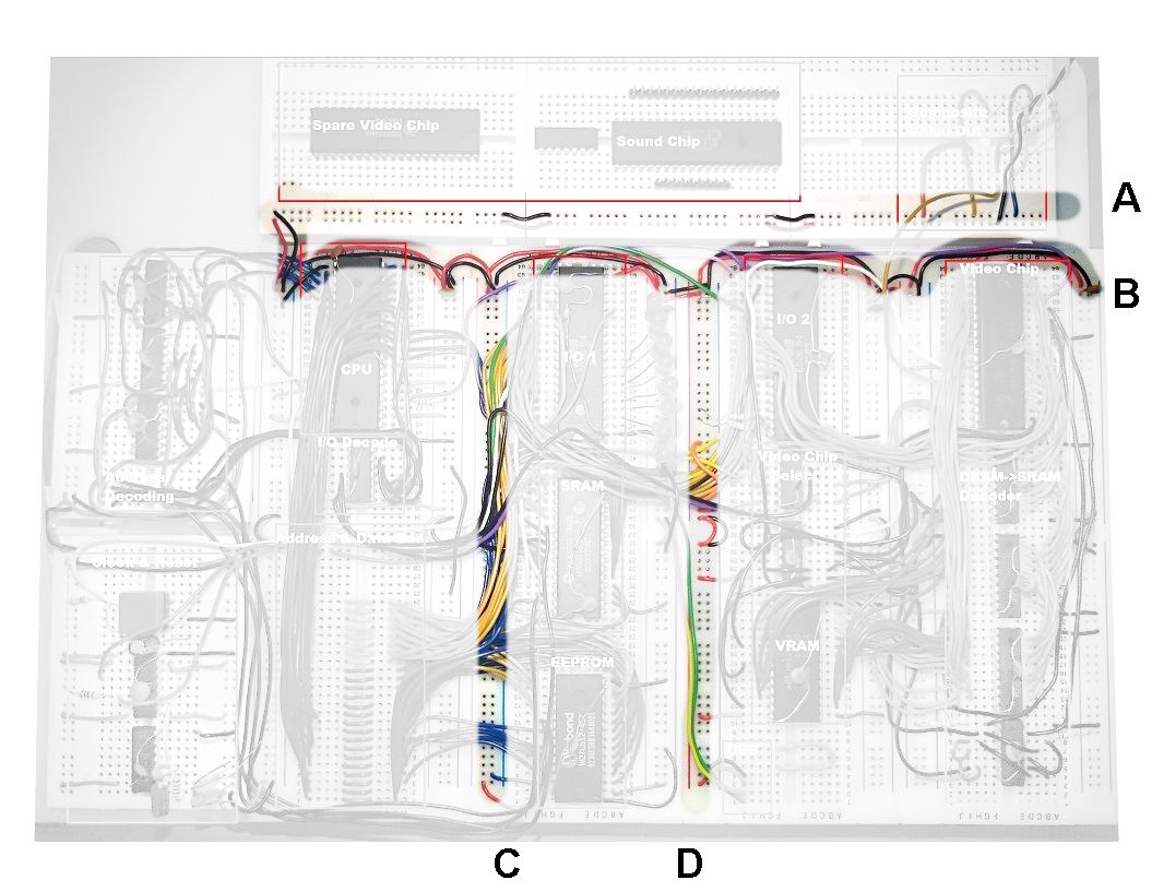

When I say connections, I'm including both the signals and their return paths. :!: The image above shows that these form a loop, with the signal wiring in yellow on the bottom and left of the loop, and the return wiring in black along the top and right. (For clarity I'll ignore the red Vcc wires, but they too act as a return path.)
The signal wiring offers little scope for improvement. It's long, and not much can be done about that. But can the return wiring be improved? Yes, and one improvement is to add a diagonal directly between the two chips. But, interestingly and counterintuitively, that's still not the ideal path -- the route the return current most wants to take. What it wants most of all is to hug the signal path, even though that's *longer* than a direct route (ie, diagonal)! :shock: So, I'd consider adding a ground wire that takes the same, long-ish route as the yellow signal path. (This new ground wire needs to be connected at both ends; otherwise it isn't a path.)
Of course the CPU and RAM aren't the only chips, and signal connections go every which way, helter skelter. All these signals paths should have prospective return paths available, but that'd result in a complete rat's nest. A ground plane would solve the problem -- because it attaches every point with every other point -- but we can't do that, either.
More practical (though much less satisfactory) than a plane is to provide a coarse grid of return connections. The idea of the grid is to help ensure that any two arbitrary points will have a return path close by. The grid needn't be perfectly orderly. But, operating on the premise that any two arbitrary points may have a signal path between them, we want a return path reasonably close by. As an example, consider C and D in the image below. I would add a horizontal path from C to D, and also extend the path to meet the columns to the left and right. I'd also put a return path from A to B. Right now there's no chip at A, but presumably there will be one in future, and it might have a signal path to B. And right now the only return path to B involves a drastic detour. I hope I've managed to write this in a way that makes some kind of sense. If there are some edits later it won't be surprising. :roll:

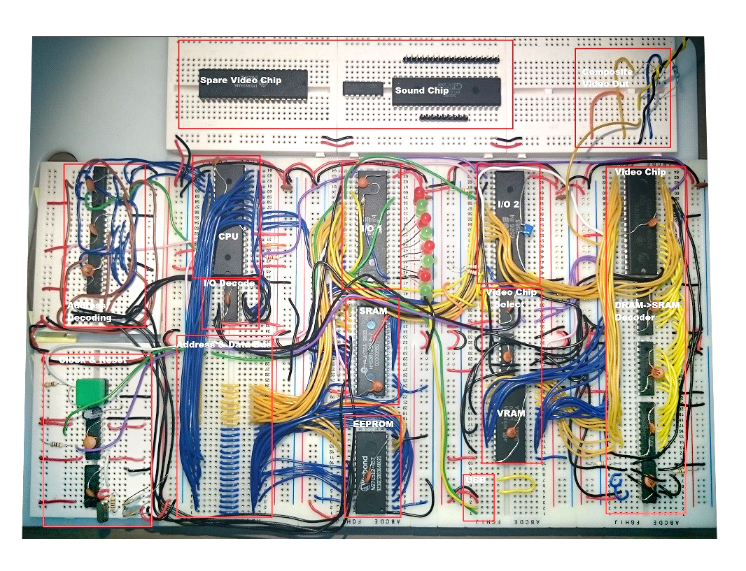

Everyone, thank you very much for the enlightenment. I have attached a bang up to date higher resolution picture as the one Dr Jefyll found is now more than 2 years old.
I have learnt some fundamental things here, and so amazed that I have somehow managed to build a fully featured microcomputer :o

The picture shows the full set up as it is today:
- Bottom row left to right : AY-3-8910, TMS9918a, 65c22-2, 65c22-1, 65c02, address decode logic. I will list everything else relative to this row for ease of identification.
- Above the AY-3-8910 is a 6551 ACIA
- Above the TMS9918a is the CAS/RAS address latching to connect to modern SRAM
- Above the 65c22-2 is the SRAM for the TMS9918a. Also, this 65c22 drives the SD card SPIO pins
- Above the 65c22-1 is the ROM (topmost) and SRAM. This 65c22 drives the BBC keyboard interface. The SRAM is the 70ns part working fine @ 5.36Mhz
- Above the 65c02 is more decode (3 to 8 decoder) to select one of 8 IO devices (I have 4 today - 6551, TMS9918, 2x65c22)
- Above the address decode logic is clock and reset circuitry, including the 4 bit counter which I use to divide the 21.4772Mhz crystal frequency down for use by TMS9918a, 65c02 and AY-3-8910

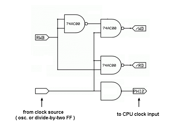

If you have to real estate, then this solution offered by BDD to produce a qualified write (/QW) should work as an alternative to delaying the clock to the CPU:
The AC logic is speedier than the HC logic. If this doesn't cure the problem then it may be elsewhere.

Of course you cannot rely on using slow RAMs to mediate timing errors :). So using BDD's suggested /WR and /OE logic (or perhaps the refined one by Dr Jefyll download/file.php?id=6403&mode=view) is highly recommended.

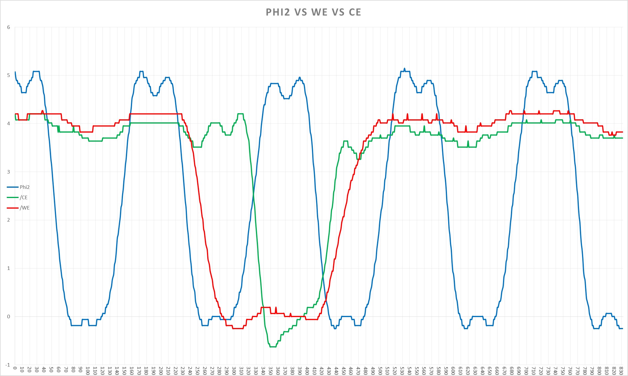

So I did a data dump out of my PC scope of Phi2 vs /CE and Phi2 vs /WE in to Excel, then aligned the time axis to show a graph of Phi2 vs /CE vs /WE. Hopefully you can see the jpeg.
What do you make of this - it looks ok to me, I think, but I am not sure what problem I am looking at any more! It appears that /CE is not far behing Phi2 going high, within 10ns, and /WE is around 20-25ns behing Phi2 going low. The distance between /WE and /CE is in the region of 80-90ns. /CE rises around 20ns before /WE.

Well, if there is no more difference between using a fast or a slower RAM then you are one step further!
If you going to increase the speed I recommend the /WE and /OE logic the way Dr Jefyll suggested. (BTW I wonder how many people use /CS for gating reads and writes. To me this is somehow "unusual" although it works. I do prefer the classic(?) way using /OE = PHI2 & RWB and /WE = PHI2 & !RWB)
