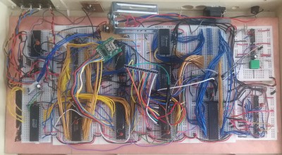

Everyone, thank you very much for the enlightenment. I have attached a bang up to date higher resolution picture as the one Dr Jefyll found is now more than 2 years old.
I have learnt some fundamental things here, and so amazed that I have somehow managed to build a fully featured microcomputer :o
Things I've learnt:
1) The 6502 is not off the bus during Phi2 low - the address bus will become valid sometime during this half of the cycle. I read the datasheet from GaBuZoMeu on the CRTC in more detail, and yes I can now see that it does need a multiplexor to allow access to memory without contention. My decoding logic has been qualifying all chip select lines with Phi2 - at the moment timing seems fine for 5.36Mhz, even though I can now see how to do this with more time for devices to respond during the second half of the cycle.
2) I had found my breadboard to have been a bit unreliable at times during the build - I did add both power and ground wires at various random places which seemed to help. I now have a better understanding of signal and return paths as outlined by Dr Jefyll, and so the reason why adding extra power and ground connections can help. I will also add some capacitors across the 5V and 0V lines - I assume this is to help smooth spikey demand current in fast switching devices.
The picture shows the full set up as it is today:
- Bottom row left to right : AY-3-8910, TMS9918a, 65c22-2, 65c22-1, 65c02, address decode logic. I will list everything else relative to this row for ease of identification.
- Above the AY-3-8910 is a 6551 ACIA
- Above the TMS9918a is the CAS/RAS address latching to connect to modern SRAM
- Above the 65c22-2 is the SRAM for the TMS9918a. Also, this 65c22 drives the SD card SPIO pins
- Above the 65c22-1 is the ROM (topmost) and SRAM. This 65c22 drives the BBC keyboard interface. The SRAM is the 70ns part working fine @ 5.36Mhz
- Above the 65c02 is more decode (3 to 8 decoder) to select one of 8 IO devices (I have 4 today - 6551, TMS9918, 2x65c22)
- Above the address decode logic is clock and reset circuitry, including the 4 bit counter which I use to divide the 21.4772Mhz crystal frequency down for use by TMS9918a, 65c02 and AY-3-8910
With this new insight, it means that due to it bugging me, I will likely redo the address decoding to be more efficient. Maybe the board can run at more than 5.36Mhz with more time in Phi2 high for devices to respond (I tried 10.7Mhz, but seems to be completely unresponsive!). I will also look at return paths and hopefully result in a more stable set up going forwards.
Very much appreciate everyone's input - such a great and knowledgeable forum :D
Cheers, Dolo

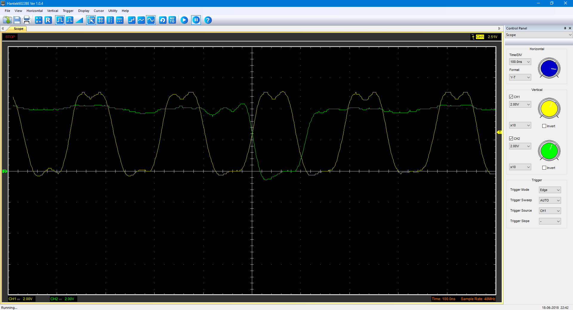

Thanks for your continued interest. So I have a cheapo PC scope, but have managed to get a 2 channel dump from it (100ns sweep, 2V per division). The screenshot is below - yellow trace is Phi2, green trace is the /CE line (active low) from my address decoding.
The output is based on a very simple loop:
loop
    lda 0
    bra loop
Before this loop starts, the machine goes through the normal boot code and then disables interrupts. So the above is the only code that runs which means there is 1 cycle where the 6502 is reading RAM, the rest of the time reading ROM. My scope has very limited memory, so I ran it machine at 1.34Mhz to get a longer trace at 1us sweep and confirm there is only 1 regular RAM access. At 100ns sweep this is the most the scope can show.
So the interesting thing here is it looks like /CE is starting to fall as Phi2 is rising - looks like no delay?!? But the fall of Phi2 and the rise of /CE seems to be in the order of 40ns to my eyes. I will dig out the decoding logic later and check where Phi2 is getting involved.
I'm out of time for a couple of days due to work, but I hope this may yield some further theories :-)
PostPosted: Tue Jun 19, 2018 2:14 am
Posts: 1002
So that's RAM /CE?
It looks very like what I was seeing whe I was having trouble.
The more important signal to compare to Phi2 is the signal going to the RAM write line (the phi2 qualified write signal (/QW)) anad also the /QW with RAM /CE.
Also, the important place to look is when Phi2 is falling (end of cycle) and both /QW and RAM /CE are rising. Ideally Phi2 will fall followed (not ny much) by /QW rising followed by RAM /CE rising. The really nasty thing with fast RAM is when RAM /CE rises before /QW.
BTW, in your Hantek software, you should have the option to save an image under the file menu.
PostPosted: Tue Jun 19, 2018 11:11 am
Posts: 660
Location: North-Germany
Please be careful: the screen shot is a nicely connected dot picture coming from 48 Msps measuring some signals around 5 MHz. Thats only 10 dots per cycle! This can be used to check whether a signal appears or not and whether its levels seemed to be correct. For timing analysis in this range you need faster equipment.
