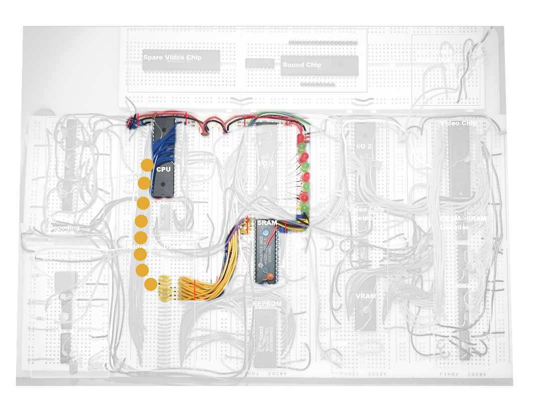

Alright, I found a photo... perhaps no longer up-to-date, but it'll serve. I see you have bypass capacitors connected directly to the chips -- which is good -- but instead I wanna talk about the connections between chips. I'll start with the data-bus connections between the RAM (which is at issue in this thread) and the CPU.
When I say connections, I'm including both the signals and their return paths. :!: The image above shows that these form a loop, with the signal wiring in yellow on the bottom and left of the loop, and the return wiring in black along the top and right. (For clarity I'll ignore the red Vcc wires, but they too act as a return path.)
The signal wiring offers little scope for improvement. It's long, and not much can be done about that. But can the return wiring be improved? Yes, and one improvement is to add a diagonal directly between the two chips. But, interestingly and counterintuitively, that's still not the ideal path -- the route the return current most wants to take. What it wants most of all is to hug the signal path, even though that's *longer* than a direct route (ie, diagonal)! :shock: So, I'd consider adding a ground wire that takes the same, long-ish route as the yellow signal path. (This new ground wire needs to be connected at both ends; otherwise it isn't a path.)
Of course the CPU and RAM aren't the only chips, and signal connections go every which way, helter skelter. All these signals paths should have prospective return paths available, but that'd result in a complete rat's nest. A ground plane would solve the problem -- because it attaches every point with every other point -- but we can't do that, either.
More practical (though much less satisfactory) than a plane is to provide a coarse grid of return connections. The idea of the grid is to help ensure that any two arbitrary points will have a return path close by. The grid needn't be perfectly orderly. But, operating on the premise that any two arbitrary points may have a signal path between them, we want a return path reasonably close by. As an example, consider C and D in the image below. I would add a horizontal path from C to D, and also extend the path to meet the columns to the left and right. I'd also put a return path from A to B. Right now there's no chip at A, but presumably there will be one in future, and it might have a signal path to B. And right now the only return path to B involves a drastic detour. I hope I've managed to write this in a way that makes some kind of sense. If there are some edits later it won't be surprising. :roll:

Wow! Very impressive! All - dolomiah's breadboard work AND Dr Jefylls analyze AND his suggestions of possible countermeasures!
If you can establish a grid like suggested it might work.
Two or three bulk caps (22...100µF) at the top/mid/bottom of each of the supply rails may assist further.

Everyone, thank you very much for the enlightenment. I have attached a bang up to date higher resolution picture as the one Dr Jefyll found is now more than 2 years old.
I have learnt some fundamental things here, and so amazed that I have somehow managed to build a fully featured microcomputer :o
Things I've learnt:
1) The 6502 is not off the bus during Phi2 low - the address bus will become valid sometime during this half of the cycle. I read the datasheet from GaBuZoMeu on the CRTC in more detail, and yes I can now see that it does need a multiplexor to allow access to memory without contention. My decoding logic has been qualifying all chip select lines with Phi2 - at the moment timing seems fine for 5.36Mhz, even though I can now see how to do this with more time for devices to respond during the second half of the cycle.
2) I had found my breadboard to have been a bit unreliable at times during the build - I did add both power and ground wires at various random places which seemed to help. I now have a better understanding of signal and return paths as outlined by Dr Jefyll, and so the reason why adding extra power and ground connections can help. I will also add some capacitors across the 5V and 0V lines - I assume this is to help smooth spikey demand current in fast switching devices.
The picture shows the full set up as it is today:
