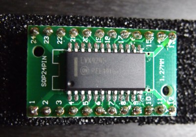

The 74LVX4245 is now about ready to mount on the breadboard. I was wondering whether it's worth mounting bypass caps directly on the carrier board, but I think I'll wait and see how it performs first.
Re: Software Transparent 6551/6850 UART Replacement

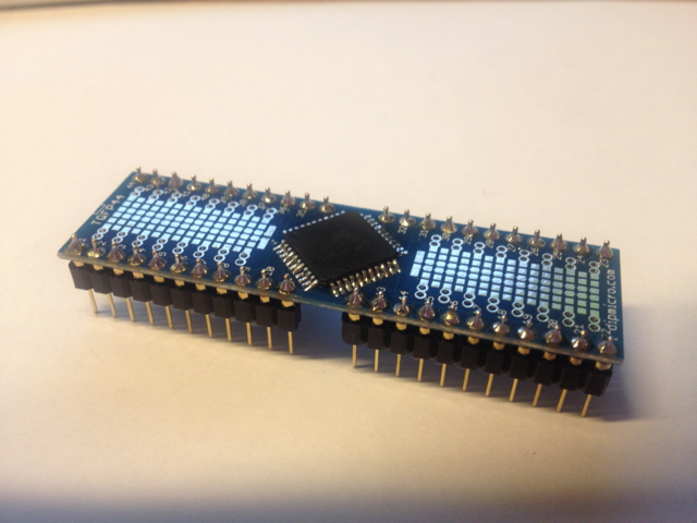

With the AVR MCUs you can calibrate the internal 8MHz oscillator and 7.37 MHz is within the possible calibration. Do the PIC not have such a feature as well? To use TQFP-44 on a breadboard I used the following adapter
The result is a DIP-48 with standard width (0.6"). I use the PCB from dipmicro.com and as pins I use machined round pins (not the square ones)
